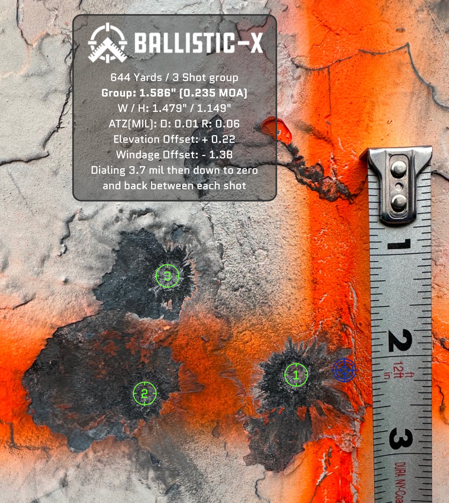

I have a Theos and am really impressed with it. It tracks incredibly well and the glass quality is phenomenal. Turrets were designed by the same guy who did Schmidt and Benders. Here is a pic of me testing the tracking yesterday. I dialed from zero up to 3.7 mils and then repeated for each shot.
Ballistic-X-Export-2023-05-22 19:59:51.101331.jpg
Tangent, Leupold Mark 5, and Minox ZP5. Had them all side by side. The Theos, with the aperture ring on, we had a hard time telling any difference between it and the Tangent. The Theos elevation turret also rivaled the Tangent. I prefer the Theos reticle over the other 3, it’s very intuitive and appropriately sized.
Reactions: 1791PrecisionArmory

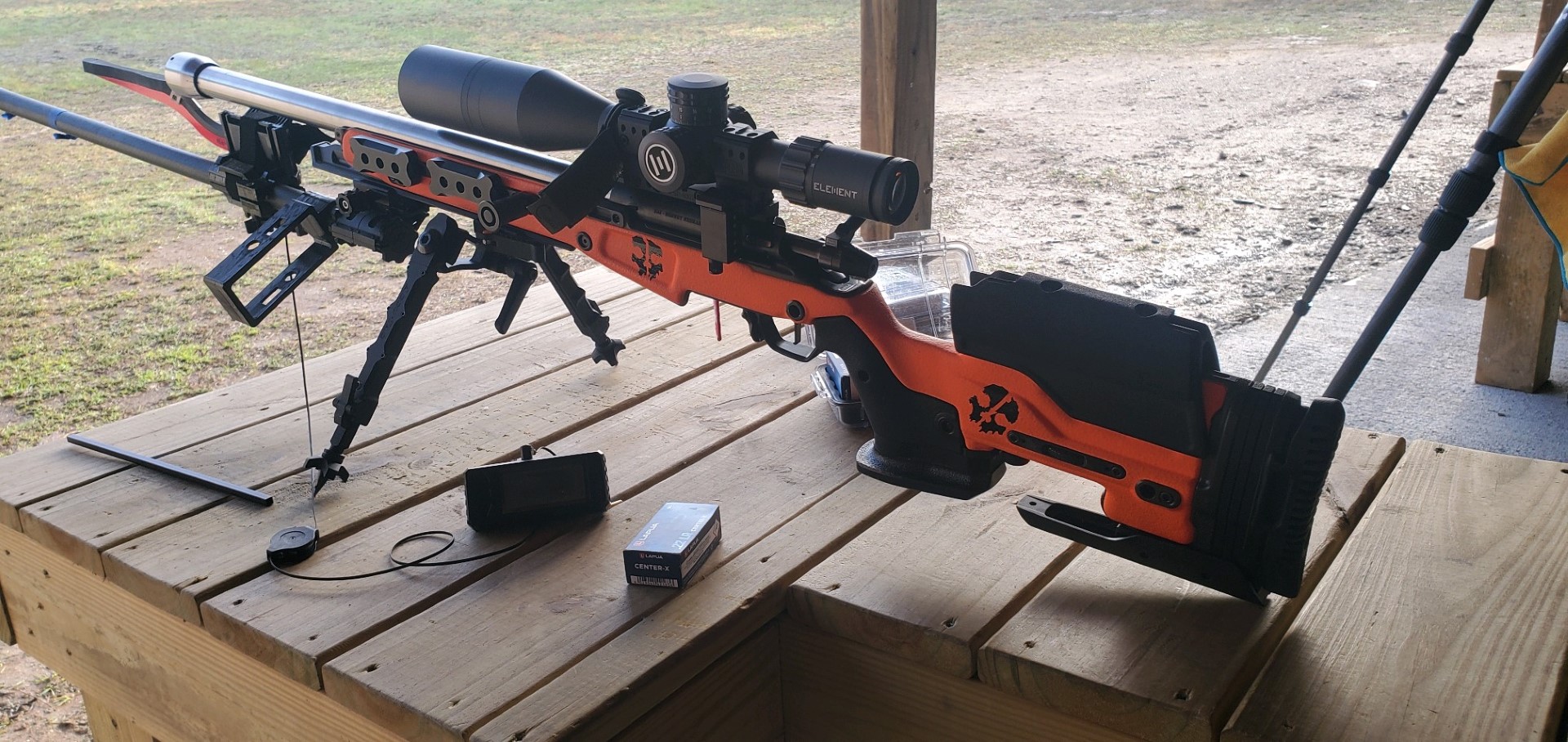

It’s been durable for me. I’ve competed with it in 3 states so far with rain, snow, or sunshine. The 36x sure is nice for shooting groups at 100 or truing data at distance. The image quality remains crisp and bright.

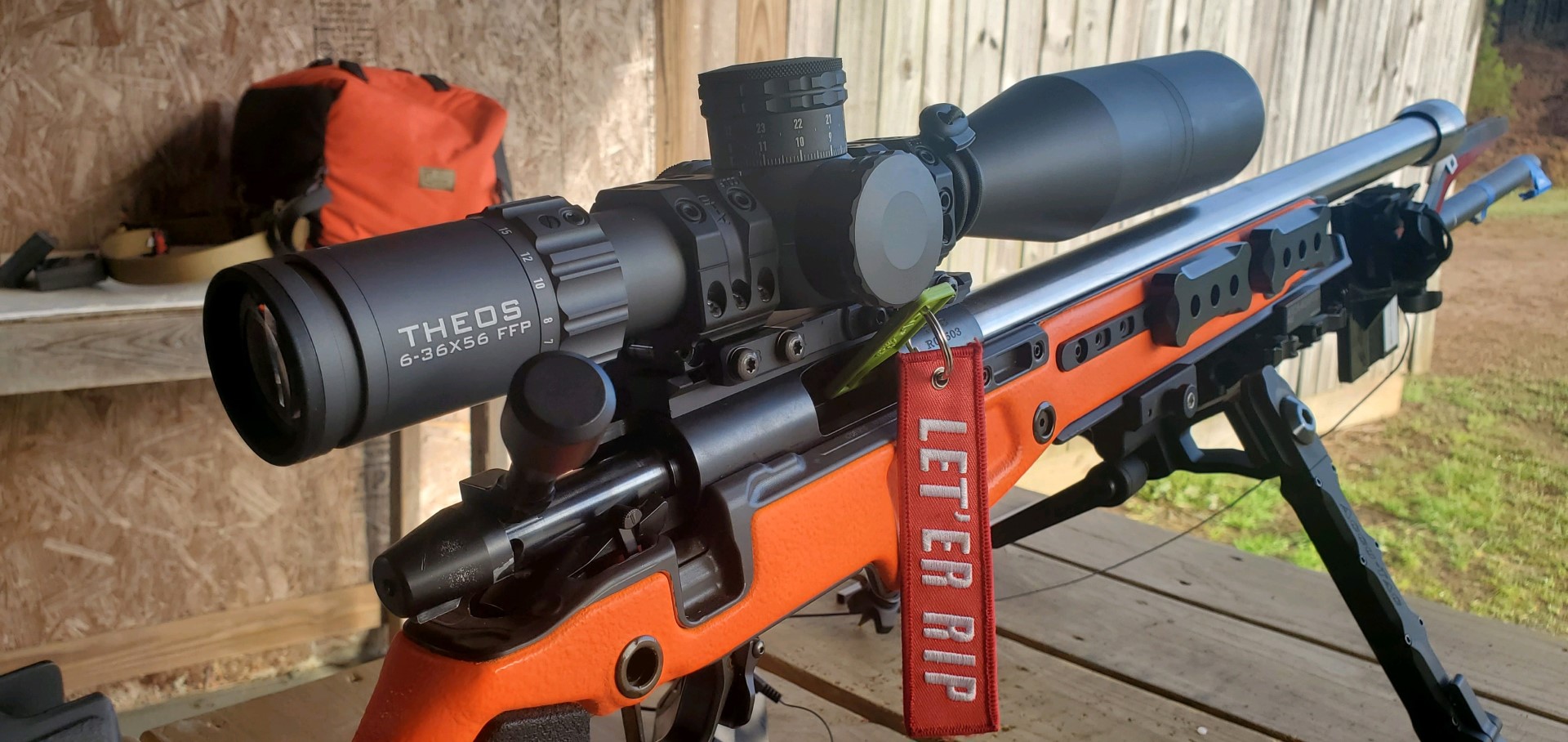

I love my Theos. I've owned TT, ZCO, Rz 2,NF, and all in between. The Theos truly holds its own with any of the fore mentioned. The glass is great, the turrets are really nice and firm. So far I have beat the crap out of it ( and dropped it and a rifle) and its held zero and still works perfect. I have had it on a 28 nosler down to a 22LR. I mainly shoot 22NRL/PRS matches at this point so it rides on my 22 but will be grabbing a few more soon for my other rifles. I've not had any buyers remorse with the Theos as I have had with other.
