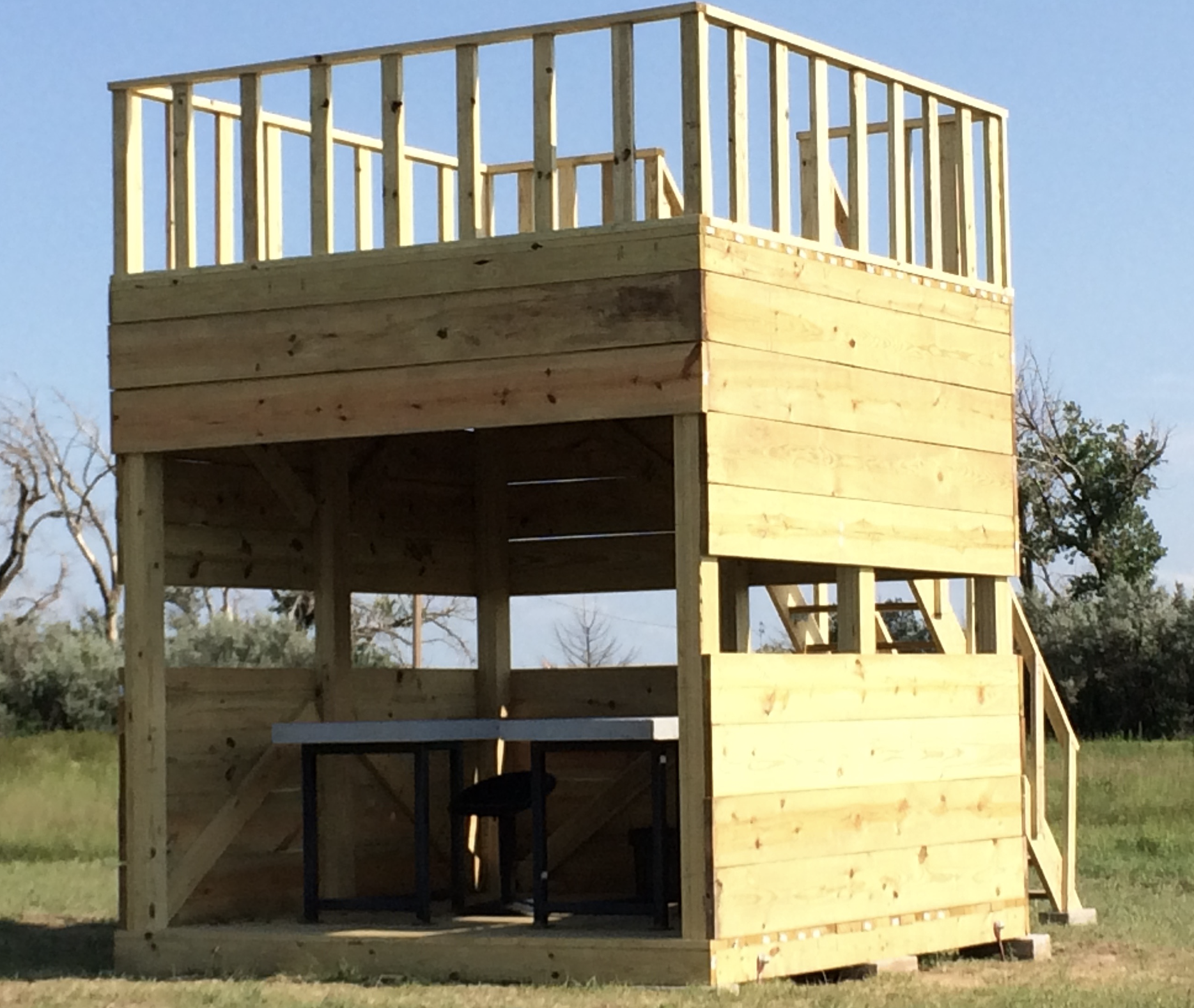

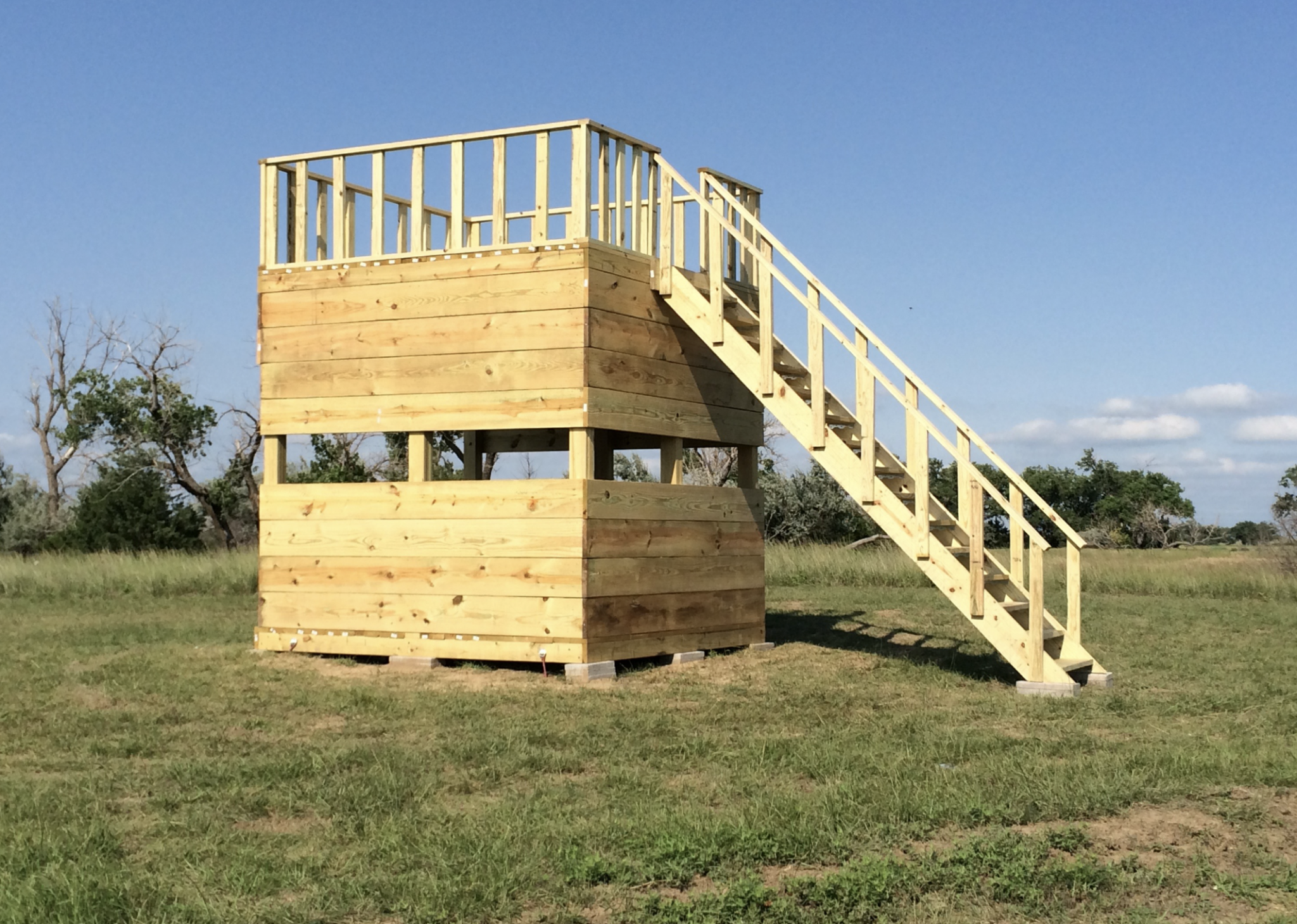

Sounds like you just need a shorter version of what we did here: https://www.snipershide.com/shooting/threads/elevated-shooting-platform.6893843/#post-7130517
Shipping containers are a great idea, but not exactly common in the midwest. Other ideas include finding an old gravity wagon removing the running gear, filling it full of gravel or rocks, and building a platform on top of that.
Looks great! Anything you would do different if you were to do it again? how deep did you burry your 6x6 supports?
Yeah, a few things...
I would have built the shelf right away instead of as an afterthought. That way we could have designed the roof to fully cover it.
I also would have built a staircase for it right away. We still don't have one, and now with lumber price retardation, it's probably going to keep getting pushed out.
Like a pole barn or a deck, you just need your 6x6s below the frost line. Ours are 5' in the ground. We need that up here in SD. Additional stability can be achieved with a wider hole and more concrete.

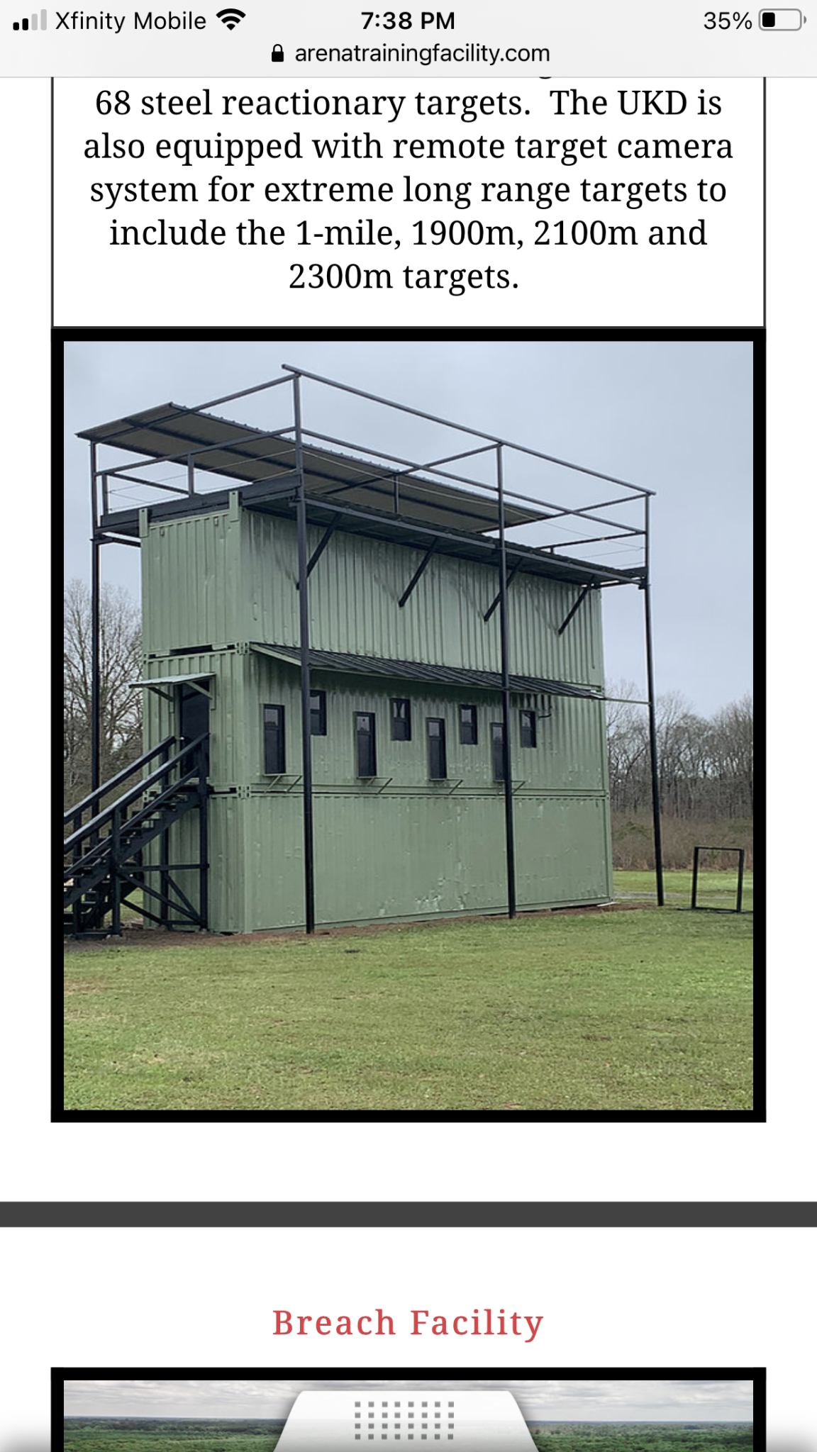

You dont happen to have a picture of their set up do ya?
This is looking from down range back toward the structure. The upper conex has holes in the wall you can shoot from and is open on both ends to act as a bridge between the two decks. I think they have added more holes in the wall now. You can kind of see how the upper decks are wider than the conex. Also note how the railing doesn't go all the way down to allow for prone shots. The stairs have also been redone and are a lot nicer now. The second range is the same as this, but they only have one upper deck at this point and the bridge is only open at one end. They just built it over the winter so I'm sure they will add a second deck in the future.
I'll see if I can find some other pictures.
