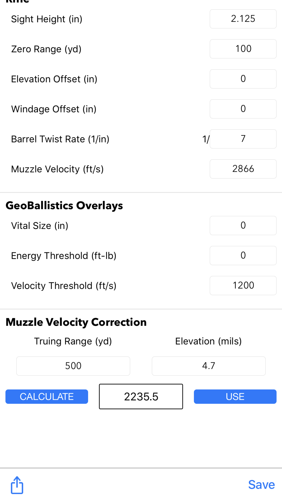

so you measure in the scope how high you were hitting:
ex: you dialed 5 mils and POA was center plate. but impact was 6-8" high. measure how high in MILS that is. let's say you get .3 high.
so now you know you only needed 4.7 mils to hit center of the plate. most ballistic apps (i use ballisticARC) you can plug this into the app and it will tell you your velocity. enter that new velocity and you should be good to go
This is a half assed example cuz I made up numbers but still used my velocity for my gun.
But you can see where you input yardage, and actual dope and it spits out a correct muzzle velocity.
