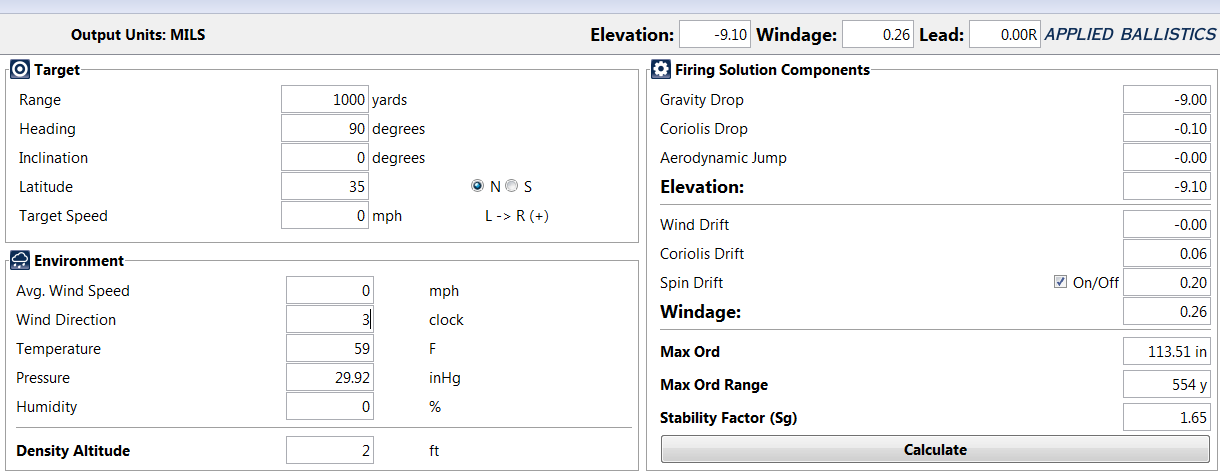

    Here is what the Kestrel is doing when you have all the "forces" turned on. These are screen shots from AB Analytics which is the same engine as the kestrel but it breaks down the components that make up your hold. I used my data for one of my 6.5's and a worst case scenario of a due east DOF (max coriolis) at 35 degrees N Latitude (Im in Raleigh).
    here is the solution at no wind (even in no wind, it says you have to correct for coriolis in the elevation, but no AJ):

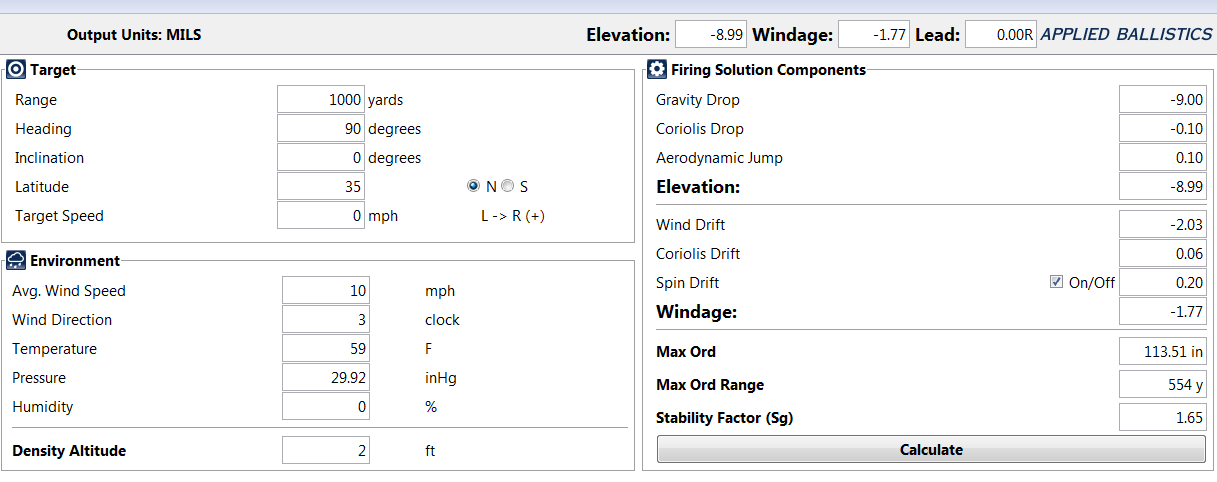

    Here it is with a 10 mph 3 o'clock wind (notice the change to elevation):

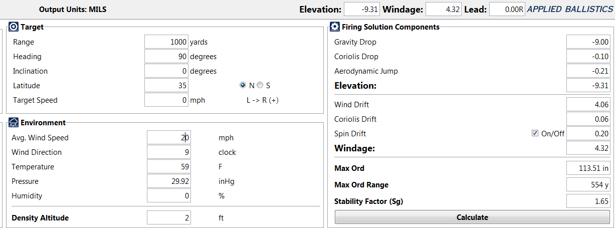

    here it is at 20mph:

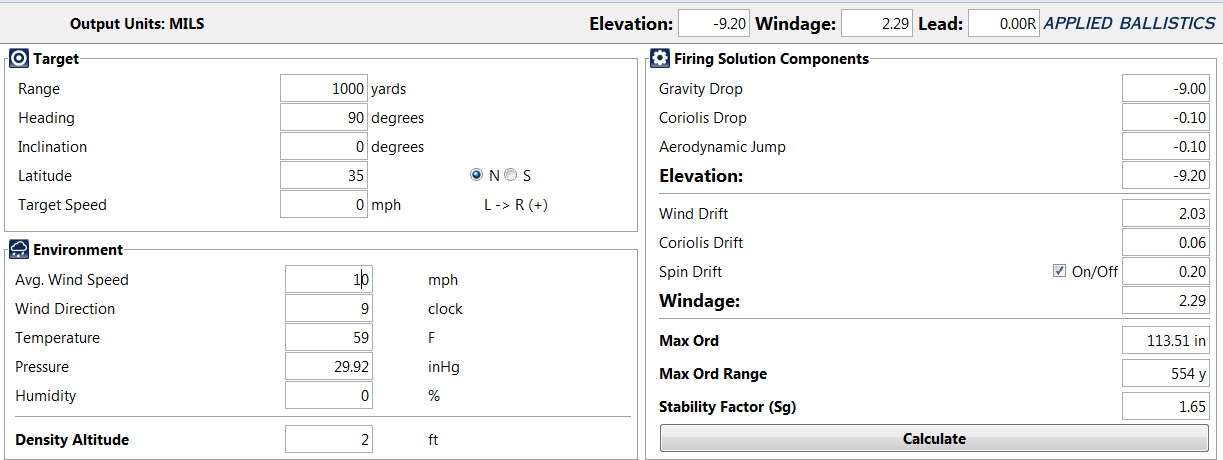

    Now here is the same 3 with a 9 o'clock wind (notice the differences):

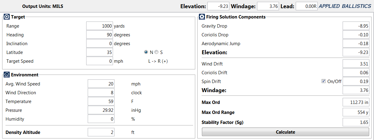

    Just for giggles, here is a 8 o'clock 20 mph wind
