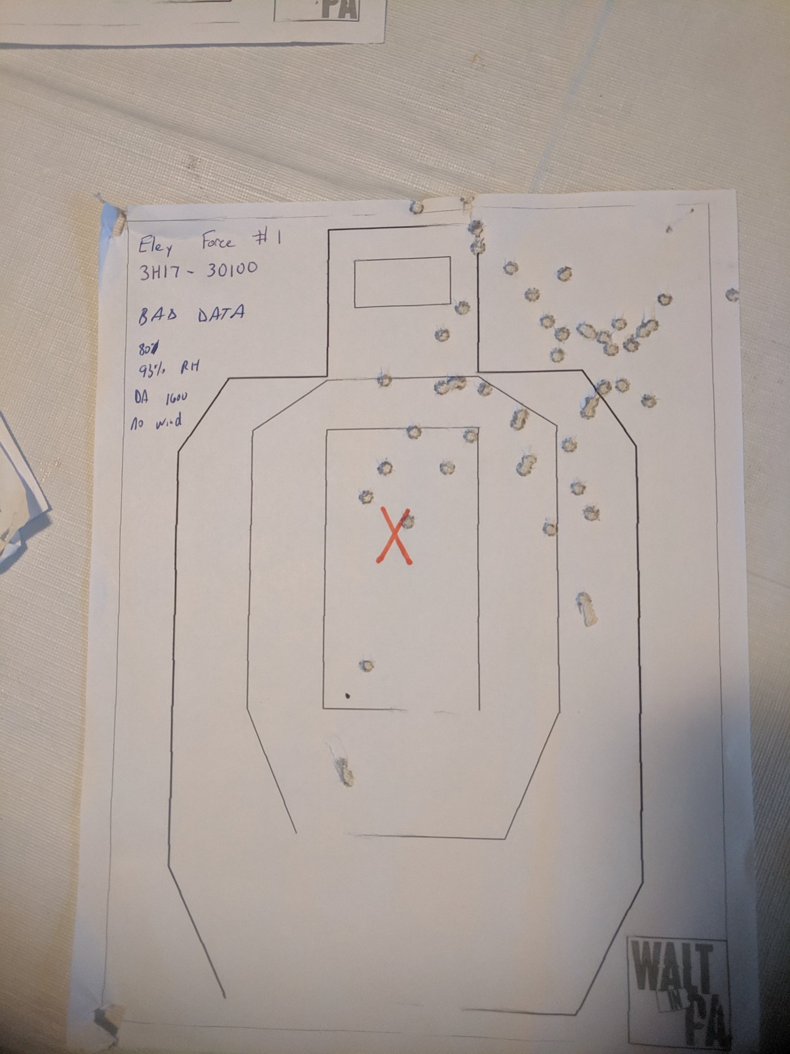

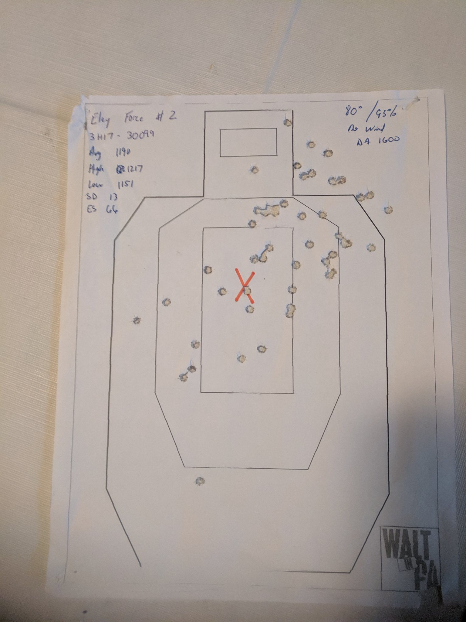

i've used it for about a year and half competing in nrl22 style matches. i've also contributed to the 50 at 200 thread with it as well. @justin amateur is right on, mine groups just about the same. i get an ES that is a little high for my liking but i'm willing to trade that off for the velocity and 42gr bullet in the wind with the size of the targets we shoot at 200 and 300 yards.
its going to boil down to whether or not your rifle likes it was well. it could should great in mine and crappy in yours.
My 10/22 loves the stuff. My bolt action, not so much. It shoots really well at 50 but once you go beyond that the groups opened up. I was getting 1 1/2” groups with it at 100. Most of the quality subsonic ammo I shoot gives me sub MOA at 100 yards out of my Tikka.
