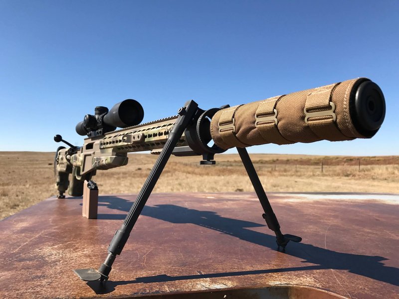

We have a ton of them in our Classes in Alaska as my partner Marc up there sells them, honestly they make life so easy.
For the PRS guys they want small and fast, but if you want stability and accuracy the Elite Iron Revolution Bipod is pretty awesome.
I just got the new Swivel version to Demo, but have been shooting the original for a while and it's great.
14691951_10154608246287953_2224783914129489384_o.jpg?oh=5773f5e773adc0202a5cb81e3f7b7ca8&oe=59...jpg
I have one on a DT HTI . 375 CT. I like it quite a bit. My only concern is when shooting uphill or at extreme ranges and deploying the leg extensions it doesn't feel quite as stable as when the legs are not extended. I really like my LRA light tactical on My SRS a1 and would love to try the LRA F-Class on the HTI. The LRA's aren't as "tactical" -being wider under the forearm- as some other models but are extremely sturdy. As for the EI- it is incredibly well built, and Dale @ EI is a fantastic guy.
