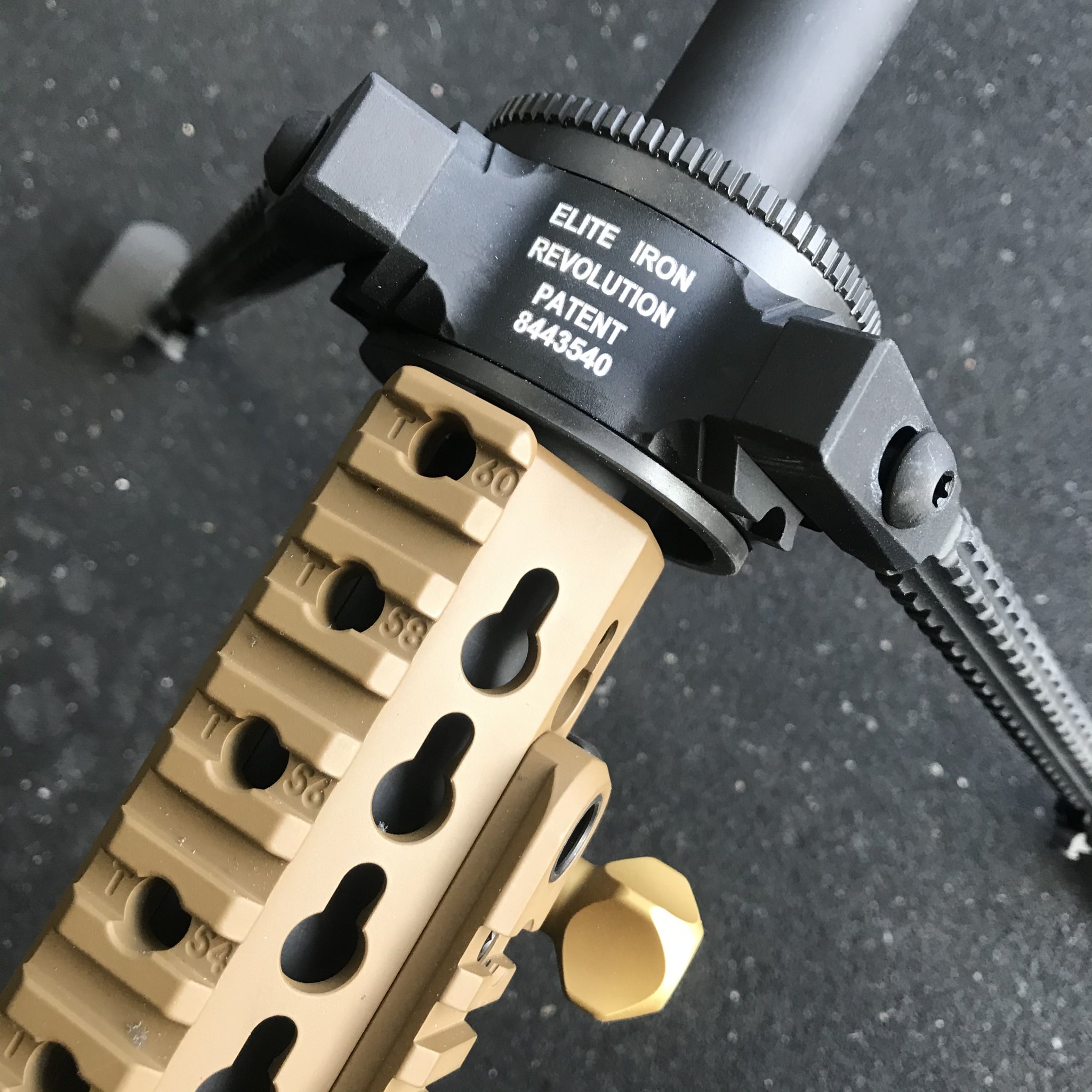

Elite Iron revolution Arca mount

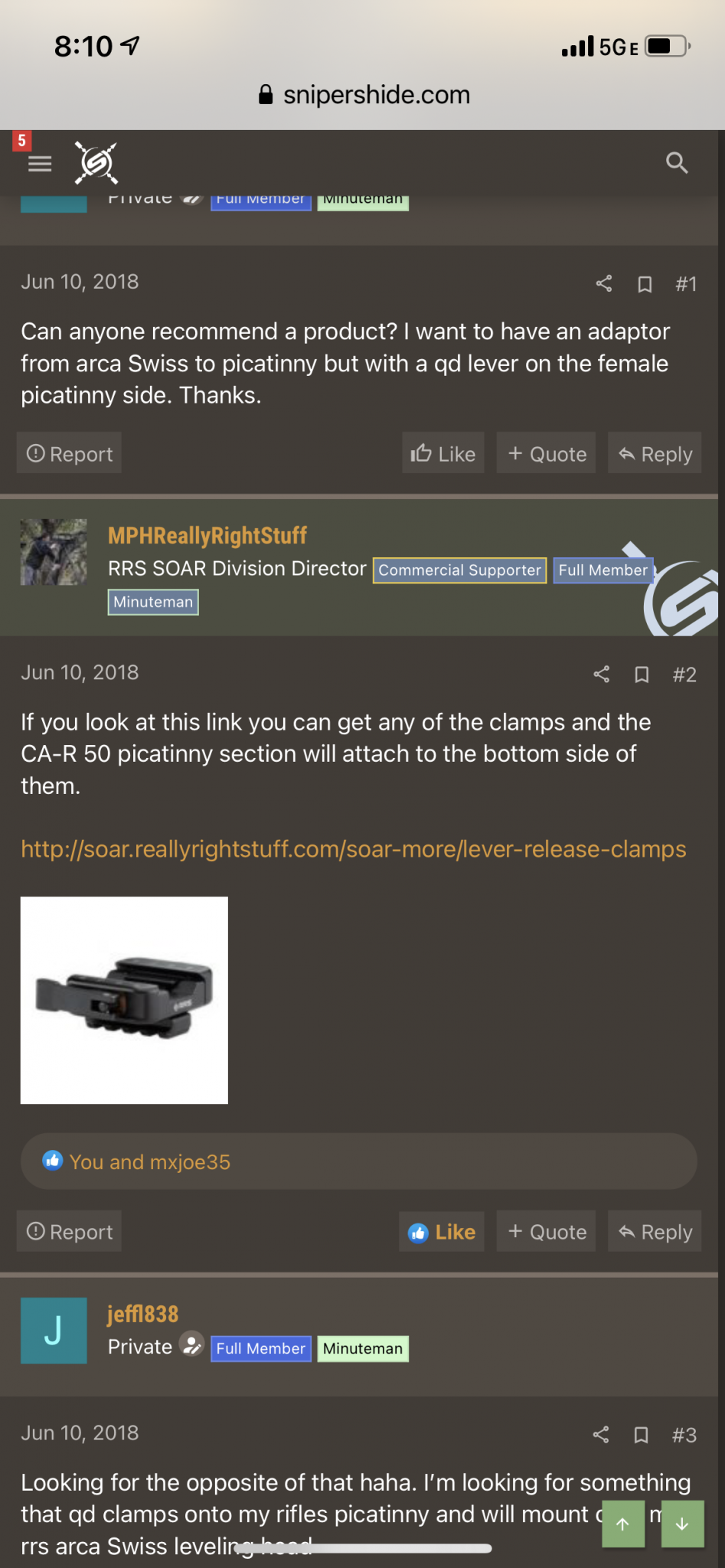

Best I could find is something like Area 419 who makes a piece of pic rail that attaches to their ARCA clamp. ARCA to the gun, pic to the bipod.
My only hesitation is not knowing how thick it is and hence the distance from clamp to barrel that EI needs for determining which adapter to use.
Why they do not make an ARCA native adapter is beyond my understanding.

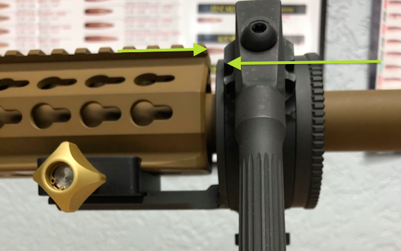

I would assume you would take measurements just like below but with your Dovetail mount on the forend, and hit him up via email. Give him actual measurements, not just standard, medium, high etc

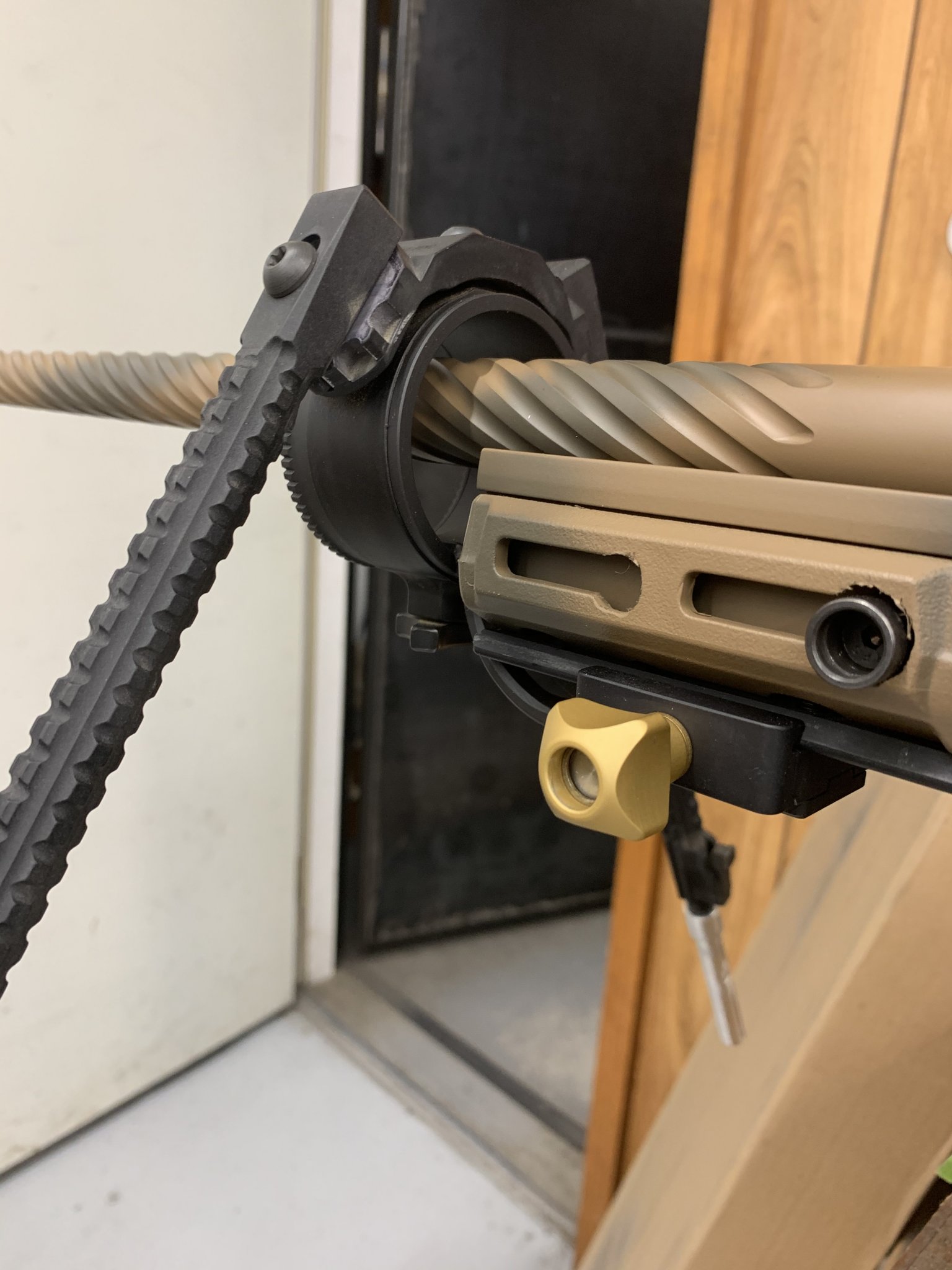

Absolutely. And the Area 419 clamp also accommodates a short length of pic rail in an identical manner.
but I would rather not have adapter on adapter and it increases the height that the mount needs to accommodate.
To my mind (rotting cesspool that it is), the mount that bolts direct to ARCA clamp is the way to go if he’s selling them.
1) cannot slide the Bipod back over the handguard
Ah, no...but why would you want to? I have JAE chassis and the ARCA rail extends 2" past the end of the fore arm and that's where I want my bipod so for me, at least, I don't see the issue.
cannot quick detach the bipod
Ah...why not. Yes, since its an EI with a ring circling the barrel, it has to go forward over the end of the muzzle to come off entirely, but as far as quick release (versus pic rail bolts), just loosen the 419 ARCA clamp and slide it off. But no, you can't just drop if off the rail....but that's endemic to all EI bipods (which all use this ring mount) and not something related to an ARCA mount implementation that we have been talking about.
3) likely to slide when loose
Well, yeah...."when loose" So, don't loosen it. I have a BT CAL on my gun now with an Area 419 ARCA clamp (without the 419 ARCA Lock pins...just a plain dovetail clamp) and it has never come lose on its own. Not even close. I imagine that RRS clamp is the same or better so I don't see this as an issue, based on my experience.

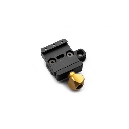

I spoke with Dale from Elite Iron today and they do indeed now offer mounts with hole pattern to allow an ARCA clamp to be attached. Think Area 419 or RRS clamps....same hole pattern as provided by BT on their Atlas bipods (is this standard sort of???....I know that not all ARCA clamps come with this two hole pattern??).
Dale said it was not up on their website yet as that site is being overhauled but if you call them, they can help you out.

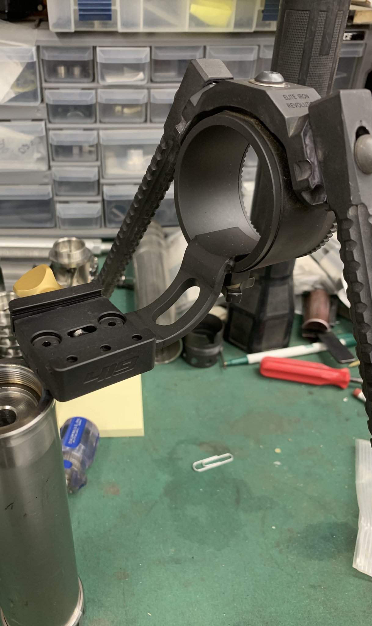

A standard hole pattern now seems to be called "arms 17s", originally from early ARMSs mounts, then popularized by Atlas, then picked up by RRS, area 419 and others. If Elite Iron is now using this as well, with "arms 17s" hole pattern, you can run and clamp you like, eg PIC 1913 rail like ADM QR, or RRS/ARCA clamp either by RRS or area 419 etc.... provided there is clearnce of course...but it doesn't lock you into a single attachment in case one is ultimately preferred or your needs change over life of the product...so thats a smart move by Elite Iron IMHO if true. (y)
I recently received an Elite Iron bipod with an ARCA mount. And yes, it comes with ARMS 17s hole pattern and I just screwed a 419 clamp on it.
Just take the same measurements you would for a pic mount and call them to order as they still don't show it on their website.
Its easy peasy but it may take 3-4 weeks if you need a custom mount (and I did with a JAE chassis...they just didn't have in stock anything tall enough for JAE with M24 barrel)
EI was fine to deal with...it seems like they are perhaps a smaller outfit....but very friendly, answered all of my questions, and the device arrived and works perfectly.
So, if you want an EI bipod on an ARCA, take your simple measurements and give them a call.

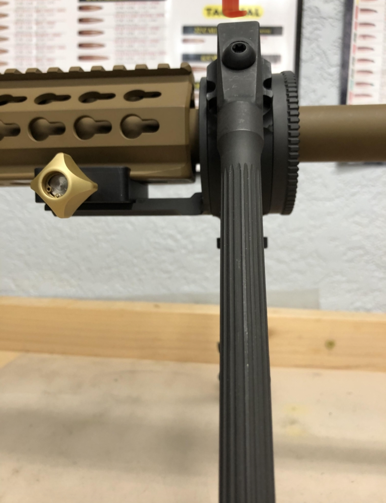

Baron, how would you describe the cant of this bipod? I have an Atlas CAL Gen2 with the cant and lock lever so the cant is adjustable. I gather the EI has a screw that will adjust this but I wondered if it's responsive such that you can adjust the cant to be stiff without being completely locked out. I wouldn't plan on leaving the cant adjustment loose at all, would rather have it requiring a bit of force in order to cant left or right. Appreciative for your take.
I own an EI, LRA, and a couple of Atlases. The EI has by far the best cant control. You can absolutely lock it off completely and it also has fantastic fine control. Cant control: EI > LRA > Atlas.

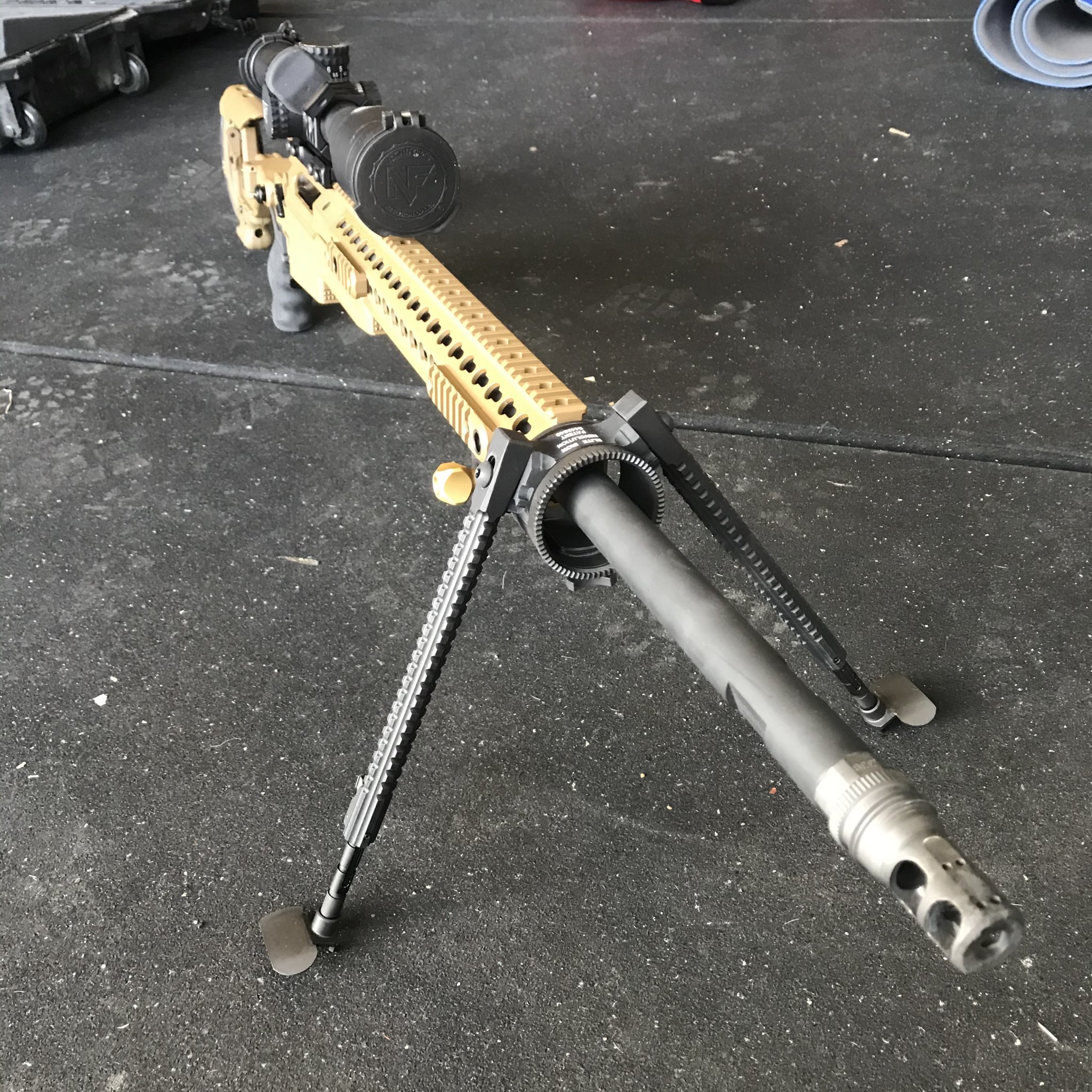

I should note a few things about the EI that it would've been good to know about before I bought it. Know that I am not a prone shooter. I shoot prairie dogs from a bench and shoot at the range.
  • The pic rail version is quite slow to mount/dismount. Using hex keys was a bigger hassle than I thought it would be. I think the owner of EI expects it to be semi-permanently mounted, as a segment of his clientele seems to be military.
  • RE: semi-perm mounted…The panning version, which I have, is quite the crazy-legs contraption when left on the gun. It has no panning lockoff, so when folded up it spins around the barrel and twists. If you lock off the spinning it still twists. Thus, it will scratch the ever-living shit out of whatever is under the feet. I use a red pool noodle over the barrel to protect it when in transit, which makes me very gay.
    • I am unsure how the fixed version would be in this regard. The (awesome) feet are sorta duck-shaped and large-ish, which is good for all sorts of surfaces. But with the springiness of the legs and depending on the clearance, I could see some scratching to a fat suppressor, but nowhere near the level of the panner. This whole scratching thing is either retarded to consider or important, it's all up to you.
  • The legs are made so you only have to pull them to lengthen, and push a lever to retract. When you pull the gun out of the case with the bipod attached, inevitably the legs catch and extend (see "duck feet"). This can happen when you are carrying the rifle around, too. People in a hurry probably like this feature.
  • The aluminum version has semi-aggressive nubs lining the legs. If I order a fixed version, I would get the steel one as it has smooth legs and now I am a pussy.
So, if I had to do it over, I think I'd go fixed, arca, steel. YMMV.

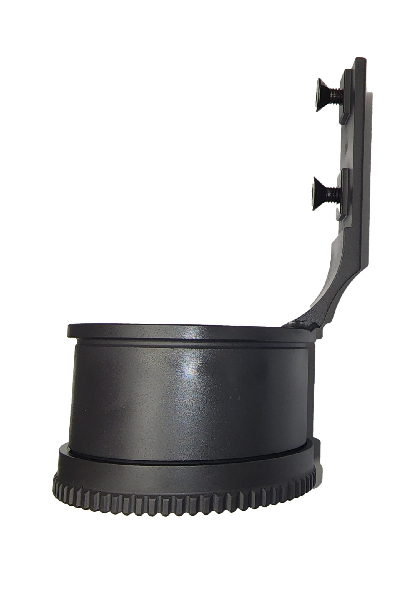

You can't get it without any clamp and just put an RRS or Area 419 (or any other you like) QD pic clamp on it. The clamp they send with it...its welded onto the mount???
They do say: "Elite Iron offers the ARCA mount compatible with the 419 or RRS clamps. (Clamp not included.)" but no mention of diff pic clamp?????
I would bet that if asked they would make you a mount with the ARMS 17S hole pattern and just put the clamp of your choice on it. I have the RRS PIC/ARCA clamp (SC-ARC they call it, I think??)
The regular pic clamp on mine is pictured below on the three right loose mounts on the table. It is indeed welded onto the inner circle assembly.
The Arca mount wasn't on there last time I checked, but it's there today. It has that standard 17s interface…I suppose there's other pic mounts like the ADM one would fit that too.

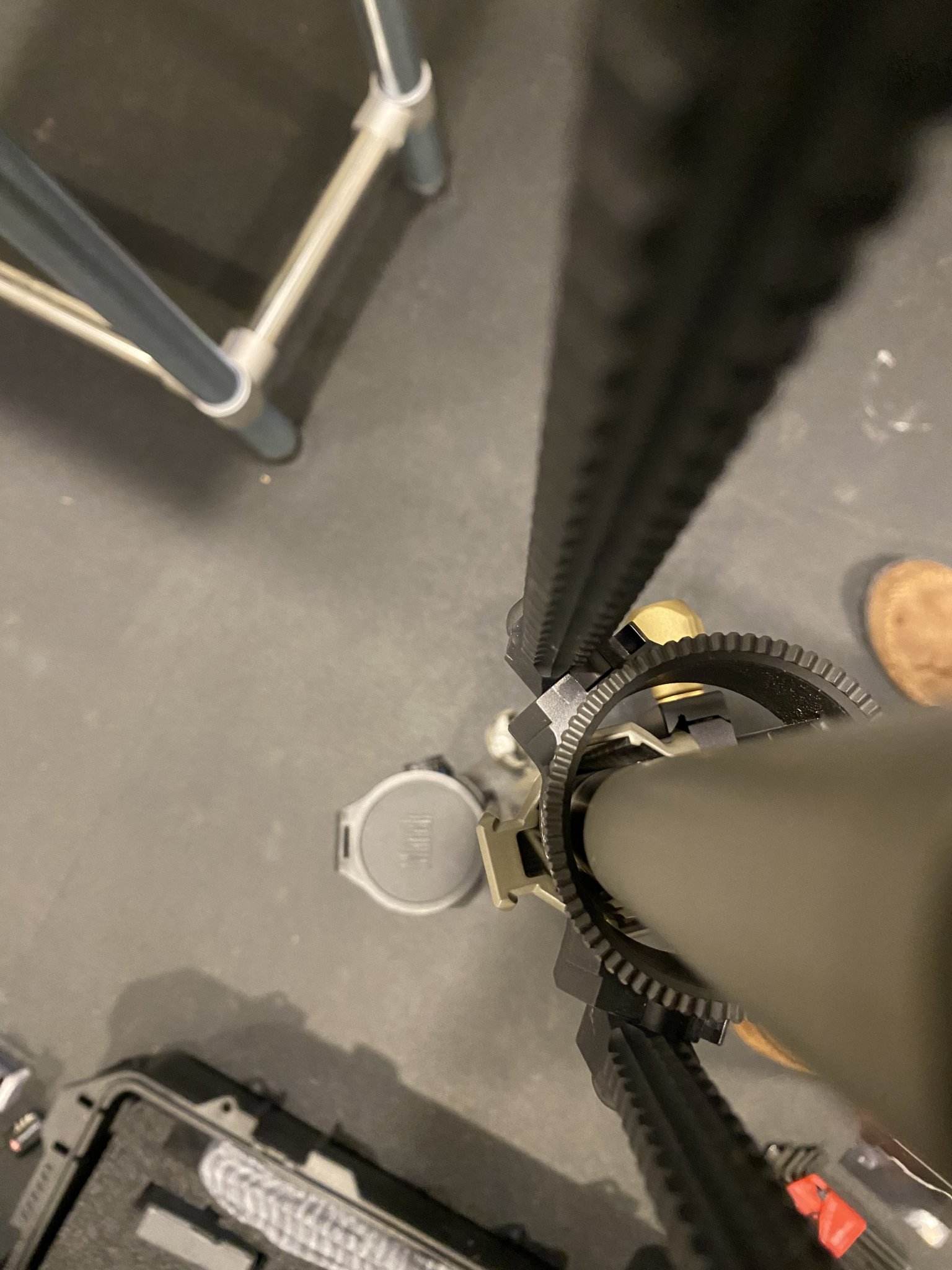

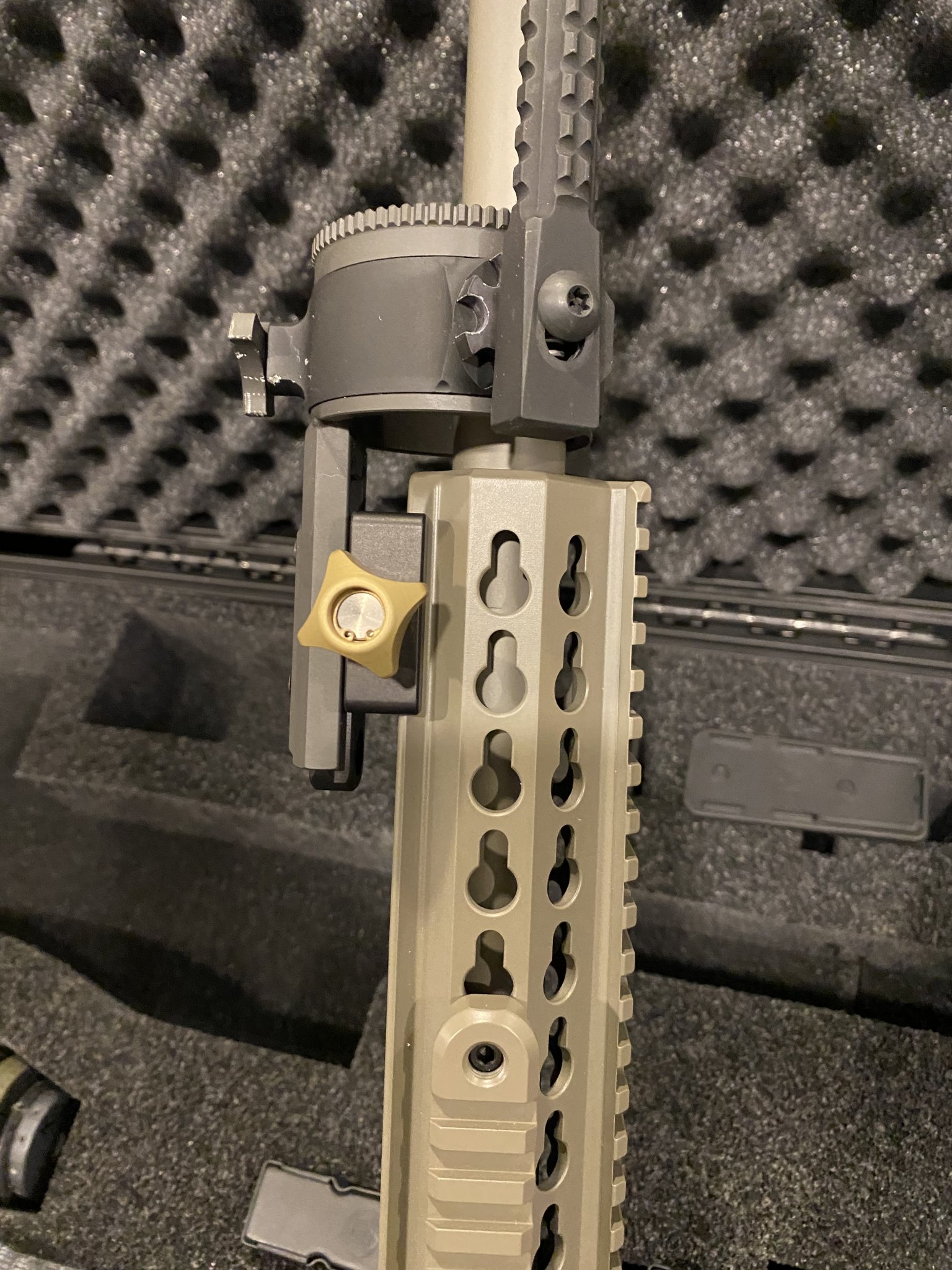

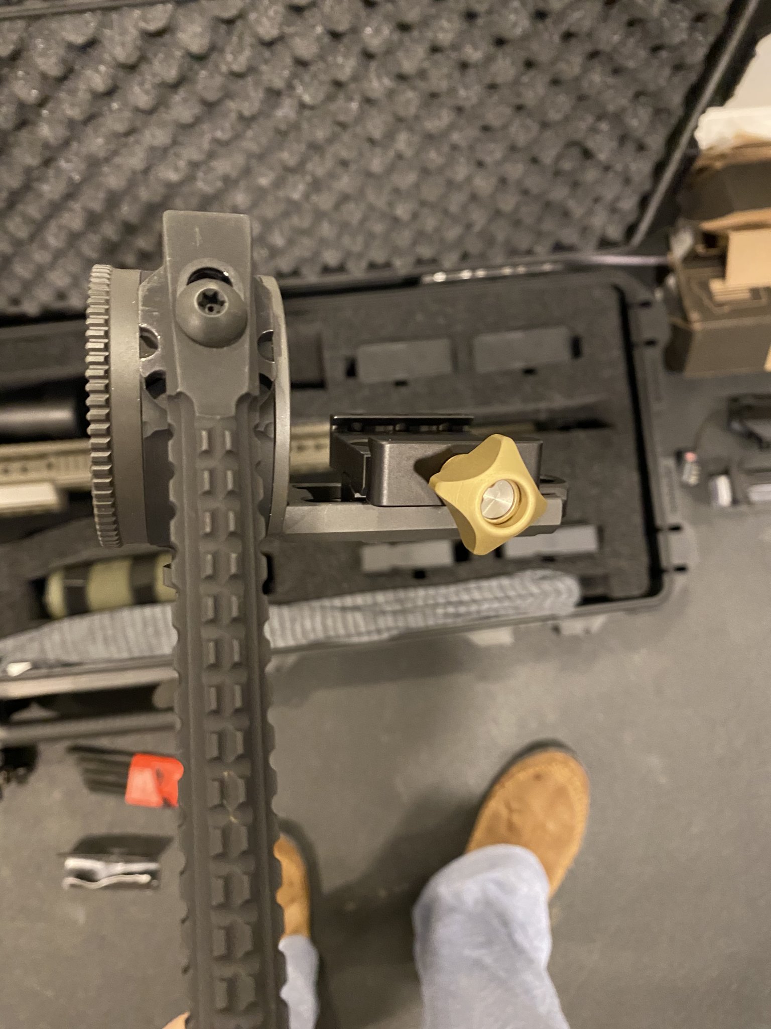

I fixated on this and connected the area 419 arca clamp and pic rail attachment to the rail on my axsr (having removed the pic rail that was already there) to gain QD functionality. I think this “works” but obviously it may have been even better if I had a bigger EI ring as the clearance is a tad tight. Gonna also post this (or link to this if I can figure out how) in the axsr elite iron chain too
