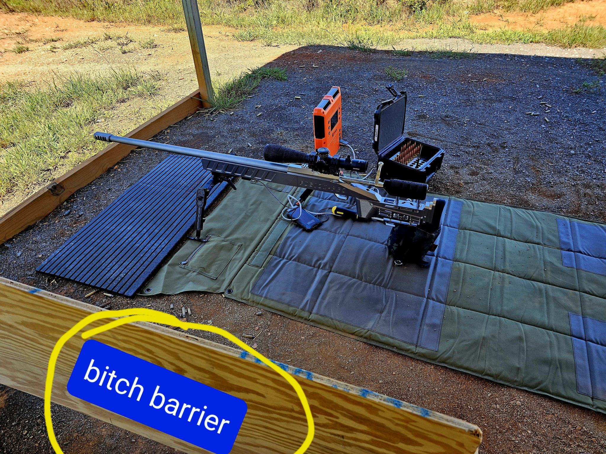

Here comes the solution. Place boards or a wall between the shooters. This way you won't get the muzzle blast in your face when a 50cal shooter is next to you.
