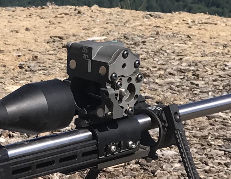

    Like steelhead showed, it’s a couple of mirrors on the Charlie and an actual prism from nightforce. It bends the light or offsets it to give you more elevation. With a 20 moa rail and Burris rings with the inserts, you should be able to get just about all the elevation out of most any scope. That’s what I use to get all that the ATACR has
