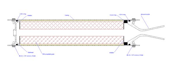

For my first linear characteristic element, I will attempt to show how a solid rocket motor is analogous to an ELRC.
In a solid rocket motor you have three parts:
1. Ignition Bulk Head (farthest left end of the picture below.)
2. Fuel Grain
3. Nozzle
ELRCs have the same general layout and principal model of operation as that of a high power solid rocket motor.
Let’s look at the point of ignition.
On both the motor and ELRC, the point of ignition is opposite the nozzle end.
Rocket motor: The reason for ignition at the top of the motor is due to the considerably faster rate at which the propellant grain is fully ignited. This is because the high pressure/high temperature gases are only able to escape through the nozzle of the motor, therefore, the flame channel burns downwards, not upwards.
ELRC: The point of ignition located in the rearward most end is due to simplicity of adaptation. However, later I will explain why this characteristic is so important to future ELRC development.

Rocket Motor: The propellant grain is the fuel that is consumed in the combustion process to produce the high-pressure gases that propel the rocket upward. The fuel burns slowly and typical KNO3 motors maintain a pressure of around 3000 PSI in the motor. To successfully make a rocket fuel burn and hold a set pressure, you have to regulate the surface area of the burning grain. As you can imagine, there is no way to “throttle” a burning hunk of propellant because it is made with both the fuel and oxidizer in it. They will burn underwater, or in space. Therefore, since there is no effective way of controlling how much of the grain is burning, we have to get a little more creative. As a rocket fuel grain burns, it is also eroding and flowing out into the atmosphere. Most high power rocket motors use a Bates style fuel grain. This is a tube made of fuel with very thick walls. It will burn on the top face, bottom face, and on the inner diameter of the grain. As the grain burns, the inner diameter grows. This increases the surface area. However, while the inner diameter is eroding and gaining surface area, the top and bottom are also eroding. This shortens the overall length of the grain; reducing the length of the inner diameter. This makes the grain burn a constant surface area, thereby keeping the internal motor pressure stable, and the thrust curve is therefore more linear.
ELRC: The powder is burnt in an elliptical wave front that moves down the length of the cartridge. Not all of the powder is burnt in the cartridge however. Because the wave is creating pressure at the rear of the cartridge, this pushes the remaining powder against the projectile and pushes it out of the cartridge. As the wave front pushes the powder and projectile down the barrel, the powder is consumed. Because the powder is burning in a single wave plane, the surface area remains constant with the exception of the change of the diameter from body to bore.
Let’s look at the nozzle/neck:
Rocket motors and ELRC’s have a divergent cone shape that plays a significant role in performance.
Rocket Motors: The high-pressure gases produced by the consumption of the propellant create a subsonic flow toward the exit/nozzle. When the gases reach the nozzle, they are accelerated by the convergence of the nozzle. The gas velocity reaches several Mach numbers in the smallest area of the convergent section. As the gases exit the convergent section, they expand to many times their original volume in the divergent section of the nozzle as they are released to atmospheric pressures. It is this expansion in the divergent section of the nozzle that produces the vast majority of the thrust on the rocket.
ELRC: The cartridge has a cylindrical area known as the body, followed by a convergent section known as the neck. The neck angle plays a large role in the efficient burning of the powder. I will explain this more later.

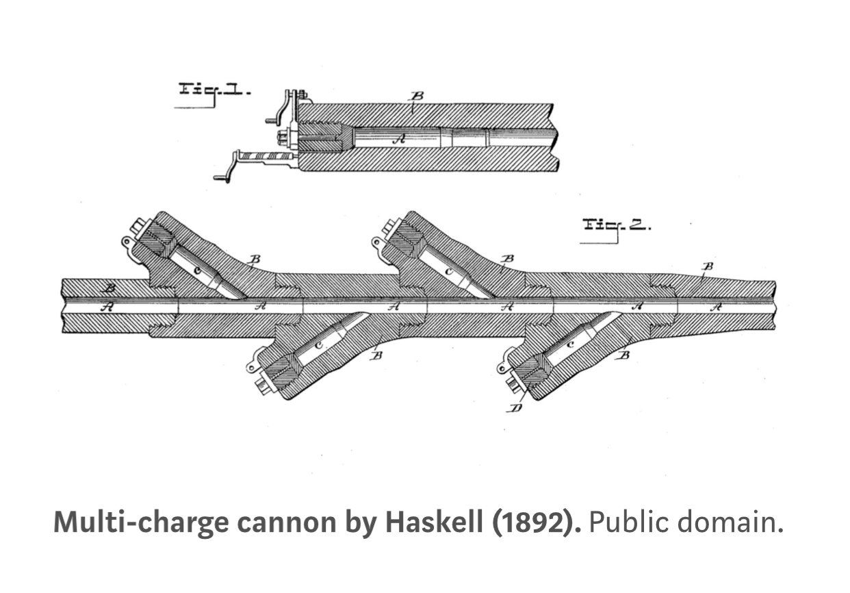

I think you’re referring to something like this:
https://howwegettonext.com/space-guns-fa2dda0561ec
You can see this idea has been around a while. I think this has been attempted in the not so distant past by countries trying to develop space guns, really just super long range heavy artillery. A interesting concept but I think it would be very hard to regulate powder ignition, burn rate, etc., especially on small caliber weapons.
Mike
Mike
Very impressive, and invented in the 1890’s! Was not aware, thanks for finding it Mike.
Wonder if modern high speed electronics can do a better job at accurately timing the sequential ignition of the cartridges....
Btw: The way that liquid fuel is injected in tiny but accurately metered quantities in a direct injection (stratified injection) via piezoelectric transducers might one make a liquid powered canon a real possibility...
