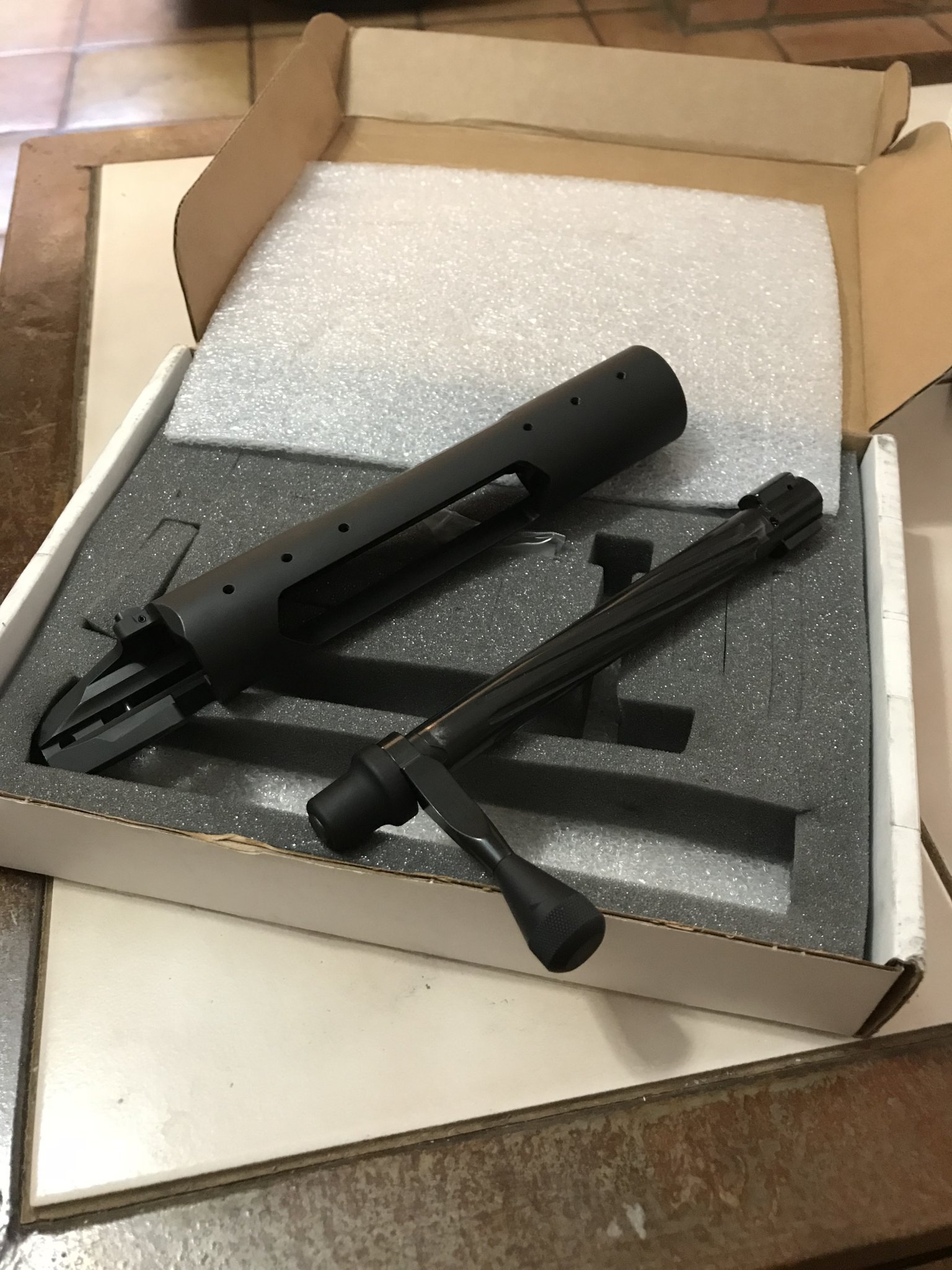

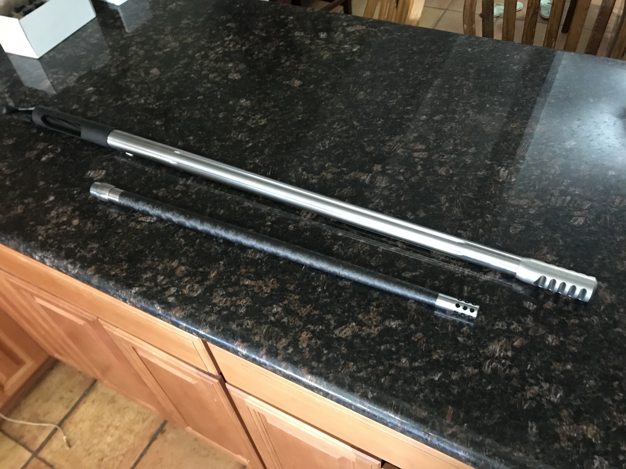

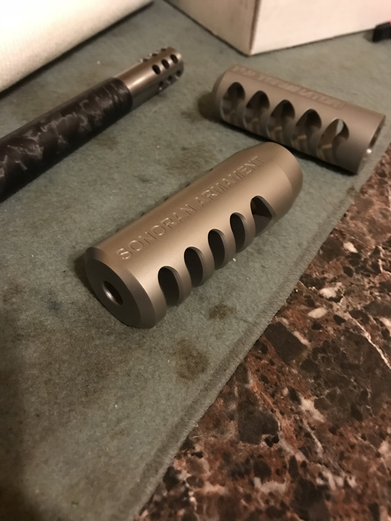

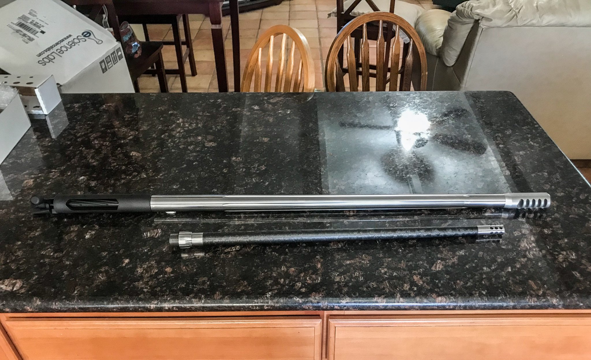

Well things started showing up way sooner than expected! The barrel is in and McMillan just emailed me saying my stock is done. I also designed and had a custom muzzle brake made to use instead of the t4+

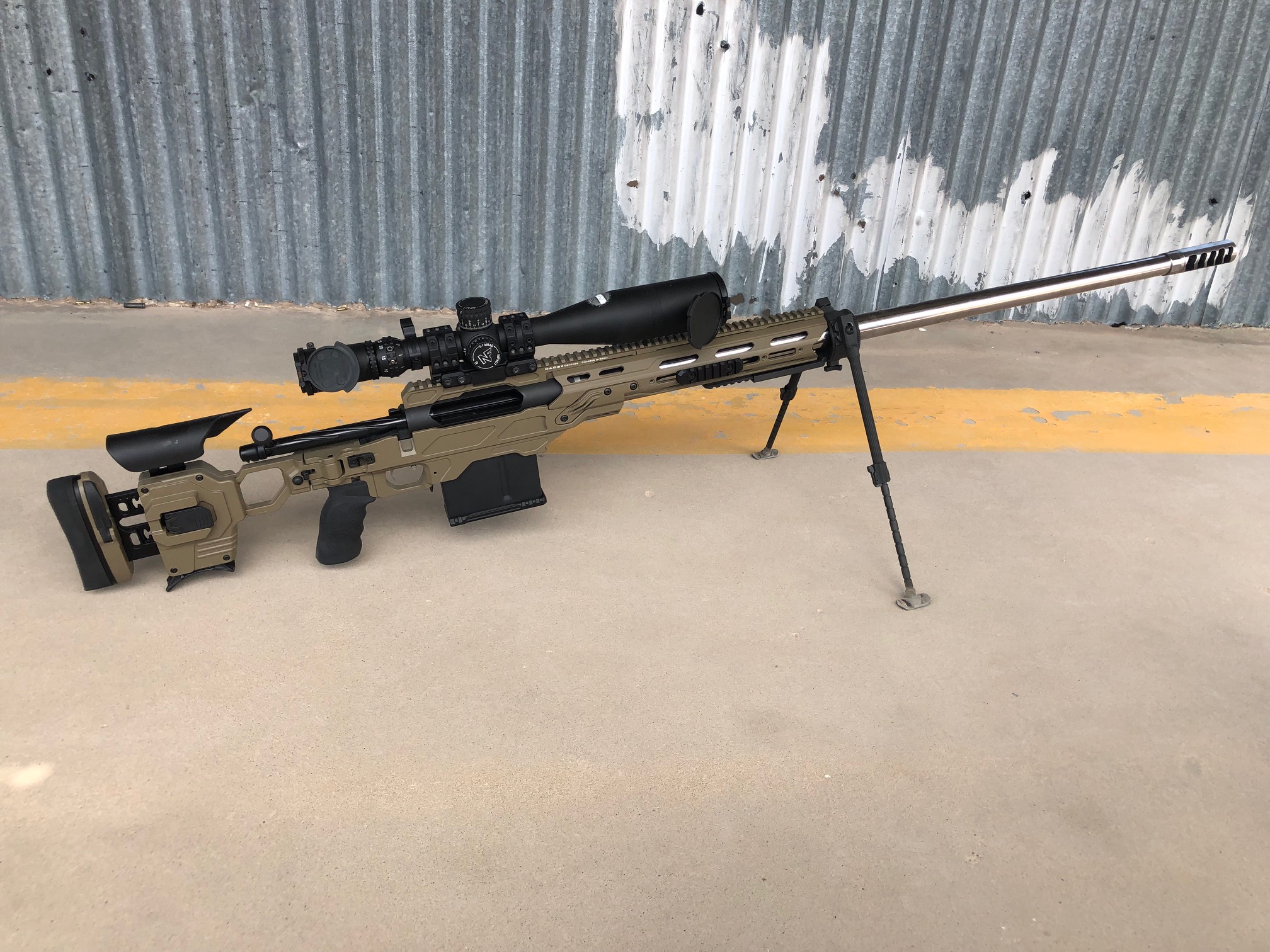

375 cheytac is on it's way. Anyone have any further updates on loads. Particularly using the 350g lasers and N570 or Retumbo in a 1-8" twist 29" Proof Research barrel? Is N570 too slow for the 350's. Really want to make N570 work since it's more available than retumbo lately.
Gun is being made by Brian at Shootlong.com.
XLR chassis
7x35 nightforce scope
Peterson brass. Fed 215 primers
Applied Ballistics Dies
