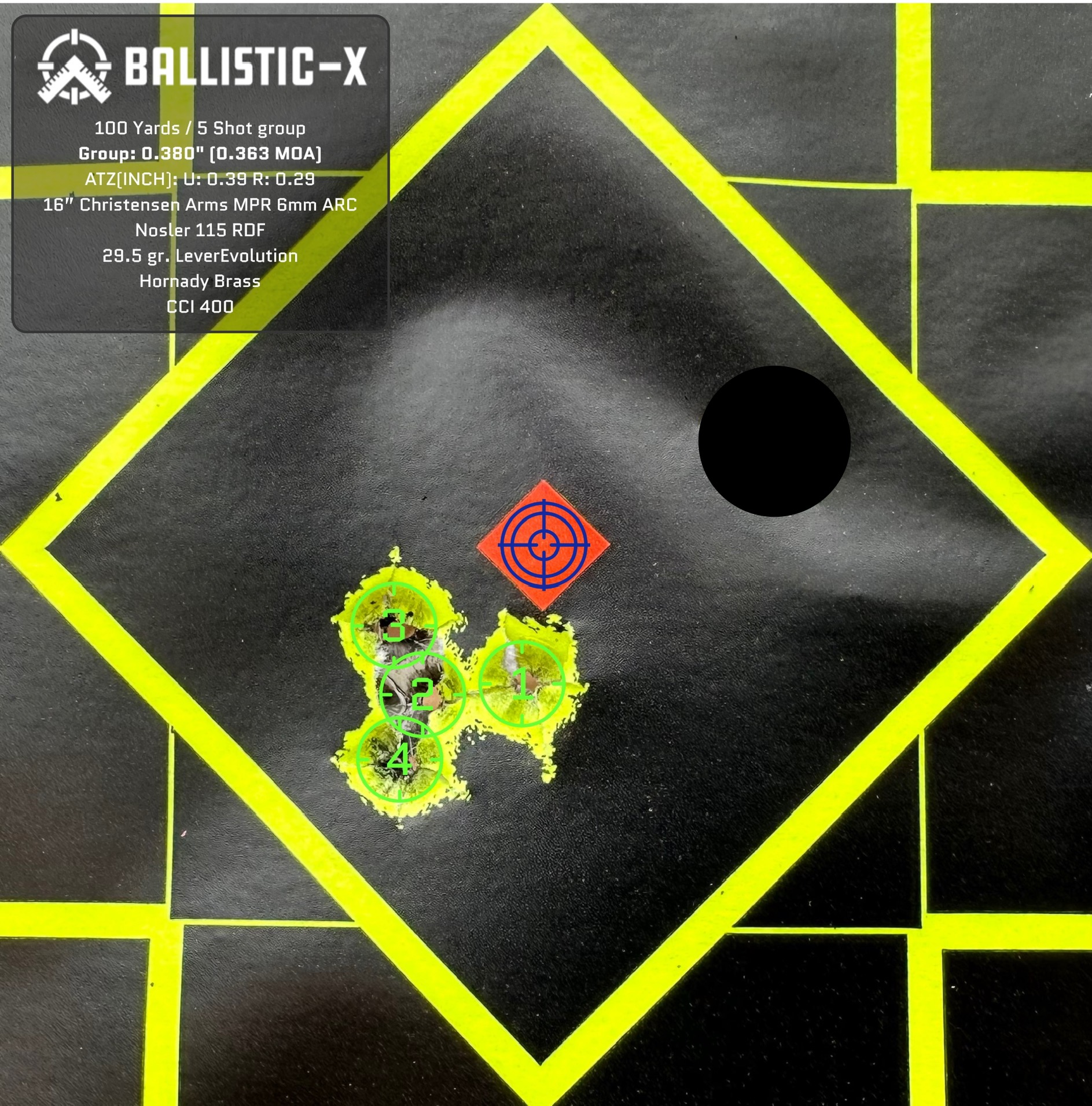

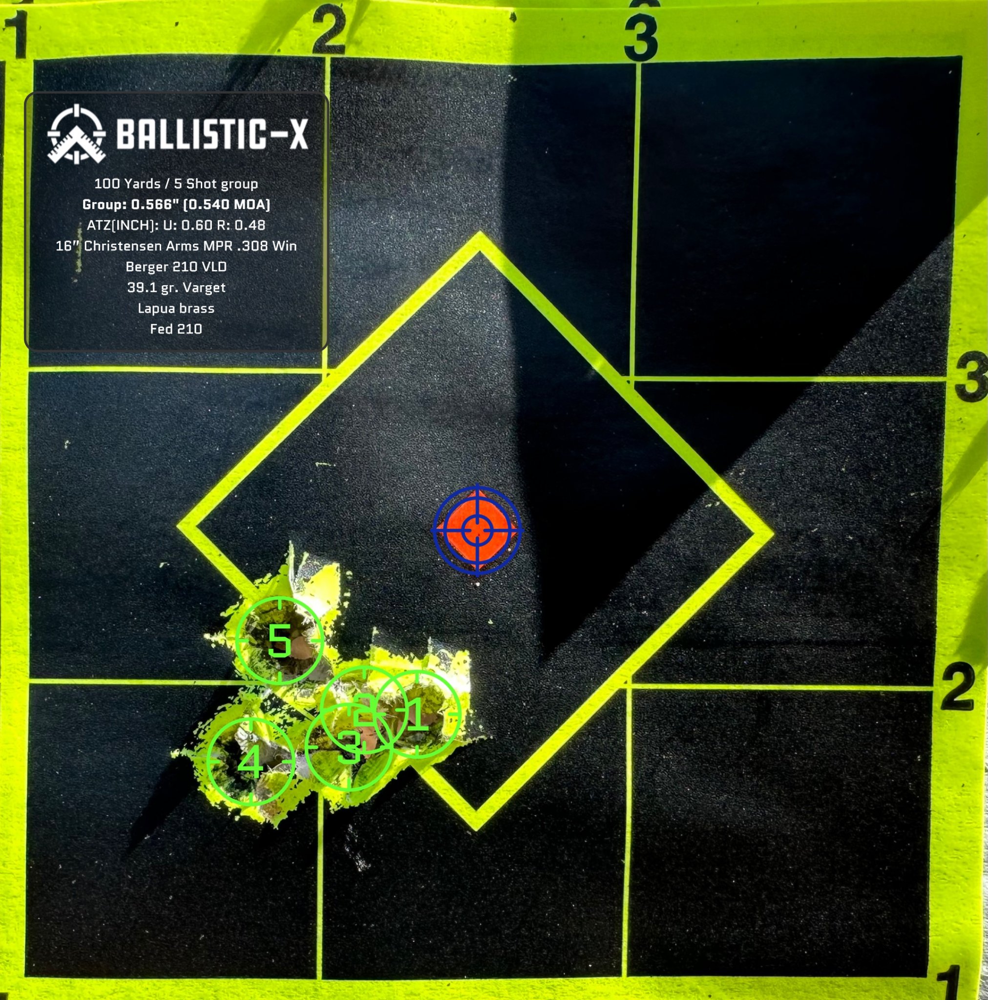

I have 2 MPR's, both 16.5" barrels, one in .308 Win, and the other in 6mm ARC... Highly recommend them. They're light, accurate, and a very solid platform that allows you to configure some things on it the way you're describing. They both shoot 1/2-MOA 5-shot groups @ 100 yards with handloads.
Ballistic-X-Export-2023-04-30 15:54:56.390625.jpg
Ballistic-X-Export-2023-05-21 17:59:48.110676.jpeg

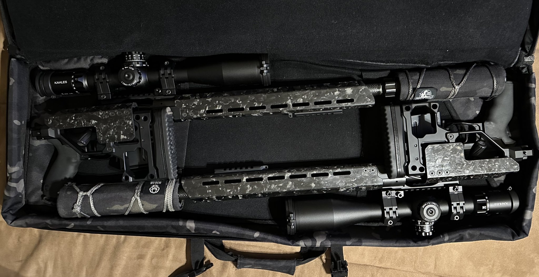

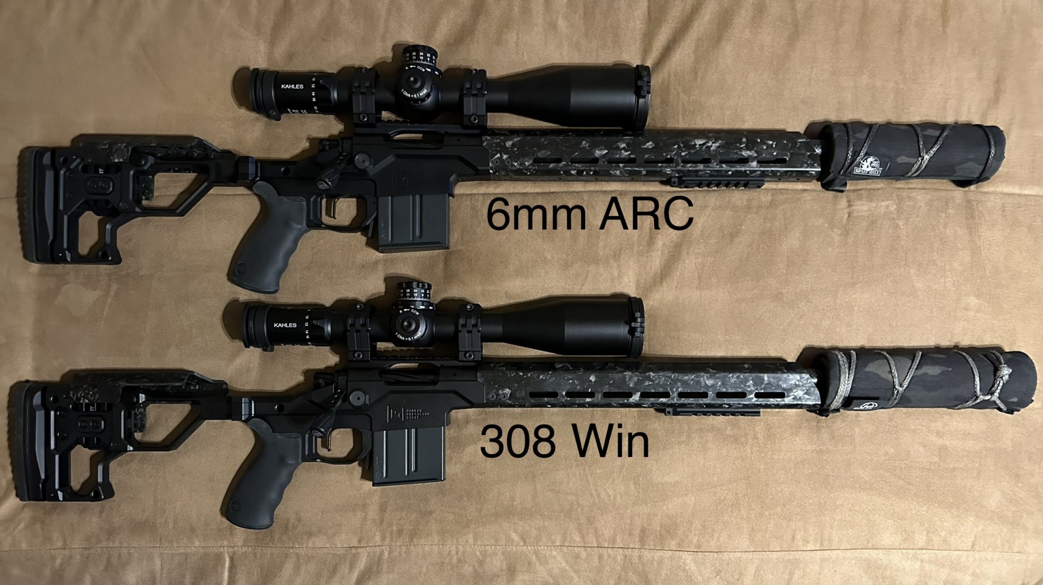

View attachment 8259569View attachment 8259570View attachment 8259576View attachment 8259568
These look gorgeous. Id love one but the very few companies that do import them to Canada must charge a hell of a mark up because theyre $3500 CAD.
