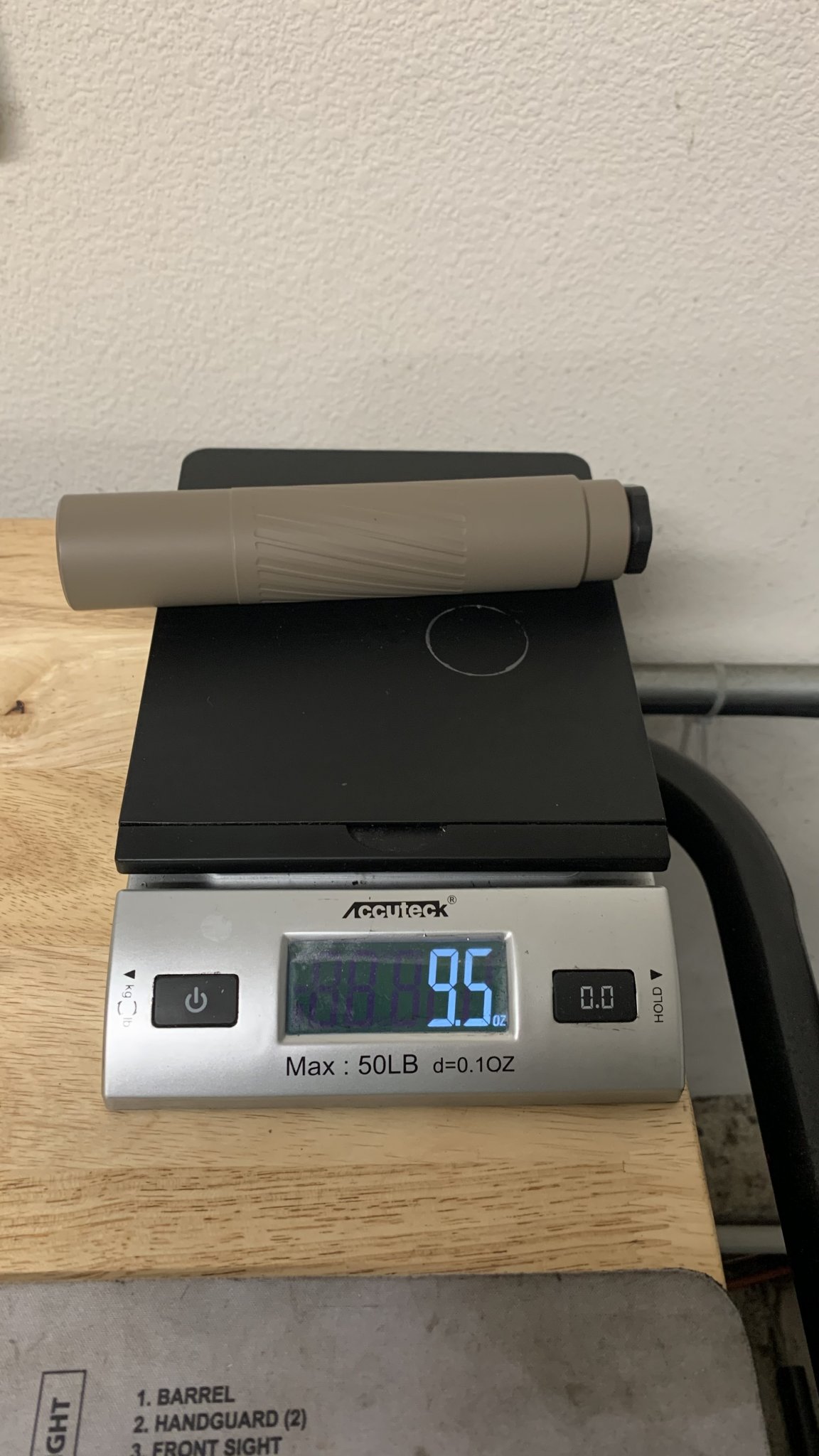

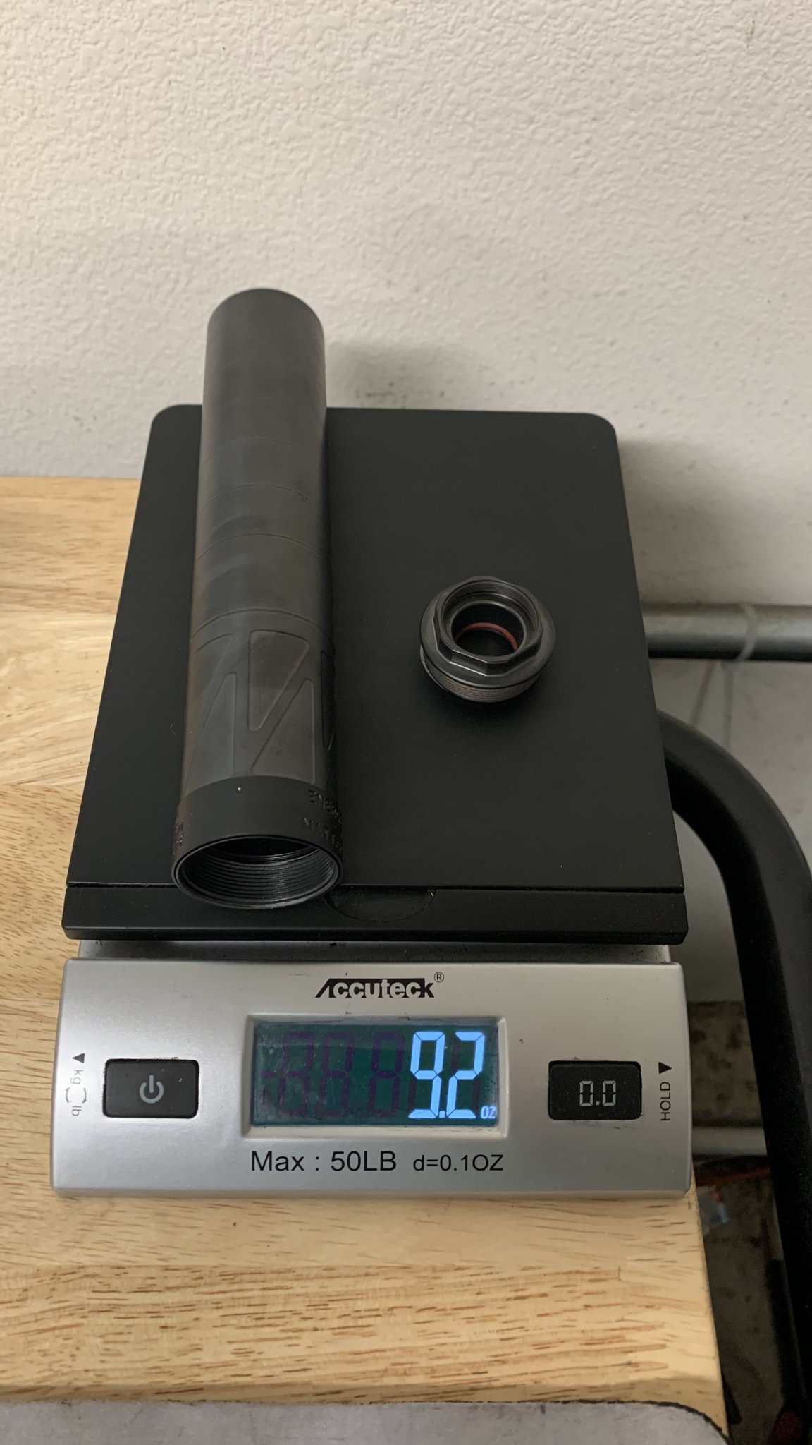

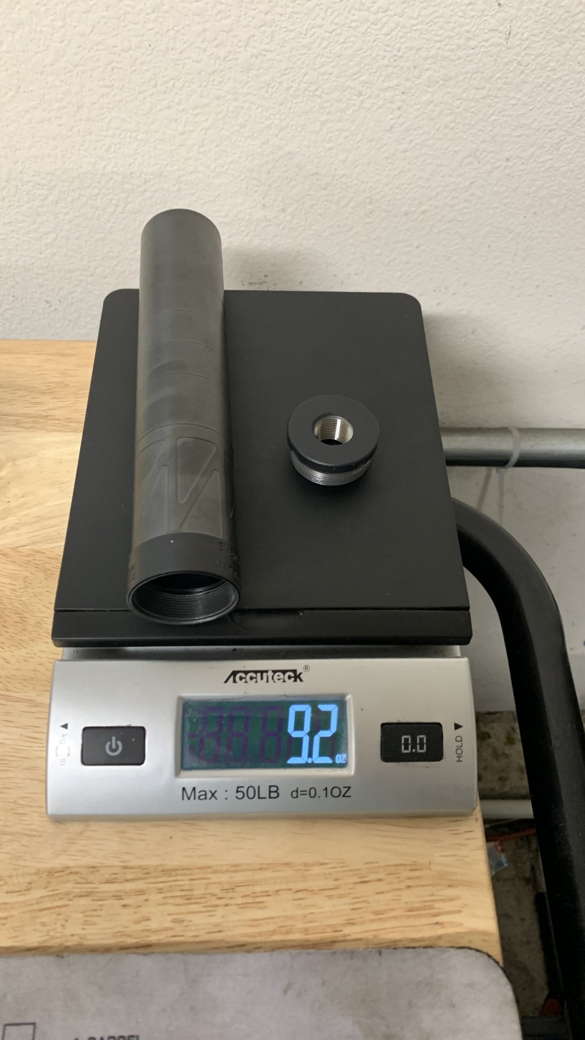

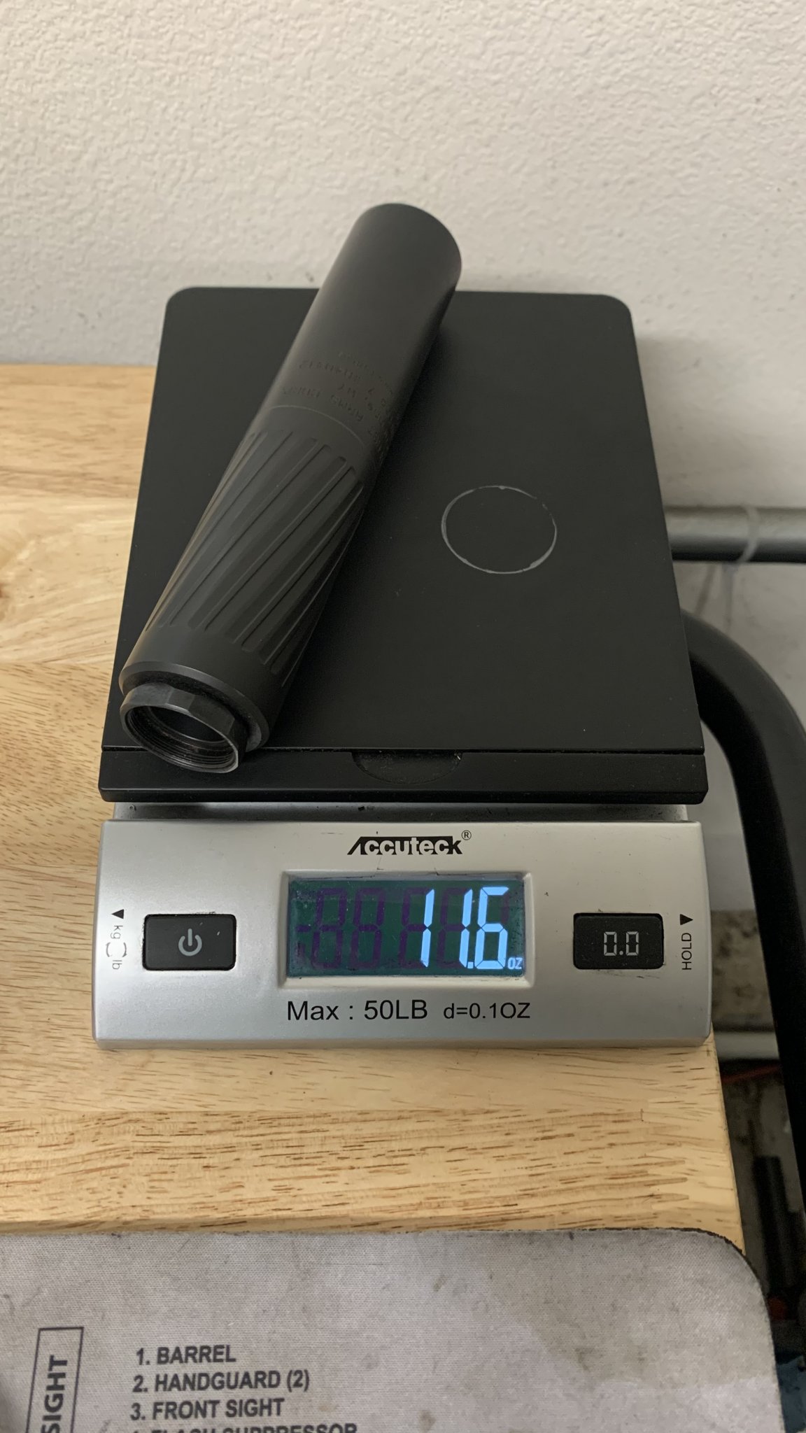

    Got one of these in today. You dont hear much about this brand and especially the Lux, which is pretty new. The specs didnt really jump out at me on paper initially, but now that its in hand its pretty impressive. Longer than an ultra 7 gen 2 by 3/4”, but almost exactly the same weight. The 30 cal version is 300 Norma rated with a 20” barrel. Not that this is the correct can for a norma mag, but thats impressively strong for its weight. Well priced at $930. These have been in stock at @HansohnBrothers and Allen Arms Tactical for at least a few months now. I haven't shot it yet, but soon.
    Lux 6.5 with included DT adapter. These have the Sico omega rear thread so a bunch of mounting options are available.

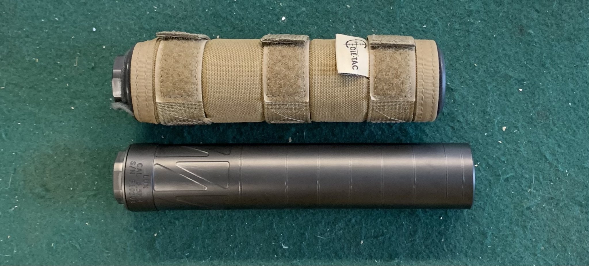

    Lux 6.5 with titanium Area 419 Sico Omega adapter
    Gen 1 Ultra 7 with area 419 adapter. The adapters for the Ultra are only made in nitrided steel.
    Gen 2 Ultra 7 30 cal with Area 419 adapter
    I like their whole line. They can be pretty hard to get though. Surprised Allen arms and Hansohn has so many of these Lux in stock, in both bore sizes.

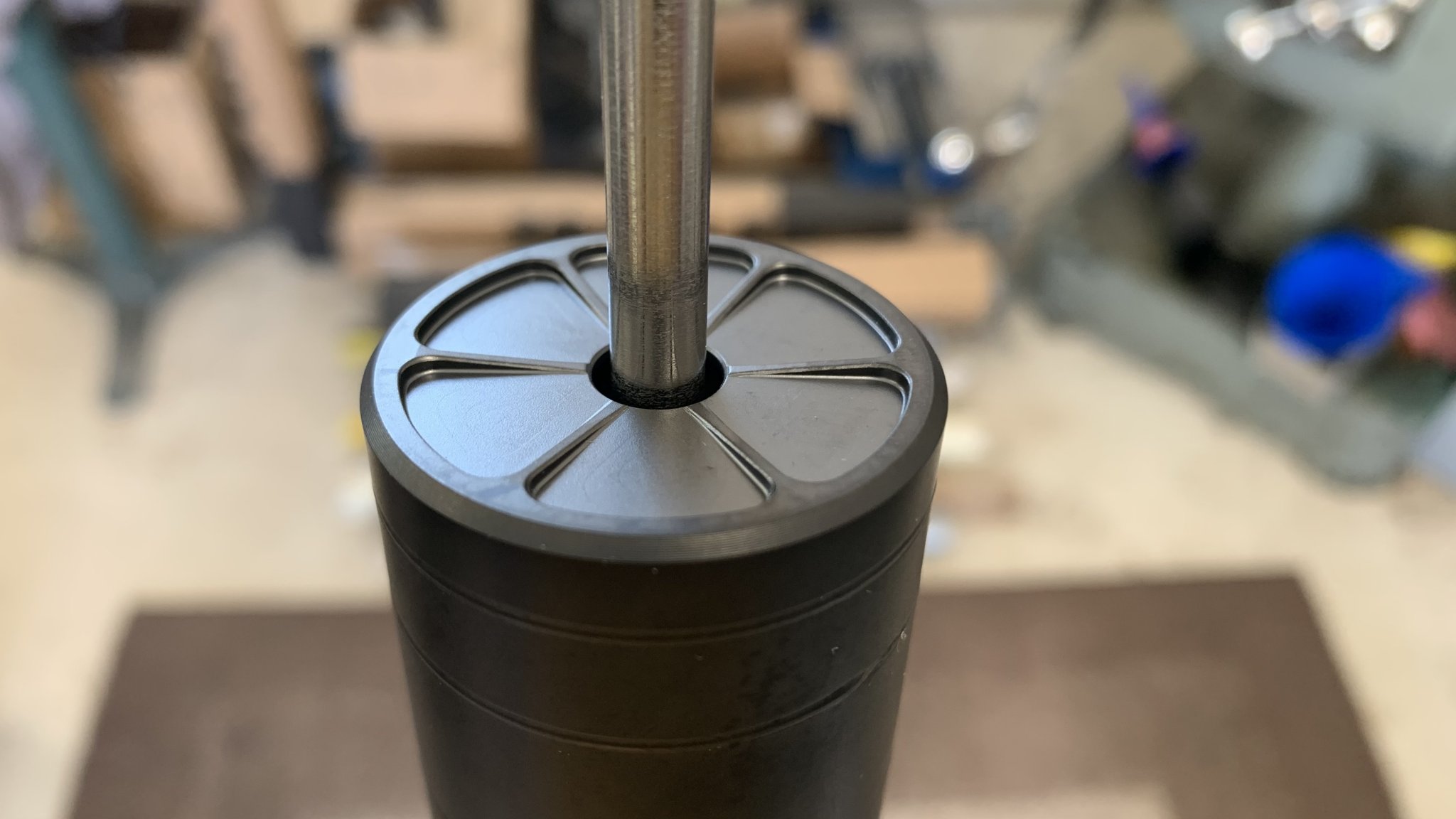

    On the bore size, this 6.5 Lux has a .340 end cap bore, and .325” baffles. Kinda big compared to an Ultra 6.5, which is right at .310 all the way through.

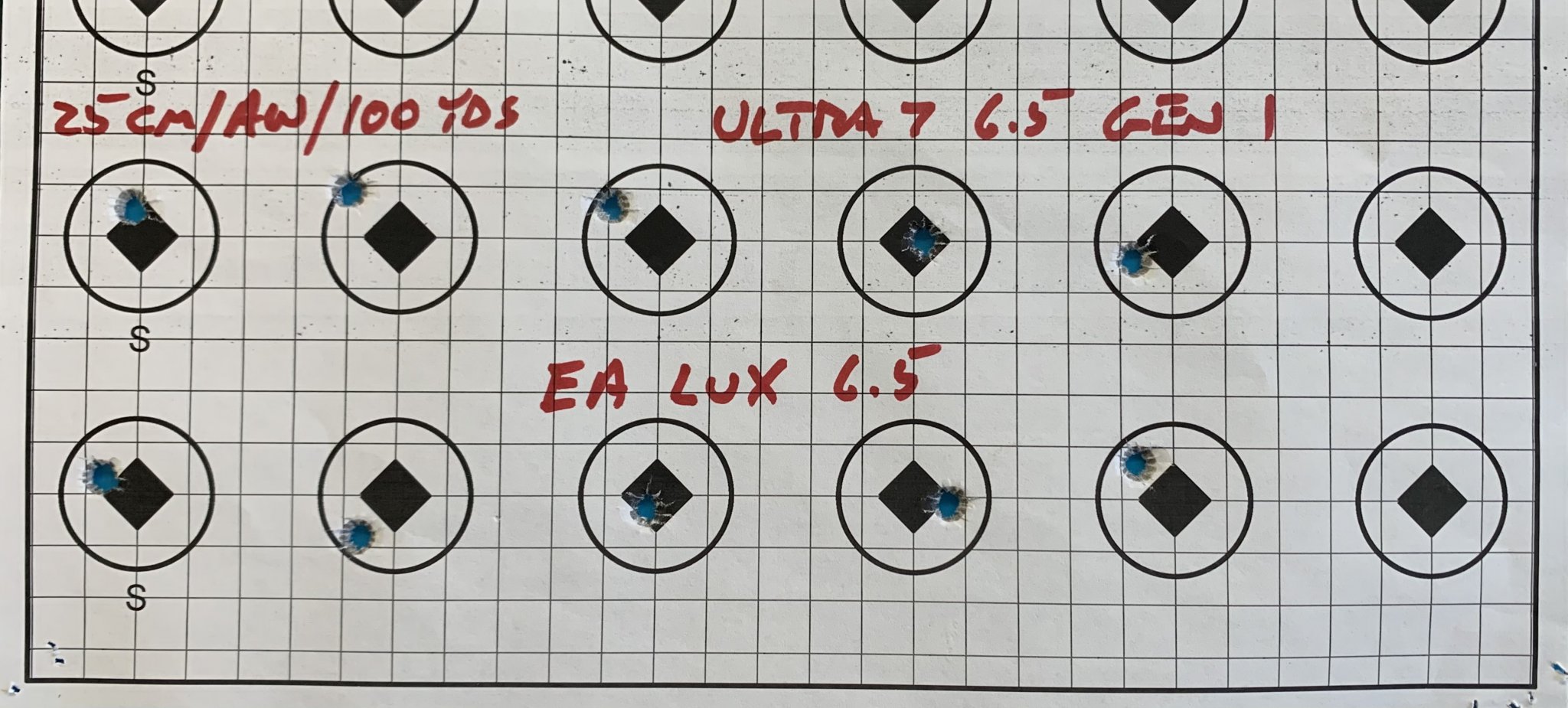

    Went out and compared it to a gen 1 Ultra 7 6.5, on a 25” 25 CM. Both cans configured as they are in the pics above, with area 419 mounts.

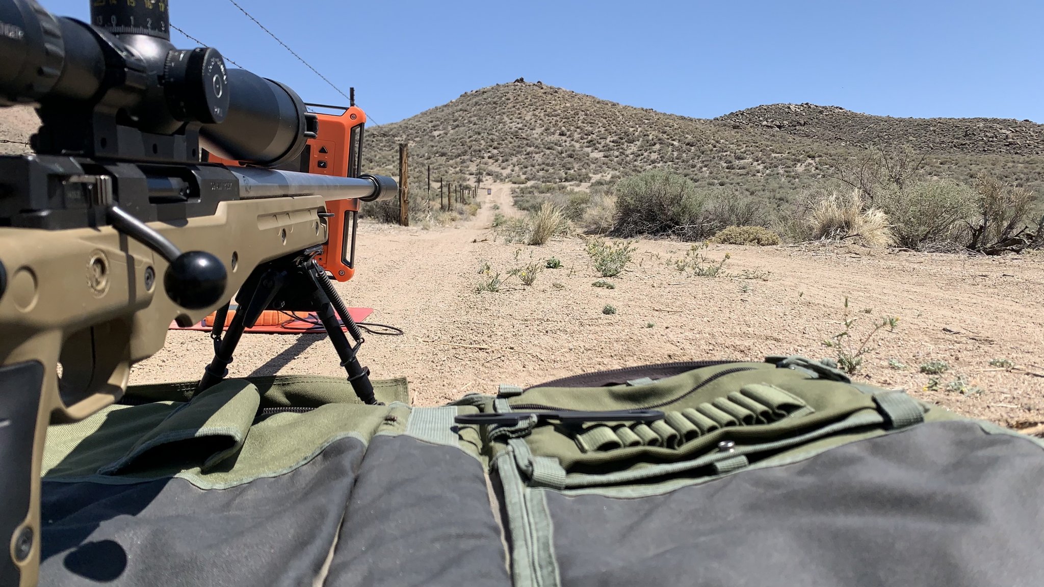

    Ambient mirage was bad while prone on the desert floor in direct sunlight. I dont have a cover for the Lux, so it was worse than the U7.
    No cherry picking or adjustments. Just five shots, suppressor swap, and five more shots. Virtually identical group and poi.
    Regarding sound, I cant tell the difference. Hopefully someone with some instrumentation can test one. I also shot it on a 16.5” 6.5x47. Again I couldn't tell the difference, but the Lux and U7 were both quieter than a Gen 1 ultra 5 6.5 which i run on the 47 full time.
    3” of .248” rod in a .250 bore. Its as eyeball straight as the Thunder Beast is.
