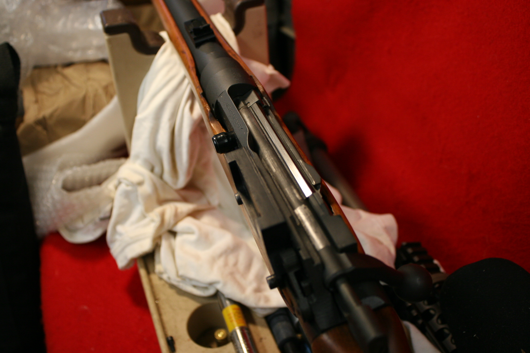

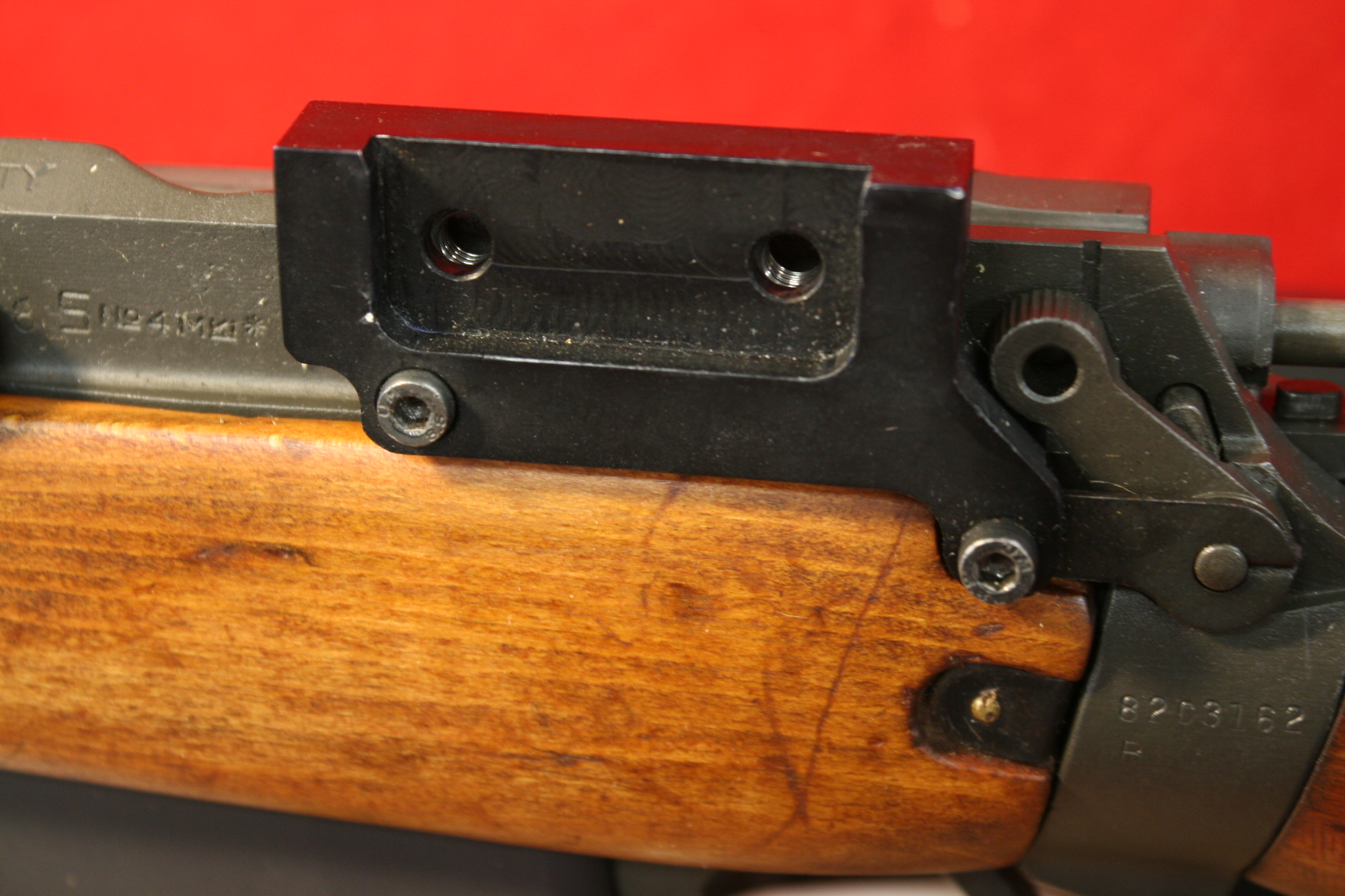

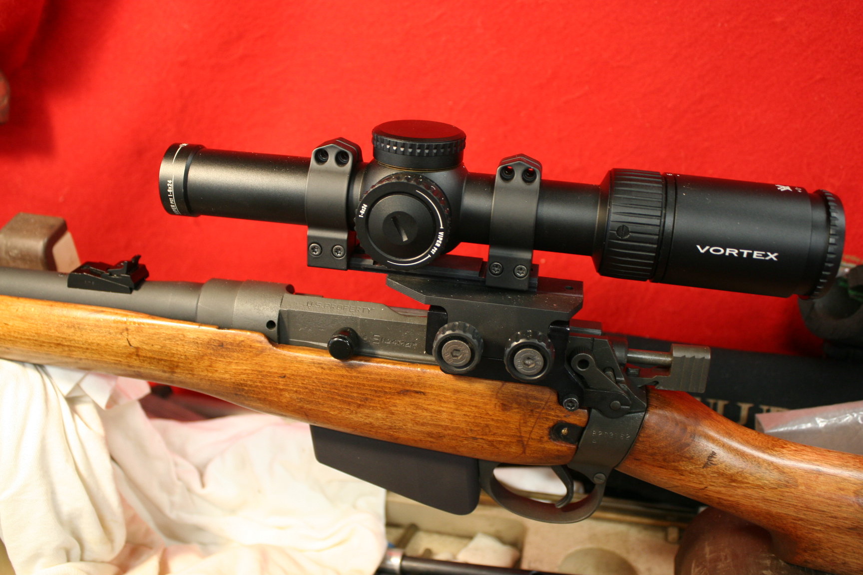

Thought this would be the best place for this.
Looking for suggestions for a mount for this Enfield. It has been modified with a SAI 45ACP conversion. I didn't do the convesion, bought it like this. The orioginal owner said SAI did the conversion for him. I don't know how much modifications had been done the the action prior to conversion or if SAI did the mods.

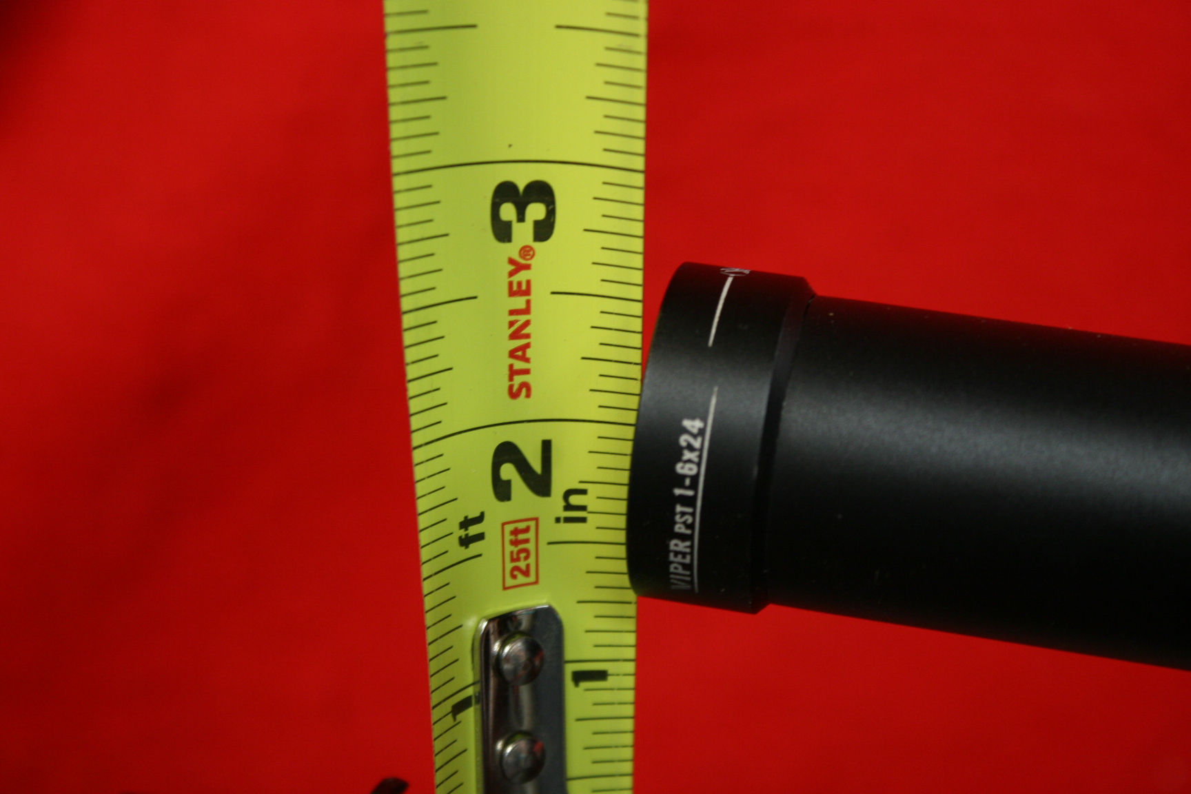

The mount in the photo is an out of production Brownell's that came with the gun. It is about 2 1/4" from top of barrel to scope centerline. It is HIGH!!
I am looking for something to lower the scope. I just about need to screw a 2x4 to the cheek to be able to see through it. All the mounts I have found attach to the old rear sight mount.
Is there something else out there I am missing???

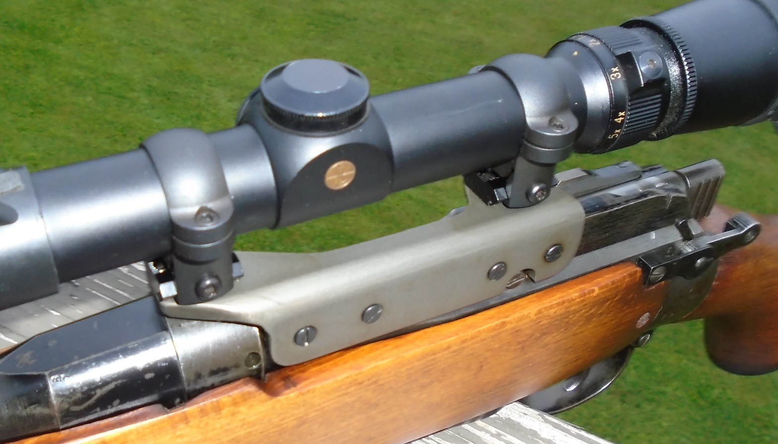

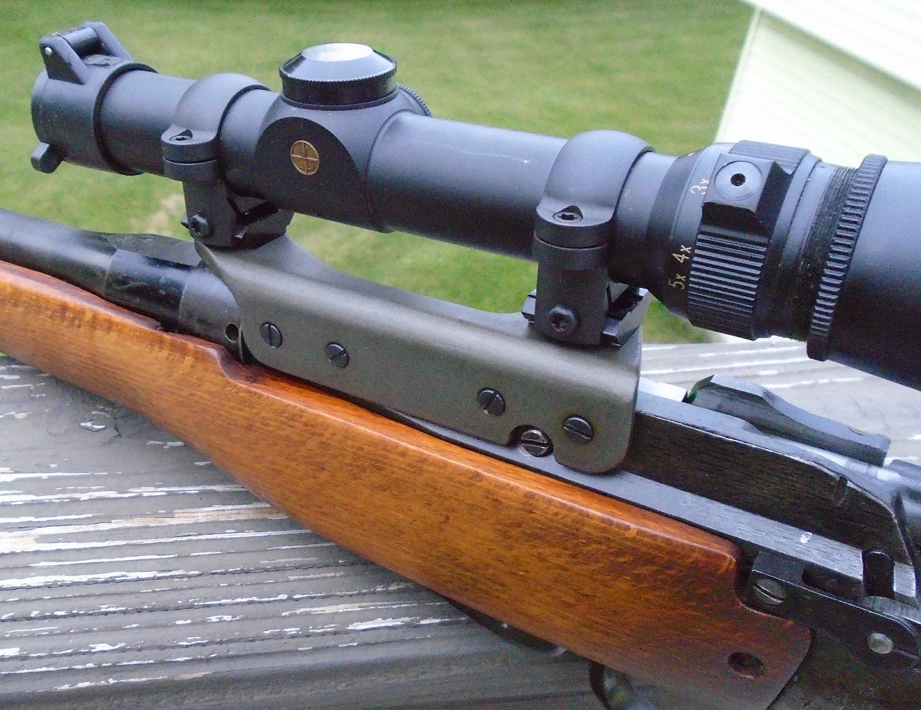

The charger bridge has been removed, so the Weaver will not work, nor will any of the "no gunsmithing" mounts currently available. For my rifle I whittled a side mount out of 3/16" angle iron and parkerized it on the kitchen stove. A .006" steel shim fills in the milled panel just aft of the receiver ring. Works perfect.
