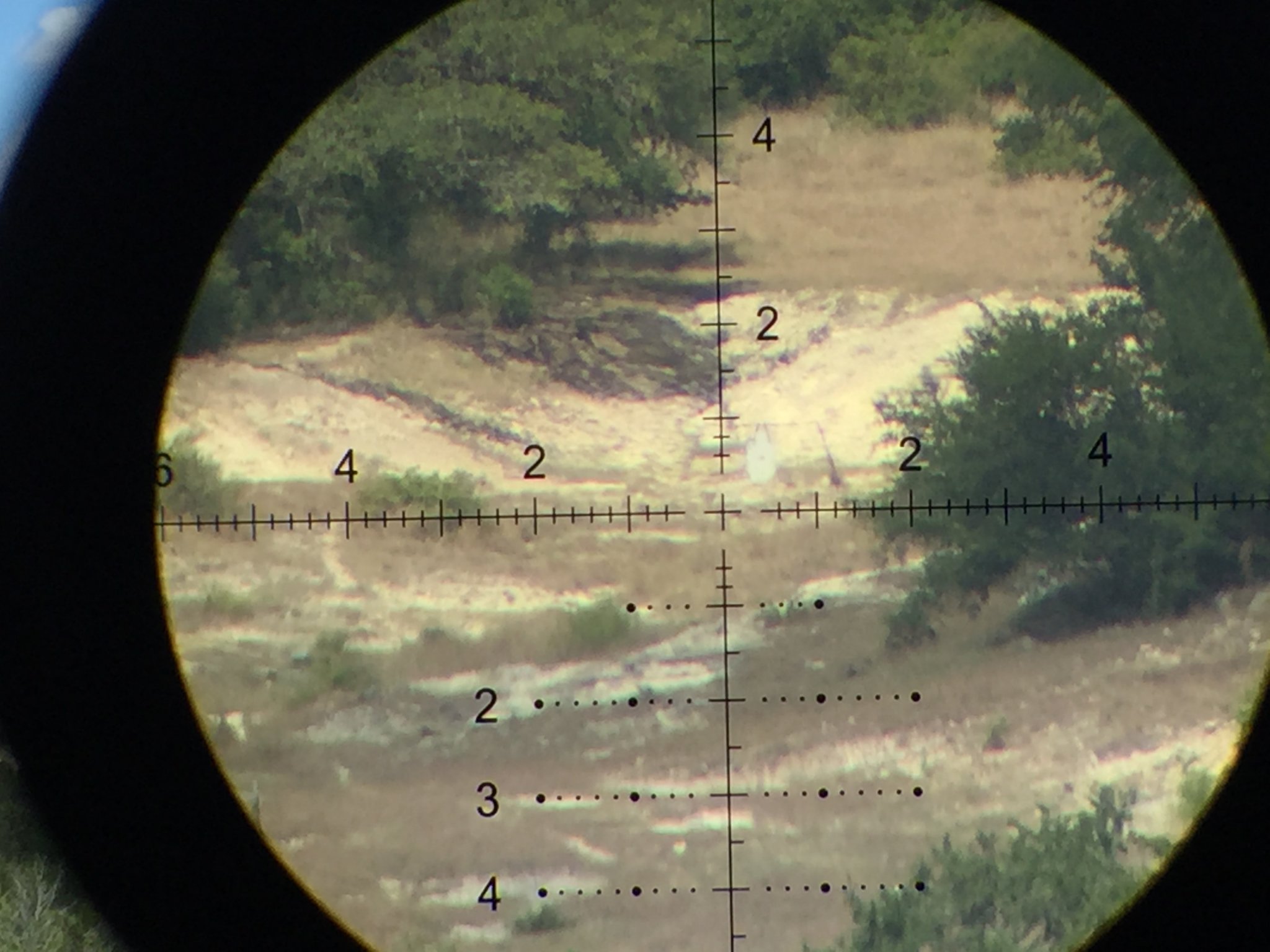

Here’s my full size ipsc at 1570 yards through 90-100 degree mirage in a Texas september at 29x last year. It was even better through the scope than my phone displays here.
7121641
Others will tell us to quit being poor but... look into an athlon cronus btr for more zoom and less money.
Really does look good!

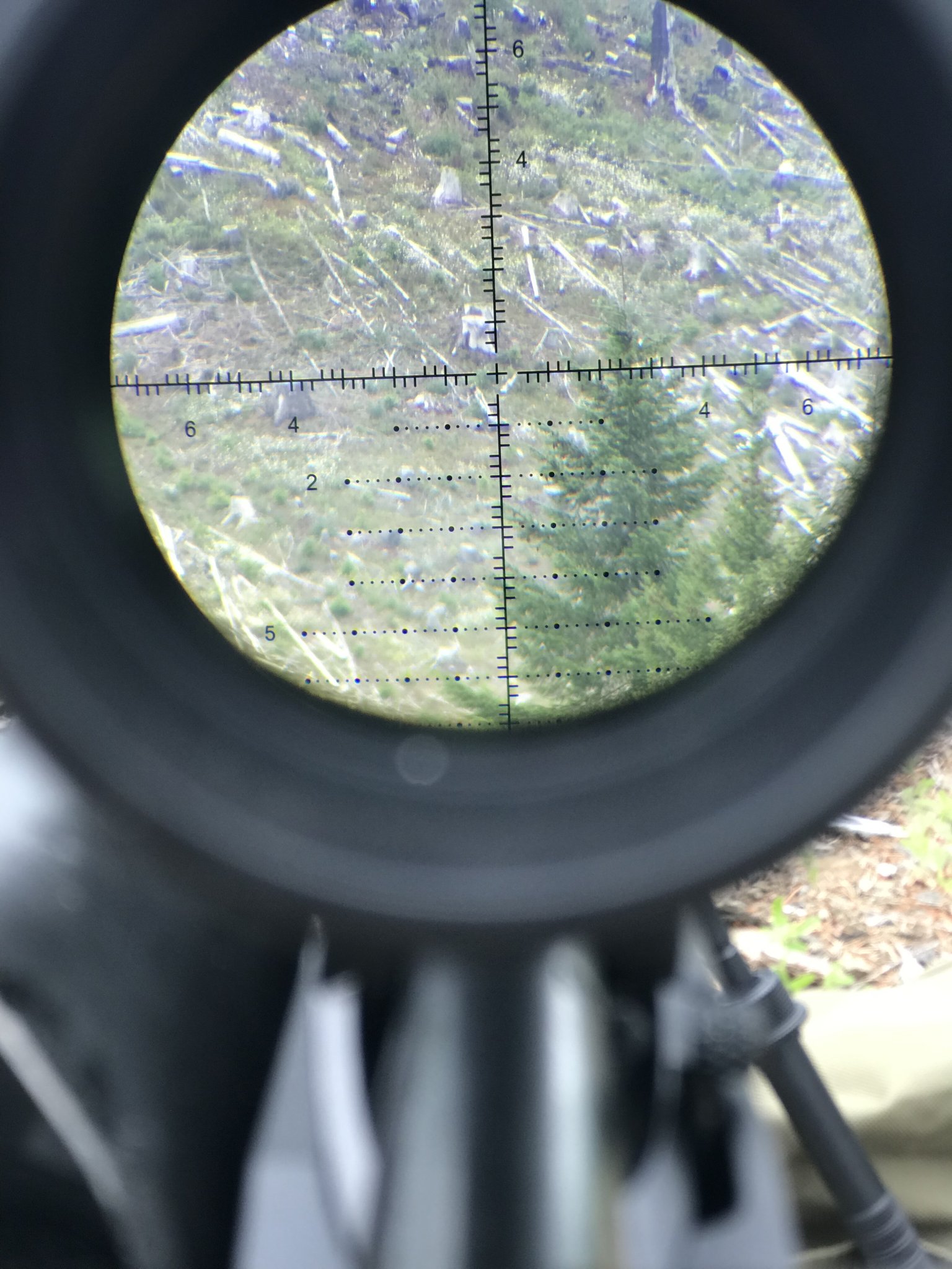

I’ve shot out past a mile with 260 topped with a Sightron 6-24 SIII MOA2 reticle. Worked just fine.
Shooting hill to hill with very little mirage that day. Scope maxed out using reticle for holdover. 1792 yds (80 + MOA). It was steel and not a milk jug but I don’t think I’d have any issues seeing a milk jug in those conditions.
Shot Milk Jug and a 1lbs powder container at 1440 yards with same setup. No issues seeing the target
I will add that my Cronus BTR with the tree reticle would have made the whole process easier. So if you plan to holdover with the reticle id suggest something with that style reticle

FWIW, this is a 1 mile target at 70x through my NF spotter with Phone Skope.
