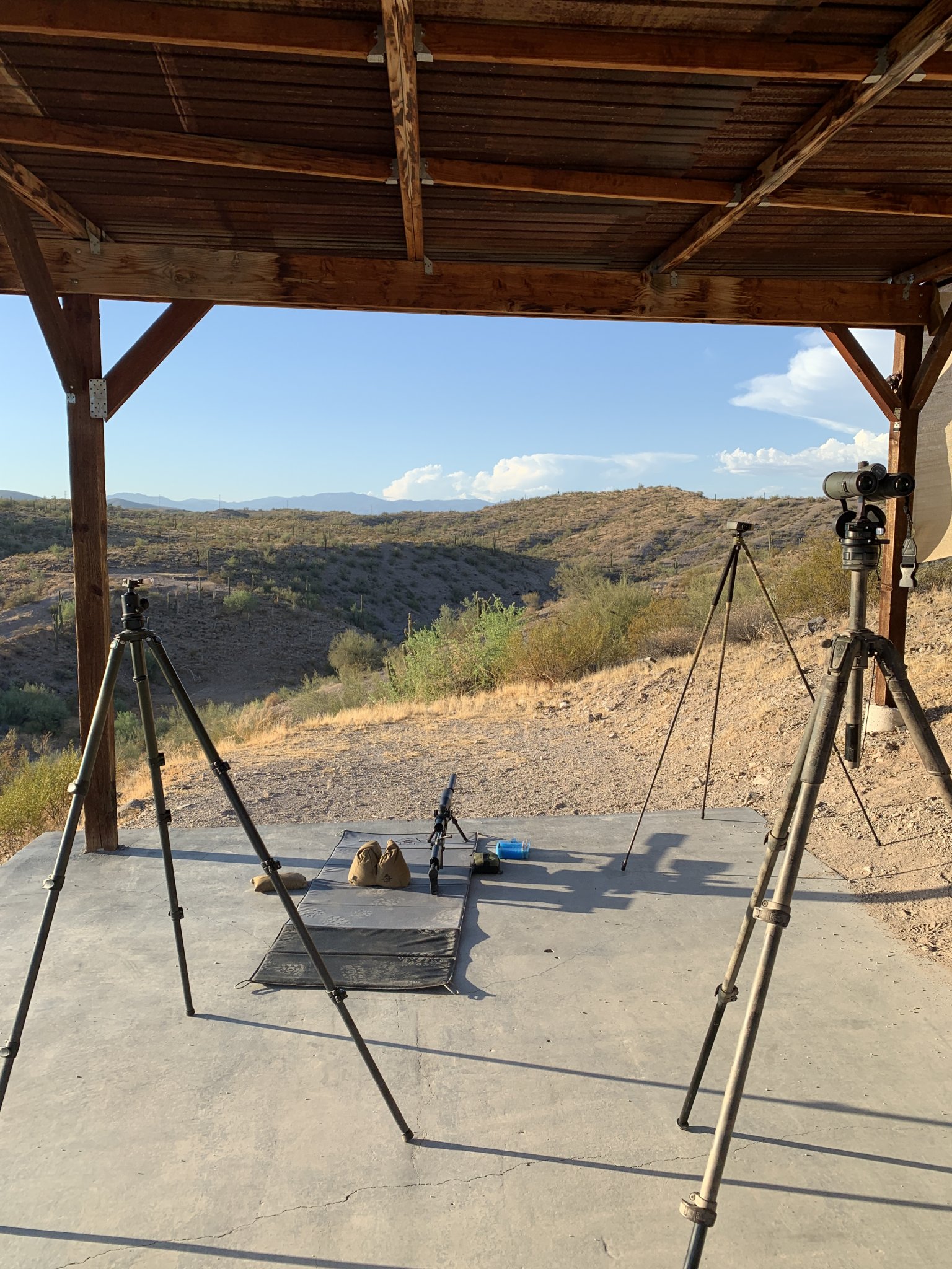

Went out to cow town a couple weeks ago. Before even shooting my chassis was hot to the touch, as in too hot. 4:00 in an Az afternoon will do that. It was in the sun so i moved it into the little shade we had. After a 5 round string the barrel was really hot. I was shooting suppressed which doesn’t help. Let it cool in the shade again but a 10 round string was really pushing my comfortable limit.

pic added, but it was almost 7:00 when taken already half cleaned up.
yes, i want a barrel chiller, for the 3-4 months out of the year that i am not wearing my barrel prematurely. It can’t hurt.
Wow, AZ in August at 4pm. Now that's dedication, mate. 👍 ;)
