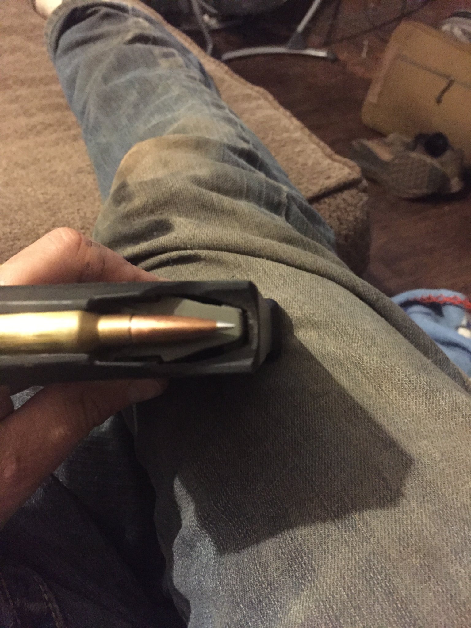

    That’s good to know. I reload but haven’t loaded anything for a 6.5cm. I’ve just read a few things from others that said their reloads wouldn’t fit in their mags or blind mags when they seated their bullets out a bit to increase accuracy. So you haven’t experienced this when reloading 6.5cm or are you just running factory stuff?
    With long OAL mags common today even my 260 doesn’t have that problem.
    6.5CM maybe in some AR mags Could have that issue.
    Reactions: jcmullis2
    I just read something along those lines. I’m looking at using the aic mags in krg bravo chassis for this build. I’m pretty sure the short action will work just fine. Thanks
    Yeah a metal one would have more, there’s not a lot of room left but a little bit lol.
    There’s plenty of room in that mag of yours. I’d have no problems using those. I’m not gonna be shooting competition or anything like that. I do on occasion wager a few bucks but usually it’s just bragging rights. I believe most of a rifles accuracy comes from the barrel so I need to get that right too. I’m leaning towards the remage criterion barrels but everything is still in the planning phase. Which brand barrel are you using and what size groups are you getting?

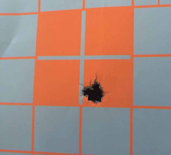

    This one has a 24” bartlein 1-8 twist 5r barrel, with factory hornady ammo I could get around 3/4 moa sometimes a little better. Just curious why your wanting to do a remage especially since the new tenacity can do shouldered prefits, I know proof is doing steel barrel prefits for the defiance ruckus action for $479 thru Altus you could possibly check around and go that route.
    The truth of the matter is mainly lack of knowledge and not wanting my rifle sitting at the gunsmith for weeks. The ease of changing barrels and price of the remage style barrels appeal to me. Can you put the same prefit barrel on different actions? This type of thing is new to me.
