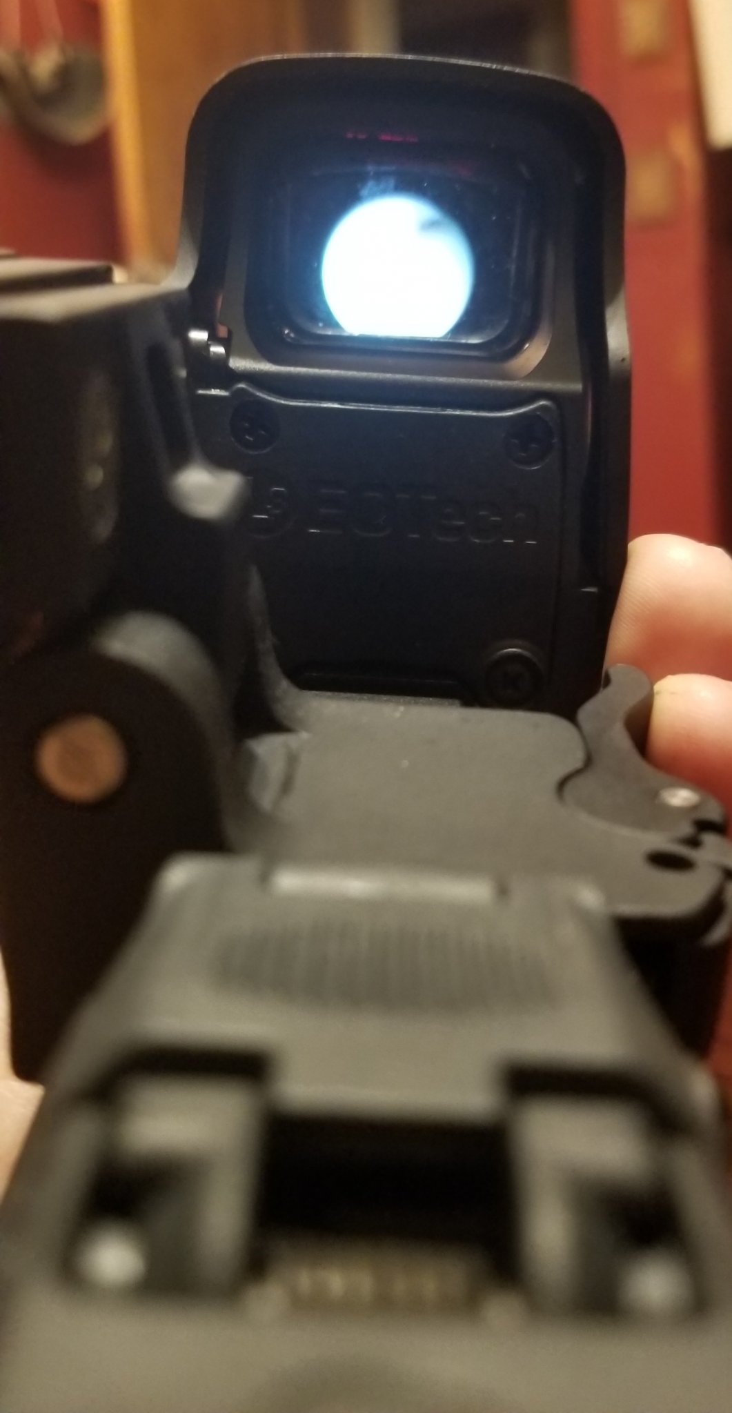

Trying to put a clip on in front of a eotech dosen't work. You are better off with a dedicated thermal and then swap sights when you want thermal. Will be far better balanced and easier to use.

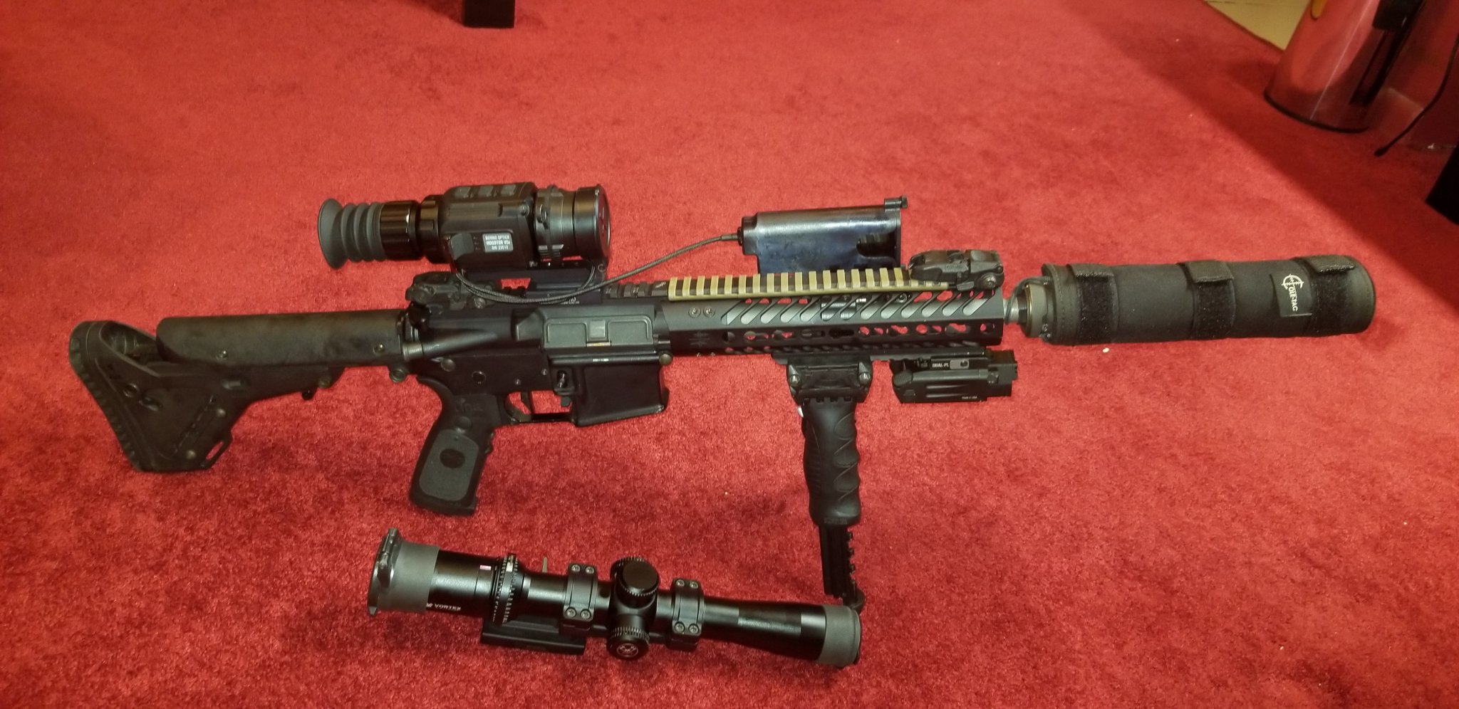

This is my rig with Hogster and a 2-10x scope.
And to be clear, I am not saying you can't do it, here is a hogster-c as you describe, but field of view is cut in half, it is front heavy and having to focus at your front of handguard is awkward.
A dedicated thermal with QD mount is just much nicer and less expensive. I got my clip on first, if I had it to do over, I would have started with dedicated.

The problem is the distance between the magnifier and the clip on, if you mounted a clip on 8" in front of a scope, it would be messed up also. The clip on has a square screen, but mounted this way, you see about half of it, you can not even see the indications around the edge of the screen or the entire menu to make changes.
Maybe some othe clip on is different, but I think this will be common among most.

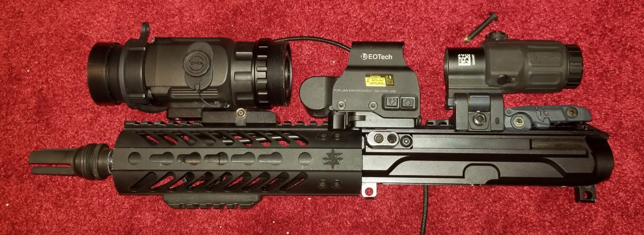

The RH25 is your best bet in your price range. It’ll be difficult to use anything in front of an Aimpoint/EOTech RDS without the magnifier.
I run this setup on a subsonic .300BO as well (I have two RH25s) and it works just fine, but really requires the magnifier.
Are you able to see the full screen with that setup or is it less FOV than when used with a scope? I tried it with a Hogster-C and it felt like tunnel vision to me.
As Horta said, RH25

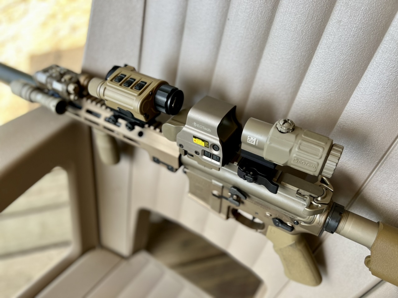

One advantage that an LPVO would have is being able to dial down to 1x for maximum field of view, and then add magnification as needed. Obviously a 3x magnifier like my setup is not as versatile at getting the most out of the clip-on function. That said, it’s still badass with a magnifier.
(I’m waiting on the QD mounts to come in)
Deer at about 65 yards in 2nd photo:
  • Love
Reactions: TheHorta

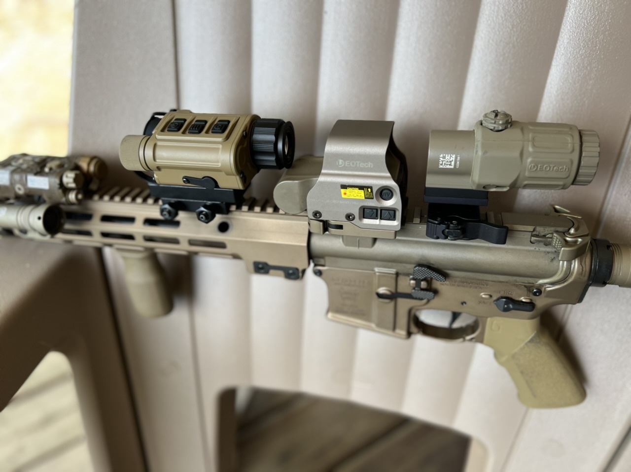

@French1966 In your attached image, are you using the iRay shock absorbing mount in combination with Scalarworks 1.93" optics mounts? Are the optical axes pretty well aligned?
Yes, the factory recoil reducing mount lines up near perfect with 1.93 height mounts.
To be perfectly clear, I have not shot with it yet. So I can’t speak to the margin adjustments needing to be used for proper POI. Visually, it appears that no adjustments are needed.
My main concern was testing it with my Aimpoint/3x mag combo to see if it was even usable visually (will I get a usable image as opposed to all the reviews I’ve seen with LPVOs). I was pleasantly surprised to find the image being very usable with a magnifier setup, you just have to find the right diopter setting on the RH25 that matches your magnifier.
Now that I know it works visually, I need to go shoot with it. I don’t expect any issues though. After that I need to get the QD mounts ordered, and find a riser that gets that ADM mount close to 1.93
