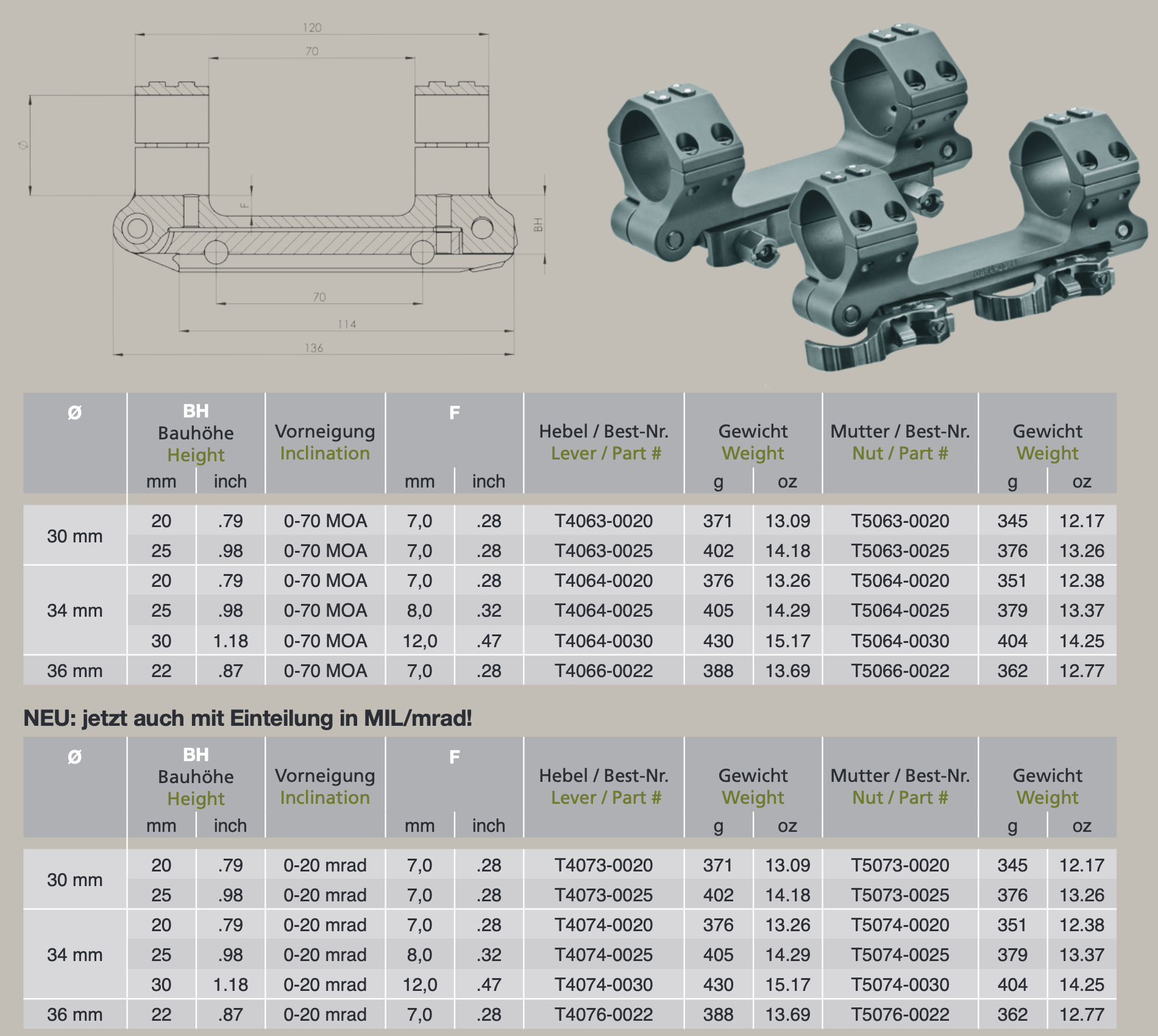

Just so we are all on the same page and there is no misinformation out there...unless I am mistaken (or you are using that weird Eurooptic conversions that they tried to do), 30mm rings come in 20mm and 25mm heights. 34mm rings come in 20mm, 25mm, and 30mm heights. 36mm rings come in 22mm height.
NOTE: Era-tac measures their ring hight from the rail to the bottom of the rings, not from the rail to center. This is what Eurooptic tried to correct for but last I checked, didn't do it for all models which is why I found it very confusing when browsing their website. See chart and drawing below. Focus on the last digits of the part numbers to verify before ordering from EO.
EDITED TO ADD: For the US conversion we are familiar with, add BH (in inches) and 1/2 ring diameter converted to inches. For example:
34mm rings in 30mm height
BH in Inches = 1.18"
1/2 (34mm) converted to inches = 0.669291"
1.18" + 0.67" = 1.85" high rings. This is what you will find on EO.

I contacted Europtic this morning and had a very clear, concise and easy conversation with a guy in customer service.
After collecting the Data:
Rifle; Scope; Base; Caliber; and my intention to max out the Era Tac adjustment without bumping the Objective and barrel, or obscuring the target at that 20MRAD max.
He informed me that I would need 1.25" to the center of the scope tube.
A+ for Customer Service, so far.
I did some measuring and math and I am sitting at 23mm right now (between Rail and bottom of tube).
If I go down 3mm to 20mm Height model, It might get too tight with a cap on my objective.
If I go up 2m to 25mm Height model, I just need to jack up the cheek rest a touch.
I opted for the 25mm just in case. Got off work and it's already been shipped.
