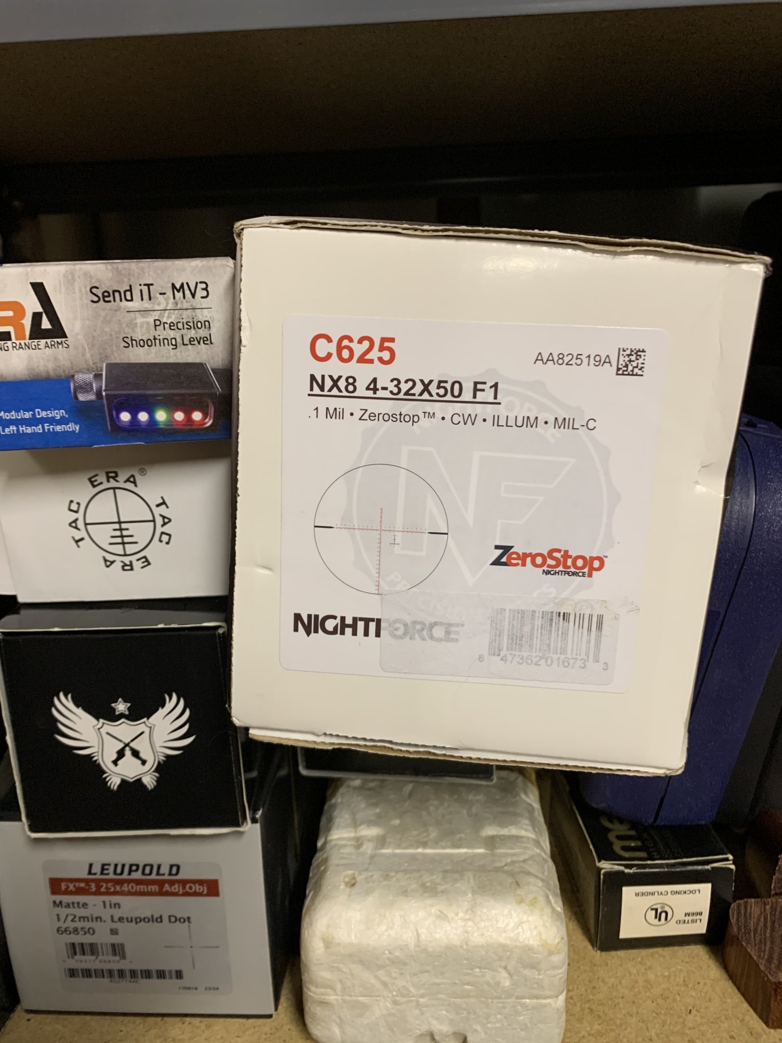

Couple questions.
- How did you make the measurement you are referring to above? With a reticle? Tape measure?
- can you share a picture of your NF box model? Looking to see if you bought the F1 or F2 model.
Couple questions.
I measured with the reticle in my NF, and my shooting partner confirmed with the reticle in his Kahles.
Picture of my scope box below.
I am new to both ELR and adjustable bases, so I’m open to this being user error. That said, the numbers were repeatable hence my thinking it may not be user error/user error alone.

You could try using it to maximize your scope travel then just lock it.
With that scope you should be able to get 25+ mils total and that should get you to a mile with most suitable cartridges
