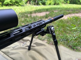

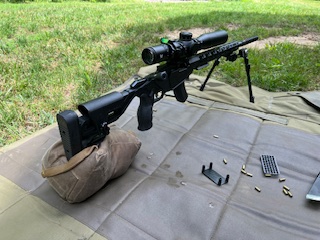

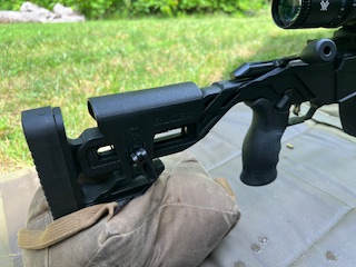

Here's pics of the rifle and two groups that illustrate the issue. Both are as perfect of trigger presses as possible. There were no flinches or movement of any type for each of these. The first is 10 shots and you can see the horizontal pattern. NO, it isn't the three inch group that I've been seeing but I took this pic because it showed the pattern so well. The second looks like a three shot group, but I assure you, it is 5 and two went into the same freakin' hole. It took a magnifying glass to see that two of the holes are slightly oversized. These groups were back to back.

Make sure a bolt or nut from your bi-pod attachment (or anything else) is not contacting your barrel. The barrel is totally clear in the hand guard, correct?

Last point, make sure your rifle is 'level' while shooting. It's very common to introduce a bit of a cant when aiming, especially if your target doesn't give much of a reference for level, ie horizontal lines of some sort. A cant can cause some amount of change in POI, especially if the cant is Not always the same.
PS - Those stickers in the pics look to be more than 3/4", but that could be since 'black' just 'looks bigger'. I use 3/4" dots from Dollar Store, some are for Yard sales with $ amounts printed on 'em. The same store has dots that are 1/4" but my scopes are 25x or better and 1/4" is still a 'big target', hence the " + " targets.

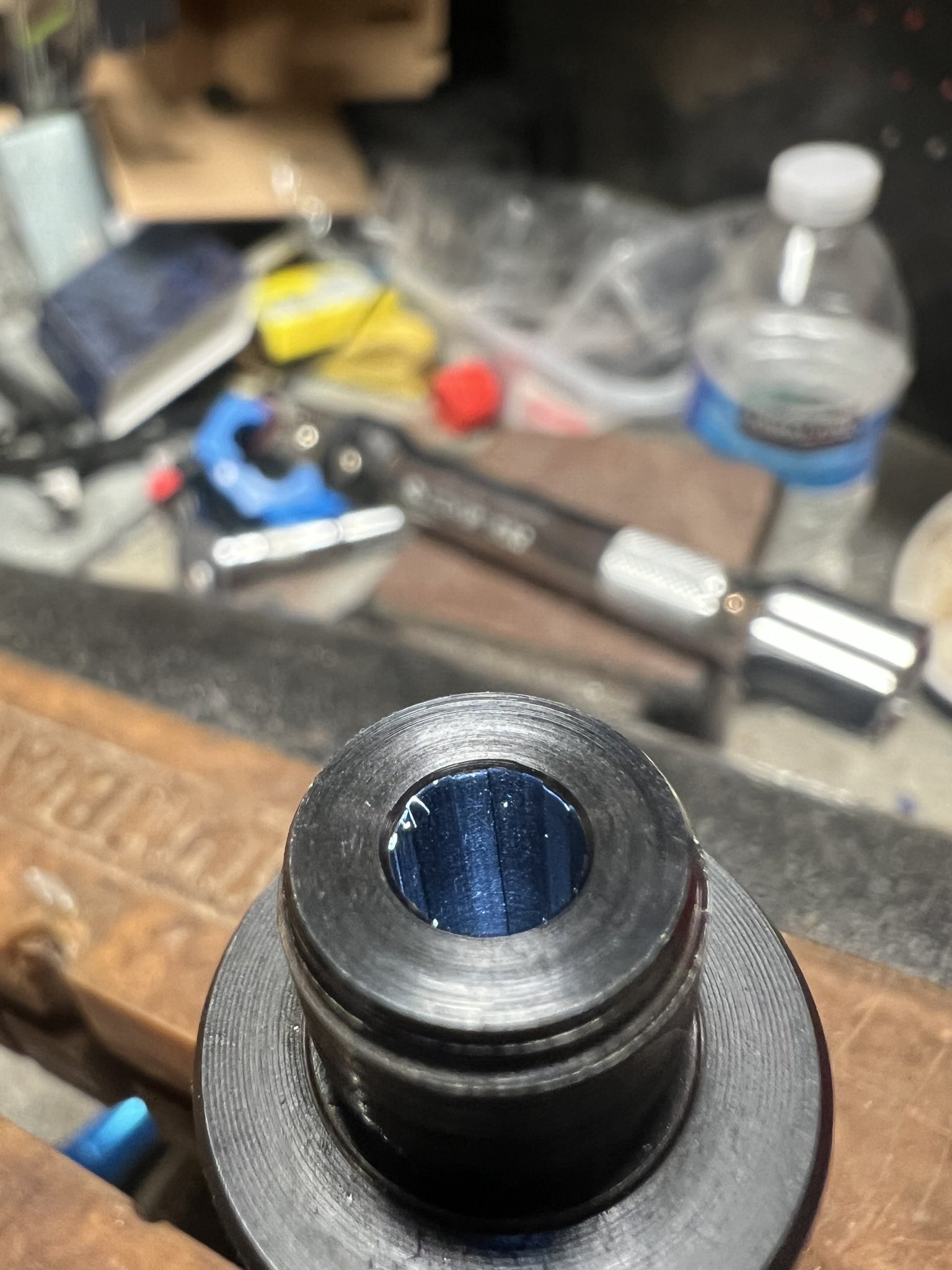

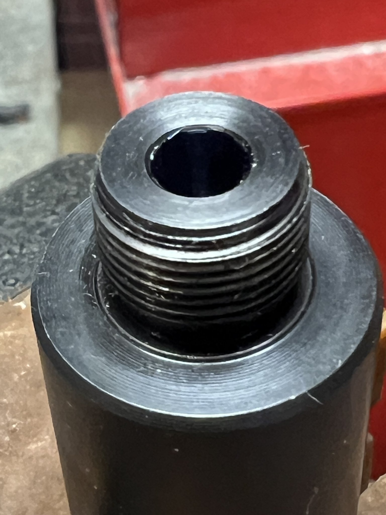

I’m not going to absolve myself from any issues, but I decided to carefully examine the crown. At first, it looked just fine but then I used my camera to get in close. It looks like there are rough spots on the edge of the lands. I cleaned and looked again and sure enough, it is buggered.
I’ve already got a Shaw barrel ordered. I’ll update when that gets installed
Boy, that could be an issue !! You could get that cleaned up and maybe have a good shooter out of it . . . or some barter material if it turns out good enuf to trade off. Still, the other suggestions should be addressed even with a new barrel.

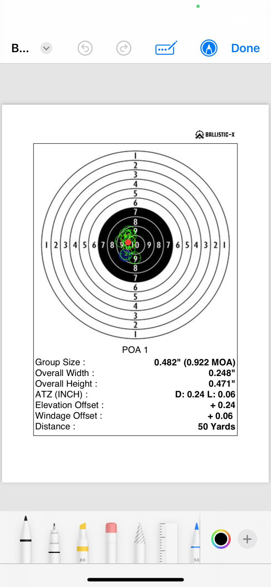

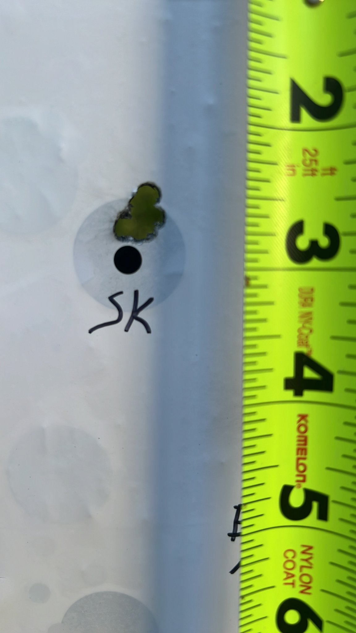

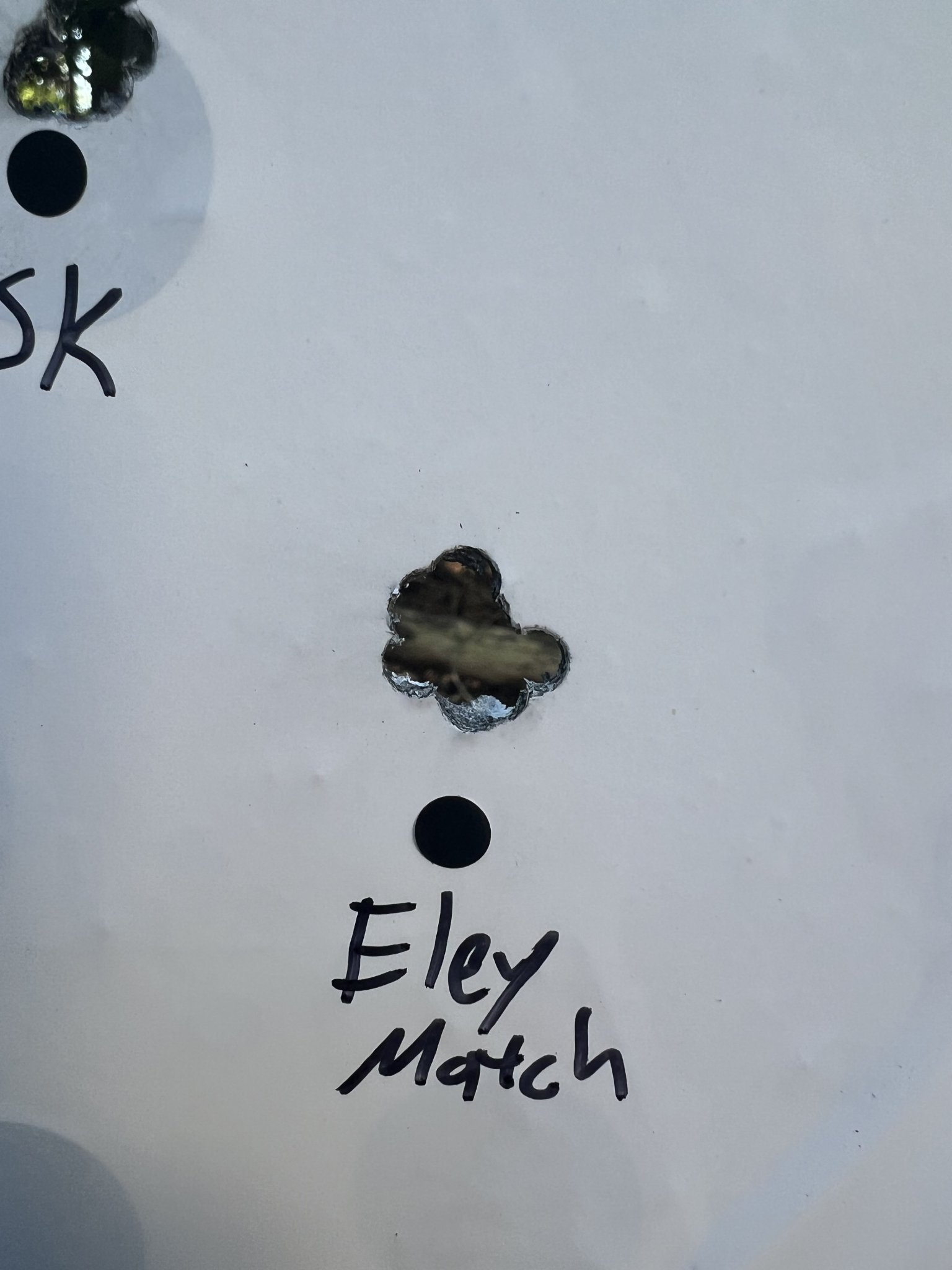

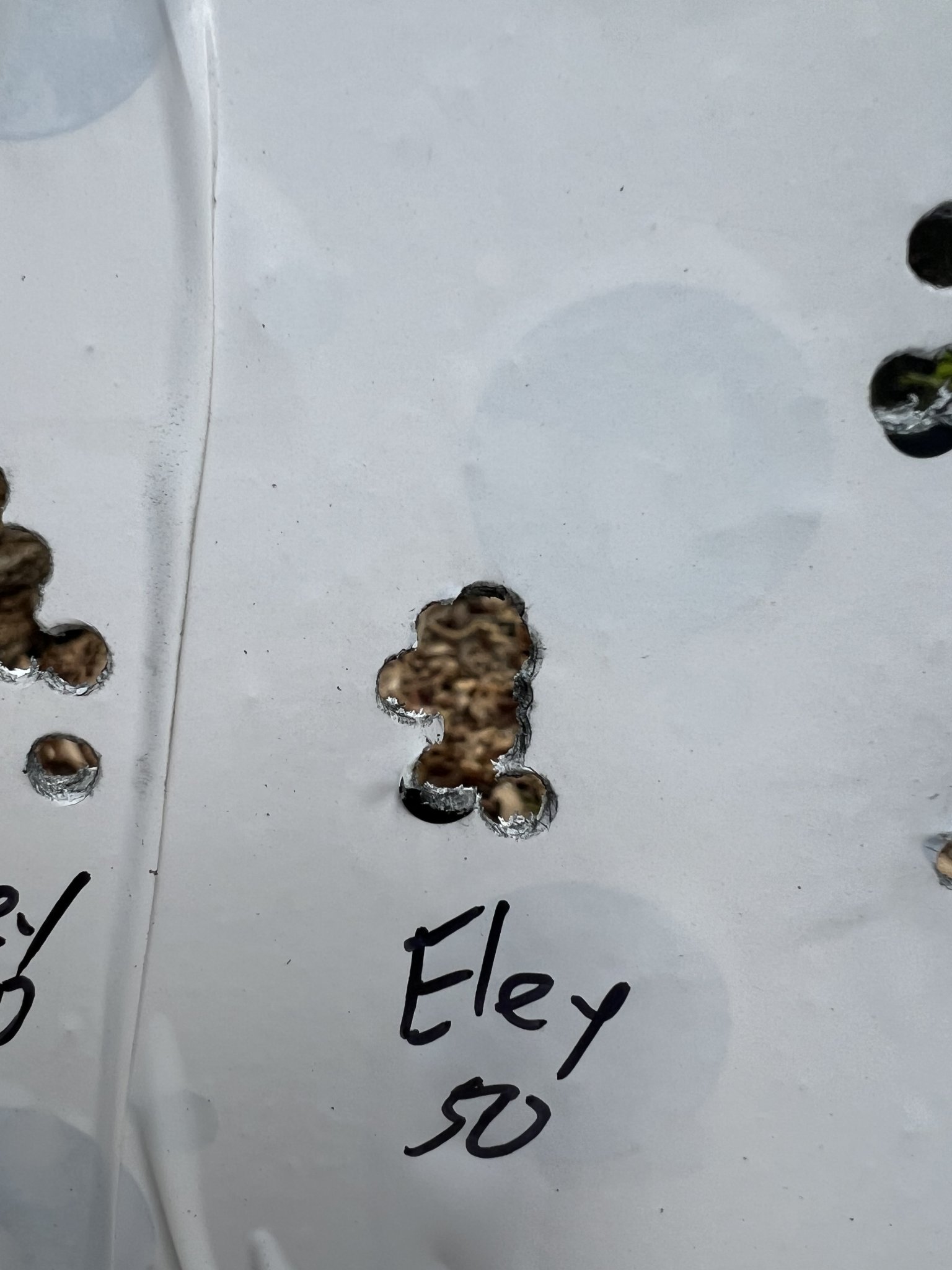

Thanks all for the input on this. The new barrel made a HUGE difference. The funny thing is, it didn't make a dramatic difference in how the Aguila ammo shoots. That had been the most accurate load with the old barrel but it still wasn't very good. Eley Match was noticeably worse. The new barrel dropped right on and now the Eley, SK and RWS is phenomenal. The Wolf is decent and the Aguila is mediocre at best. I wanted a baseline for comparison so I started at 36 yards but then backed up to 50 and the Eley Match quickly demonstrated why it has the reputation it does.
It is funny that Chris Way has been talking about blaming the equipment versus the shooter. I had been blaming myself in spite of the fact that I have a moderate amount of confidence in my skills. I thought that the poor performance was because a .22 was so much more finicky than a centerfire when it comes to fundamentals. I thought the rimfire was exposing things that the centerfire covered up. I'm now seeing that yes, the RF is a little more sensitive but not dramatically so. I have to give 100% concentration to keep it right but when I do, the results should show. I just needed the right equipment to let me see that.
