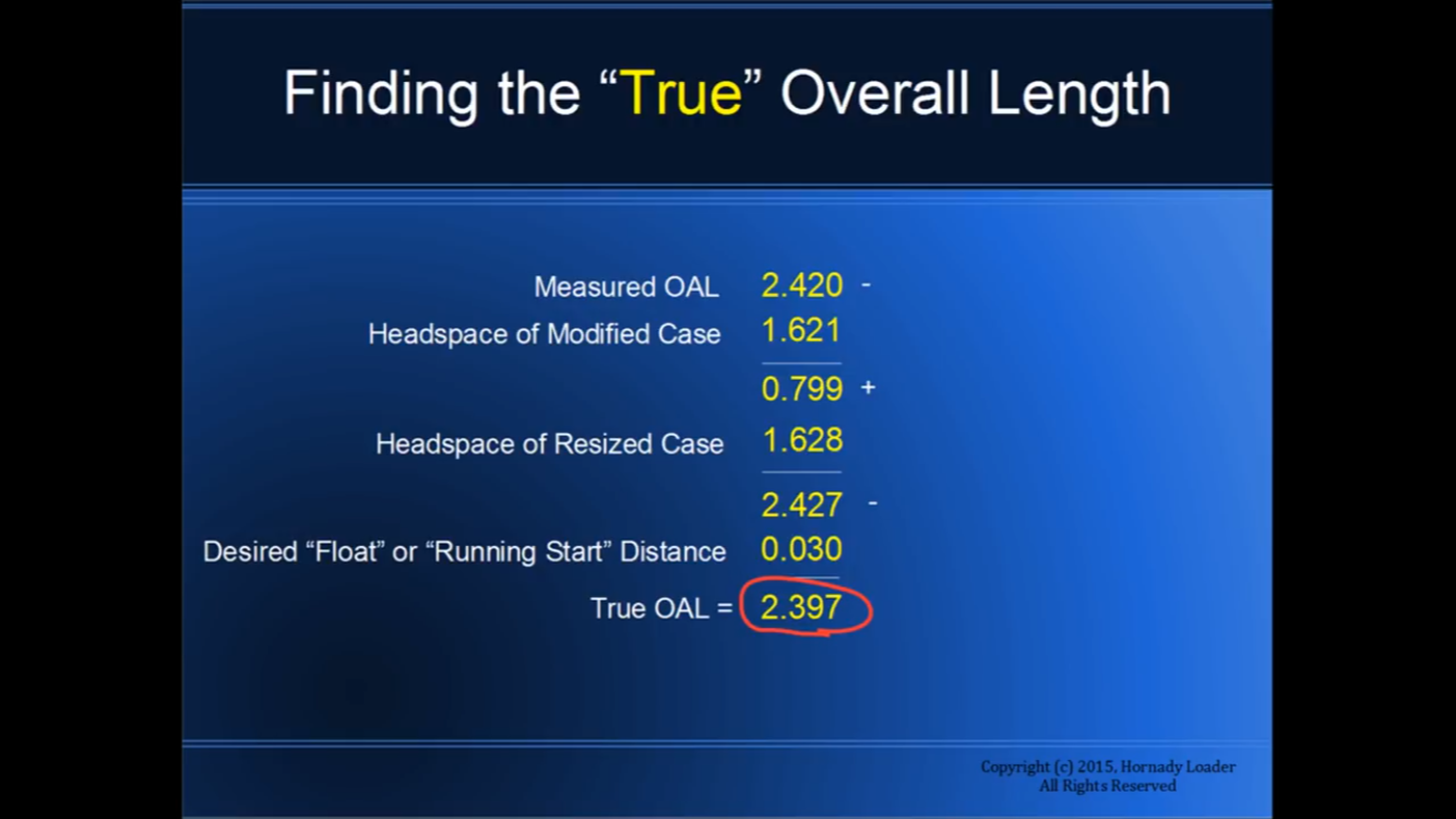

Next use the Hornady 308 case screwed onto the length gauge. Seat either an ELD-M on the case and push forward until it contacts the rifling. Use that case, calipers, and comparator, and anvil base to measure the base to ogive length for that bullet. Write this number down and repeat with an SMK.

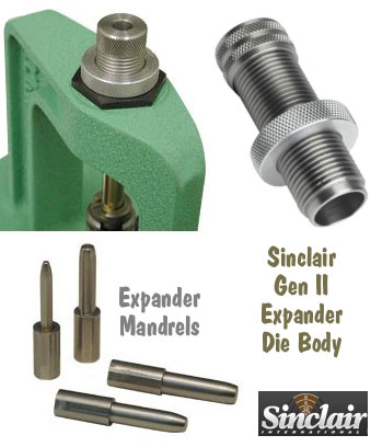

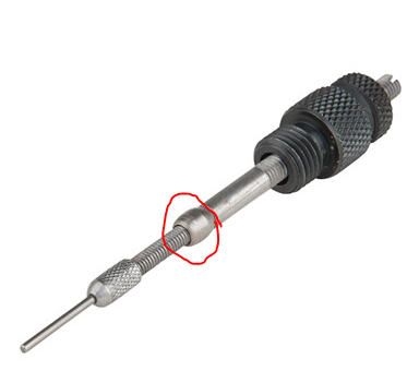

The expander ball and the expander mandrel do the same thing, just in inverse ways.
As a fired case is inserted into a die the expander ball slides through a fired neck freely into the case before the case has any sizing done to it. As the case is inserted deeper into the die the neck is sized down above the expander ball. When the case is removed from the die the expander ball is forced through the now smaller neck which now opens it up to the proper diameter.
The part circled in red is the actual forster expander ball, its typically bullet diameter-.002". Normal sizing dies typically size brass the internal diameter down to to .004-.010 under loaded neck diameter. The expander ball opens it up for the proper amount of .002" of tension.
You can remove the expander ball from your sizing die and instead use a separate mandrel in a second step. The case gets sized down like with any sizing die in the first step only instead of dragging the ball out of the neck when extracting the case from the die you instead force the mandrel into the neck (or the neck around the mandrel) to open it up to the proper diameter in step two.
So you cant do an expanding mandrel step "at the same time" on a single stage press, it will require handling the case for two sizing operations (twice as many handle pulls). With a progressive press you can perform multiple steps on multiple pieces of brass with the same pull of the handle. Not with a single stage. Just to clarify for you.
Traditionally the mandrels were used to prep brass for neck turning. The "expanding" mandrel is .001" under bullet diameter, the "turning" mandrel is .002" under. Now that we are using these mandrels for case prep beyond neck turning we actually use a turning mandrel, we just use the term expander mandrel as reloading lexicon slang. Its not the actual "expander mandrel" its just a "turning" mandrel used for expanding.
The turning mandrel and the expander ball should both be the same diameter and should give the same result. Many claim that dragging the ball out of the neck can lead to run out (off center necks), probably due to the different thicknesses of brass through out the cases body bending differently as they are pulled on. Forcing the mandrel down into the case should ignore the cases construction differences but instead keep the neck perfectly centered. Or so goes the theory.
That said Ive not noticed any differences on paper between using the ball and the mandrels but I will also admit to not having fully vetted that. I get good results from both. So this is getting into the weeds of bench shooting more so than for field shooting like most here do. When I get time Id like to run a test of the die with expander ball, the die with a turning mandrel, the die with a expanding mandrel and the die with only bushings but then of different diameters as well. But thats a lot of work and something I just hope to get around to eventually.

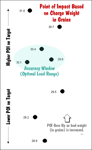

Any thoughts on testing for velocity nodes vs group nodes when doing load developments?
If you have access to 600 yards go for a ladder test, you see where close charge weights result in the same impact point on the target at distance.
http://www.6mmbr.com/laddertest.html

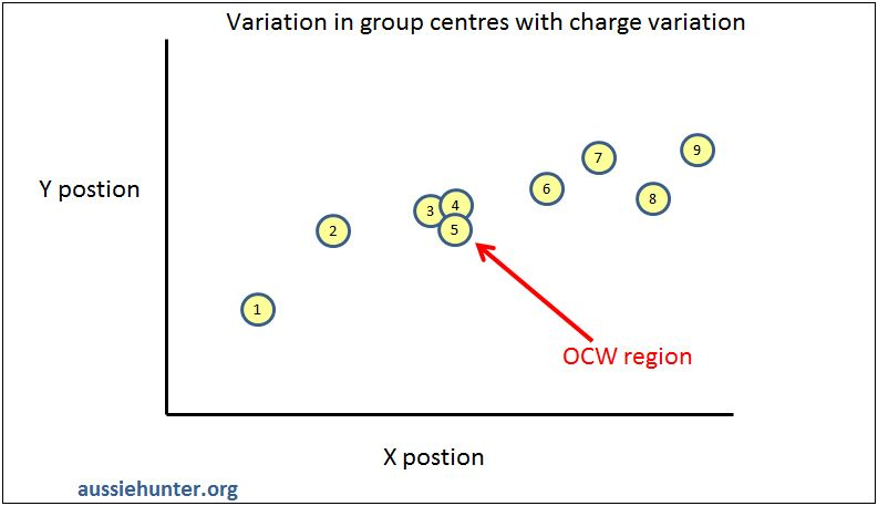

If you are restricted to 100 yards go for the OCW, you look for where close charge weights all have a similar point of impact to one another. If you laid all the different charge weight targets on top of one another you would be looking for where they are all the same location.
http://optimalchargeweight.embarqspace.com/ocw-instructions/4529817134
I use both depending on the wind conditions and whether I feel like driving out to the 500 yards line or if I just want to stay on one side of the creek. I even do a hybrid where I shoot a ladder only I shoot it three times and look where the groups line up instead of where the single impacts are.
Whatever you do, do it methodically and purposefully. Dont just shoot random loads and look for the smallest individual group, smallest group can be finicky and not reliable. The smallest group I have ever shot was not reproducible. You want to look for group center locations at first, not group size. Once you find a charge weight region where your results down range dont shift on the target with a tenth or two of powder then you can focus on seating depth to adjust bullet timing to make the groups smaller.
There is also the Saterlle method which many refer to as a ladder test... but its not. Its a chrono number test. They just go off of chrono numbers for a small sample size. If you have your process narrowed down and know from the get go where you expect stuff to work it can be a great time saver. Ive seen too many people claim that their SD was 3 for a three shot group only to find that it actually shoots like shit. I think of this are more of a process for people on their second or third barrel of the same type, theyve studied it enough and have it all sorted out so they dont have to adjust their variables. They know this bullet in this situation does x, you dont know that data yet for your system.
http://www.65guys.com/10-round-load-development-ladder-test/

You will have a target for each charge weight, it’s not one single aim point like a ladder test. I like to put them all in a row side by side. A 100 yard ocw at the same aimpoint would just be one big indecipherable pile of mess.
No, don’t adjust your turrets. Load a couple sighters just to make sure you’re zeroed close to your aim point. With ocw you’re wanting to see where each charge weight impacts in relation to the aim point compared to the other charge weights to try and map the barrel harmonics. Adjustments in the middle would ruin that comparison.
10 rounds? It’s a bit excessive. For my first round of ocw where I have zero clue about where I might find accuracy I will usually load a wide varrience of charge weights with three rounds per charge weight. But I can shoot this off my parents back porch and I do it every weekend. If you have to make an rare excursion to test then load up five rounds per. More data is always more informative. Smaller spacing between charge weights will further increase the amount of data to draw insights from.

Thanks, I’m going to just that. Should I be going to smaller increments than just 0.3gn? Maybe 0.2 would be better? Also all the stuff was ordered last Friday and is coming Thursday. But I’m still waiting for my full length sizer since it’s on backorder. If the virgin Lapua brass measures shorter when using a headspace gauge when compared with my once fired FGMM brass, can I load those without resizing?
.2 increments will be better if you have the time to make and shoot that many charges.
Yes, you can load lapua and fire. Once fired they shold more closely match your previously fired fgmm. Virgin lapua has tight neck tension so just be aware that when bullet seating is sort of tough thats why.
I’m going to do just that then! Find a starting charge, load 5, and go up in increments of 0.2gn! I’ll make sure to start a full grain before what my reloading manual says because I’m using Lapua brass

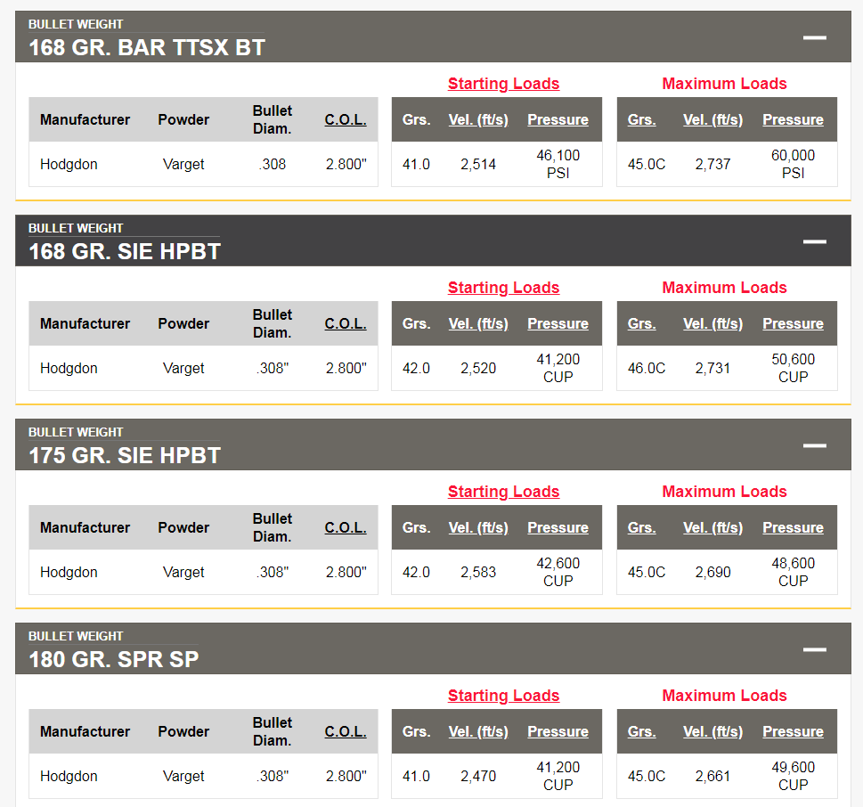

For 178gn bullets, there’s not much data. I should use 180gn data right? Because 175gn data may cause an over pressure?
5 grains difference wont be all that much, its only 2.5% difference in weight . The difference in bearing surface will play a much larger influence on the pressure than just the simple mass of it.
Here s a clip of varget data from hodgdons reloading center. Notice that for the 168s the difference in max load from a barnes copper bullet to a sierra lead core is 1 grain. Thats really due to the material differences in its bearing surface. Notice that for the lead bullets that the max is the same between 175 and 180 gr and that the lighter 168 max is only one grain higher. The lighter copper 168 is the same max as the heavy 180 lead bullet.
Obviously none of these are gospel so take them with a pinch of caution, work your loads up, your lapua will have a smaller internal volume than the thin wall winchester that these suggestions from hodgdon were based on. Start at 41 grains and work up until you find pressure. https://www.primalrights.com/library/articles/understanding-pressure

Id like to make a small recommendation to your process that I learned from a youtube video about the Hornady OAL gauge. The guys channel is Hornady Loader , however he is not affiliated with Hornady in any way. At the end of the video he talks about using the modified case as you mentioned above to get you OAL measurement. He points out in the video that more than likely your brass will not be the same size as the modified case so in theory you will not actually be .020 off the lands when you load your Lapua case. You have to take a headspace measurement off of the modified case compared to your lapua case and subtract the difference to get yourself a true .020 off the lands. It is somewhat hard to explain in this txt but i recommend watching Hornady Loaders video of the OAL gauge and towards the very end of the video he explains what I am talking about. He sound like an older gentleman in the video so you know you have the right one. Hope this helps.
Got around to watching that video, and it ends up my new Lapua brass has exactly the same headspace. Or should I be measuring off my once used FGMM brass instead?

that’s what I used to calculate, but my virgin Lapua brass was the exact same as the Hornady Gauge. Maybe I should use the measurement of one of my once fired FGMM rounds, and deduct 0.002”. Because that would be my actual chamber size -the shoulder bump

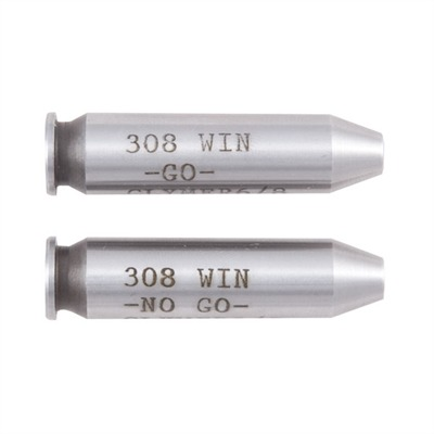

Does your virgin brass fit in the chamber? If so dont size it anymore, all that will do is shorten its life.
The only reason to ever size virgin brass (beyond mandrel neck expansion) is if you have a short chamber and it requires you to do so. If your go headspace gauge fits in your chamber and your brass matches that headspace gauge (shoulder angles etc set aside) then you are already short of your max headspace and all sizing it more will do it to make it stretch more on firing.
Edit: On going back and looking at the video I see what you mean, the modified case matches your virgin brass, not a gauge. I was thinking a head space gauge like so
But the if your brass chambers my "dont size it anymore" comments still stand. That is looking for bullet seating depths, not shoulder locations. To figure out your shoulder measurements, note the vigin spec just to have it recorded, sure, but what you care about for resizing is the fired lengths.
I skip those hornady rods and just use my chamber to tell me
Gotcha, I think I understand what you're saying. Yes they all chamber just fine without sizing. Measuring my shoulder, my once fired measure 1.6280 and my virgin Lapua measure 1.6240. But according to the formula, shouldn't I seat my bullets according to a 1.6260 (once fired - 0.002) since that will be the case as soon as I fire the brass one time? If I seat it according to the virgin brass, I'll actually be jumping an extra 0.002 since the virgin brass is 0.002 smaller than my once fired and resized brass would be?
And damn I wish I saw that technique before buying the Hornady gauge

It says that min is 42.0 and Max is 45.0 for Varget. I was going to start at 42.0 and work up in 0.2 increments. Should I start at 41.0 and max out at 44.0 then?
You definitely could. I would just start at 41 and go up in .4 or .5 increments up to 45. If you wanna just shoot more, then go up in .3 increments.
