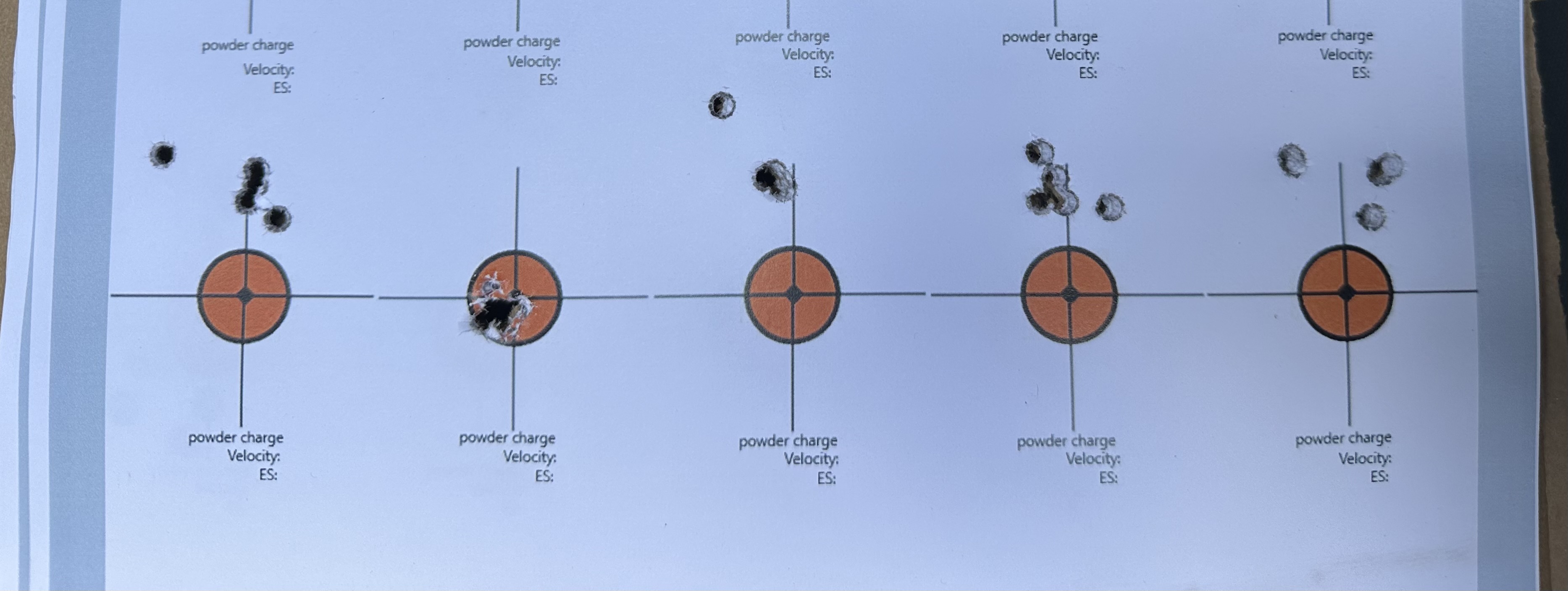

I use Federal Automatch. I just tested out different ammo in my new CZ MTR last week and it actually was the best out of that rifle compared to Eley, SK, Wolf, and RWS. SD wasn’t the best but it grouped well out to 200 yards.

Second group was Federal. The rest was Eley. I wasn’t even gonna try the federal, just had it to use to get an initial zero.

Oh, so at 50 yds. Ok, less surprising there.
As a side note, those other groups are appalling. Something’s not right there.
I don’t have group pics at 200 but the federal still did better than the Eley. SK did a little better than federal maybe at 200. SK did almost as good as the Federal at 50.
I was wrong on the SD. SK had the SD under 5 and Eley was 10 something. Federal was 21 something.
This was at 50 yards? Something isn't right. What rifle are you shooting this out of? What headspace are you running?
Its been a while since I setup my rifle, so I'm going by memory; but Eley has a relatively thin case rim and my rifle does the best with Eley when the headsapce is at .038 or less, with the best being when I set headspace with a .037 headspace. I chose to setup my rig with a .039 headspace because that is appropriate for SK ammo, which is what I shoot the most of. It was a happy coincidence that this headspace also accommodates cheaper ammo, like Federal Auto Match.
I shoot a lot of Auto Match. Its cheap and it runs well in all of my semi autos. I've had results with the Fed that ranged from spectacular to meh. Performance varies greatly from lot to lot.
As far as the big SDs with Eley goes, my theory (and it's just a theory) is that when running eley with excessive headspace, it leads to inconsistent primer ignition which leads to the velocity variance. You can test this in your rig by paying attention to and trying to chamber rounds in a consistent manner.
For reference, I run a CZ 457 with a Lilja barrel. These barrels are spun up in a manner intended to allow the end user to set the headspace. If you have a similar setup, I would suggest getting at least one headspace gauge at say, .039 to at least give yourself a solid reference point from which you can experiment and take note of the difference headspace makes.

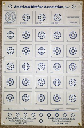

I also like to practice on ARA 50 yard targets. The ones where a score of 2500 would be a perfect score. With SK Semi Auto, which is a cheap ammunituon, relatively speaking, and my rifle setup to shoot it, I score 2350 or better 80% of the time with perfect scores happening often enough that it doesn't surprise me when it happens.
With the scores your mentioning, I assume you're using the Factory target?
Well, that is the Unlimited target, guys with $4-5k rifles (me for one) would love to say that we shoot 2350 or better 80% of the time. I recently shot a 2300 with my Lilja barreled 457 and was thrilled. You should compete in ARA unlimited. Oh, did you plug the close ones
Edit: I actually missed the perfect score part. I shot a 2500 last November, it was the 5th 2500 shot in Florida since 2012.

Oh, there was a time when I lived and breathed rimfire. I didn't have the time or money to compete in anything but my local match, but the competition at my local match was fierce. We had a few pretty renowned shooters showing up with those $3k+ rifles. Custom Anschutz and other custom actions that I don't remember the names of. I was shooting a Shillen barreled 40x in a McMillan stock, with the action glued to the stock. I think I was running a Jewel trigger. Rimfire can get pretty sick, even on a local level.
The guy that ran the match, in an effort to level the playing field, required that you run the supplied ammo. That was Wolf Match Extra. If I recall right, that was the equivalent of SK Rifle Match, back when SK was loading for Wolf.
Someone shooting a perfect score was not unusual, nor was counting "X's" to declare a winner.
In any case, you do have to take what I said about my results with a grain of salt. What you can do in practice does not always directly correlate to what you'll do in a match. You can't choose your match conditions. What I said above applies in good conditions with little wind and is more of a testament to the capabilities of the equipment than my skill.
Yes, I do plug the close ones and either it broke the line or it didn't.
These days I just shoot for pleasure and to compete against myself and my friends with my trusty CZ457.
Anyway, I think the point I was trying to make is that you can find accurate ammo, even cheap ammo that will shoot accurately. What you pay for with expensive ammo is consistency from lot to lot and within each lot.
You can't buy a box of cheap stuff, find that it shoots well and declare that that ammo shoots well. More often than not, cheap ammo is going to varying wildly from lot to lot.
I see lots of guys that swear by CCI SV and Norma Tac 22, and yet when they put it down on a score card they can't understand it when they drop 500 points on a card after having shot all of those 1/2" groups. Of course, at least some of that is shooter error.
Still, I have run across some stellar lots of Federal Auto Match. I get it by the case to run through my semi autos, but I always test them in the bolt gun. When I find a lot that does decent in the bolt gun, I set that aside.
