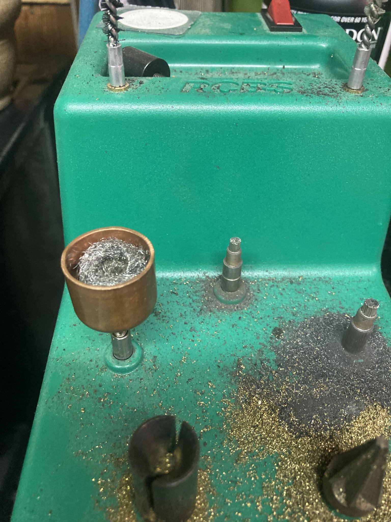

    2. Brian's comment about dull chamfer tools creating burrs that scratch bullets was interesting. Early in my reloading, I noticed that when i seated a bullet I would find copper flakes on the case mouth that had been scraped off the bullet. At the time I was using a cheap chamfer tool. I found a suggestion on Varmint Al's website, where he recommended polishing the neck rim with steel wool after chamfer/debur. I adopted it because it made sense to me, and because I could actually see that it smoothed out imperfections in the case mouth left by the chamfer tool. No more scrapes, and the bullets seat very smoothly. I have always wondered if this impacted the precision of my loads. My SD's are never very good, but the chrony is suspect. The performance of my load at distance is better than the SDs would suggest it should be.
    Below is a picture of how I polish the necks on my RCBS Trim-Mate. Drilled a hole in a copper pipe cap, attached it to a properly threaded screw and stuffed it with fine steel wool. I give each case about 10-12 revolutions in the wool. Maybe I've been on the right track with this!
