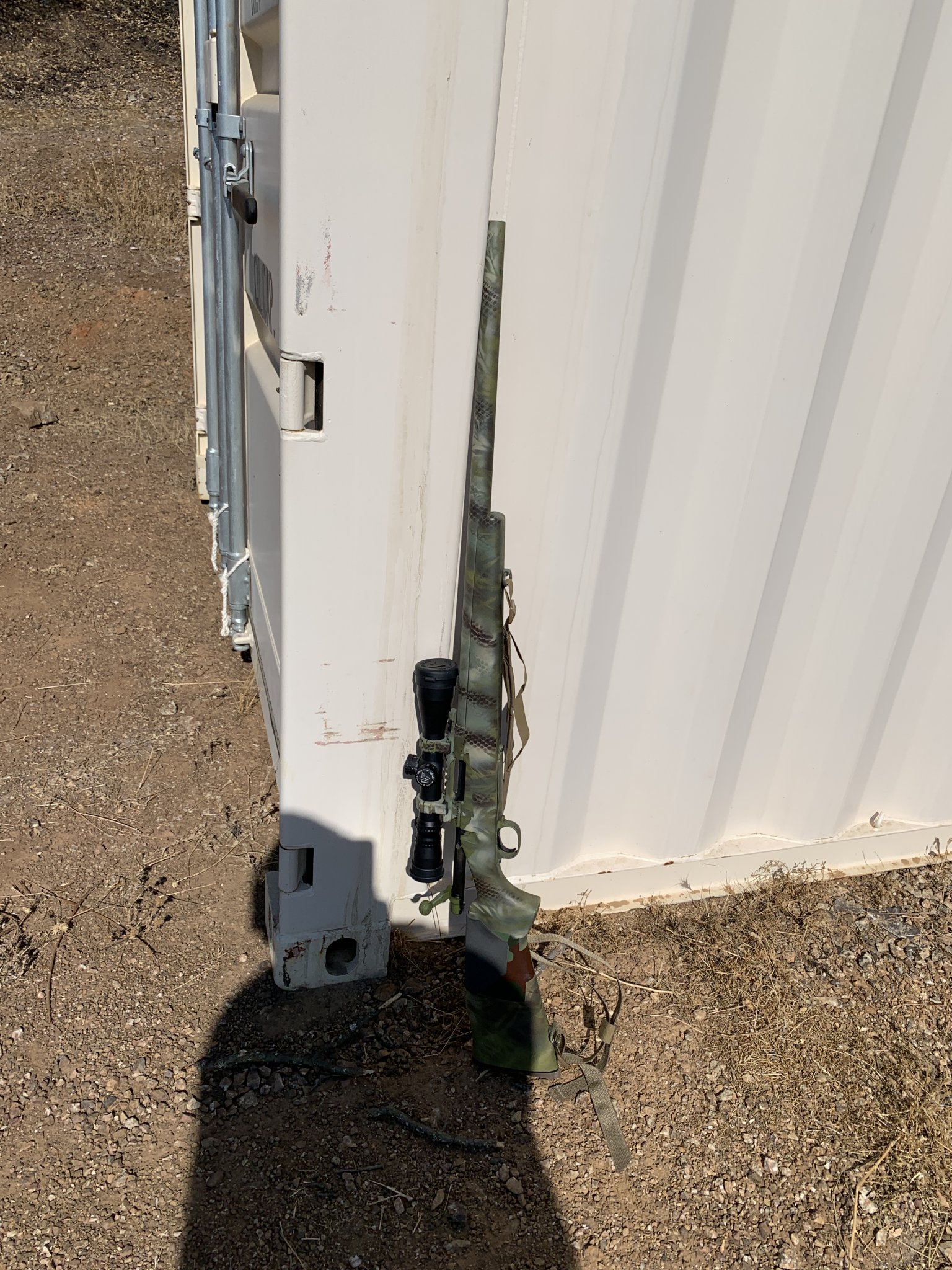

    Really enjoyed the discussion about what makes a “hunting” rifle. I was laughing listening to Frank relate a M40A1 to a hunting rifle as guess what, I am using my GAP M40A1 as a hunting rifle this year (with a improved NF 2.5-10 over mst so maybe not the same but meets the intent).

    Anyway, rant over. Keep up the great work on the podcast. Oh, and here is a pic of the “non hunting rifle”.
