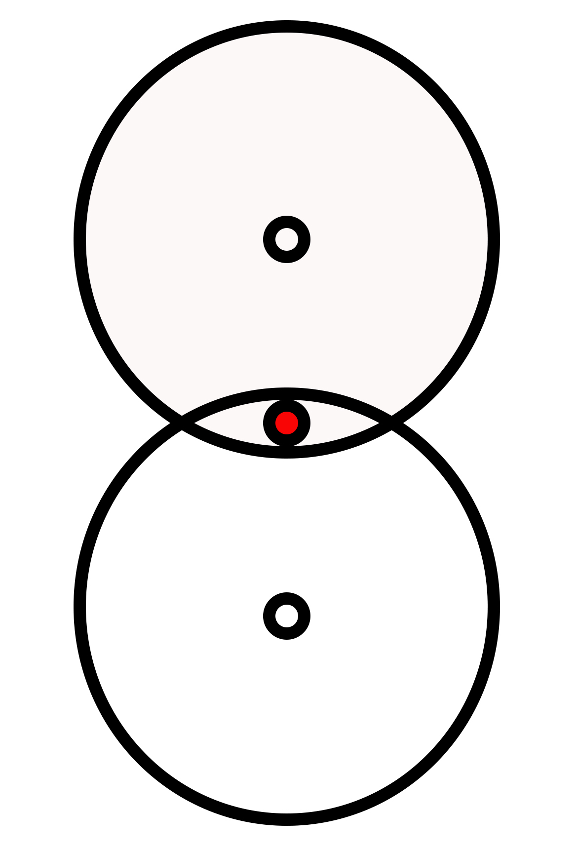

Woke up last night wondering how much it really matters if your zero is off by a bit for PRS style shooting.

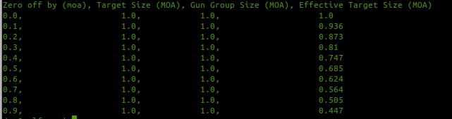

Couldn't get rid of the itch so wrote a little program to figure it out using basic geometry.
You can compute a relative target size by looking at the % coverage of two overlapping circles.
First circle is target size (lets use 1moa).
Second is the 6-sigma group size for your gun (lets also use 1 moa, because your 3 shot .5 gun probably more like a 1 moa for 999/1000 shots).
Note that it doesn't matter if your zero is .1 high, right, left, or low.
The relative target size is all the same as long as you measure straight from the center of target to center of your group.

Above example is 1moa target, 1moa gun and being off by .1 moa on your zero is about 6.5% smaller effective target.
If you plug in the numbers for a 2MOA target (more typical PRS) and 1MOA gun, your zero can be off quite (0.5 MOA) before you see any degradation in effective target size.
However if you have a 0.5MOA target for a 1MOA gun on a KYL rack, your effective target gets a lot smaller than 0.5 MOA really fast if your zero is off.
Even with a dead nuts wind call, your zero better be inside .1moa
So for 95% of PRS shots, being off .1 or even .2 mils on zero is totally fine and barely hurts your hit probability.
If you're hunting those last few points on a KYL after hitting all the others, then it suddenly matters a lot.
Makes me wonder why guys are ever trying to "tweak a zero" on the zero check unless they've dropped the gun on the way to the match.

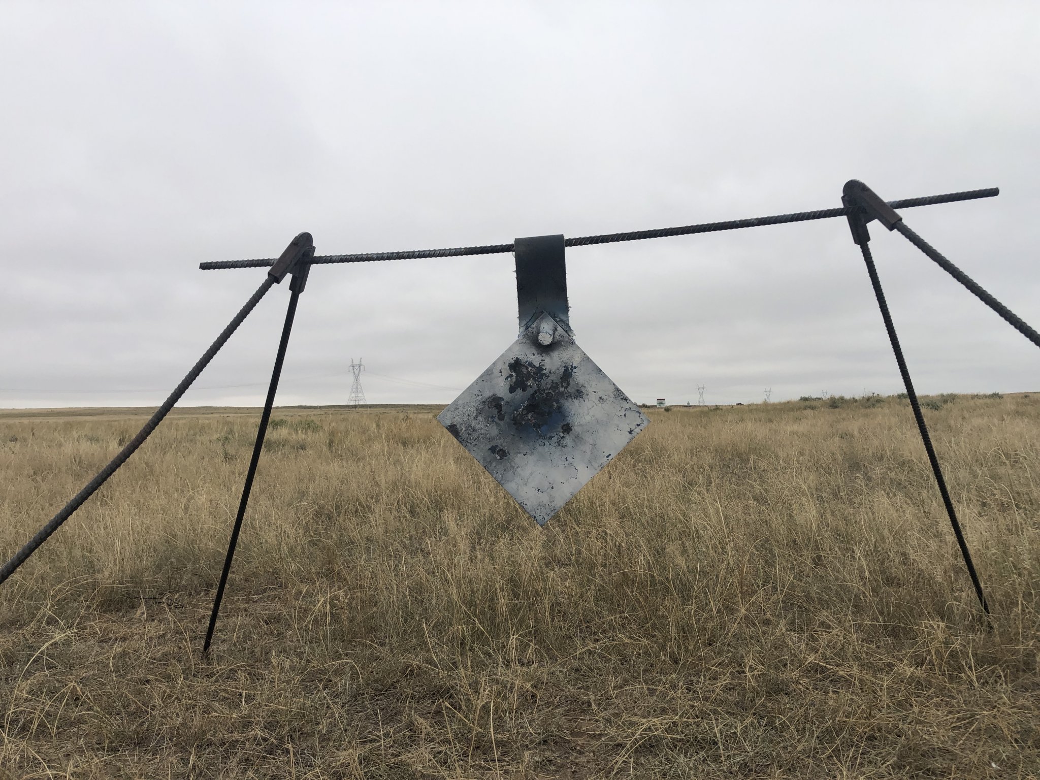

Lastly on Snell's Law,
In Alaska, with their high moisture content in the air, we see a .5 Mil shift at 1000 yards, it lasts just about an hour, maybe a hairless, but one minute you are shooting center on a plate at 1k, the next minute you are .5 mils over the top. The sunlight and water content in the air does crazy stuff, then as fast as it happens, things go back to normal.

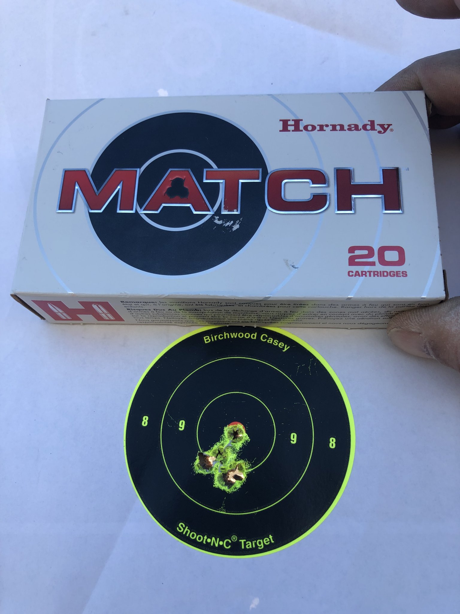

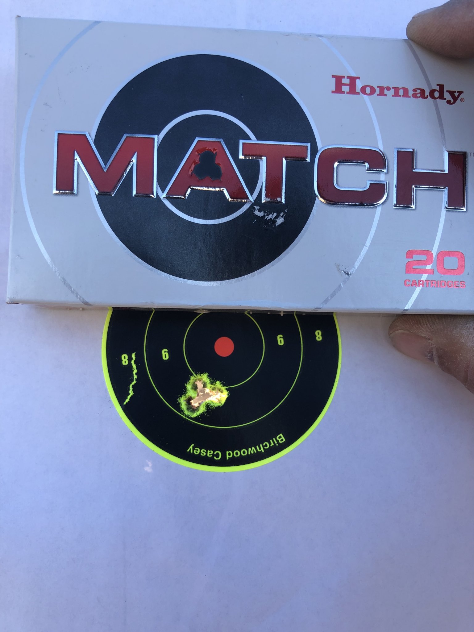

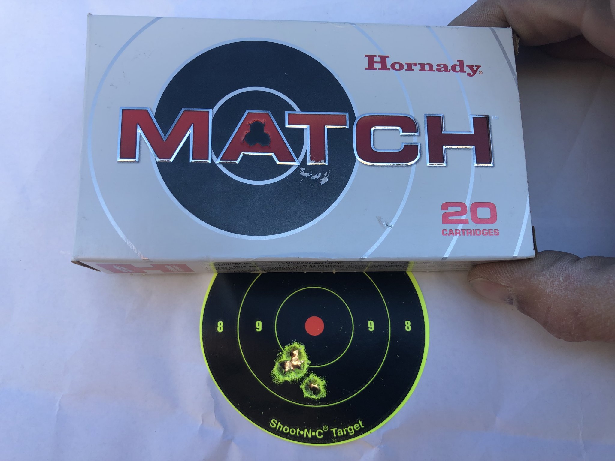

I wish I had more images of the 100-yard groups from students, I know I have a "bunch" but I wish I tracked one student or one single group over the 5+ groups we shoot in a class.

Studying the True Range Zero can be helpful to see just how big small variations can be, a 1/4" here or there throws things around a lot. The bigger the plate, the more wind you deal with, the easier it is to hide it, but it's there.
Just a quick scan of my images on my phone and I found this, group shooting my Valkyrie,
Following the order of images from my photo library:
Group 1
So about 7 Oclock on the 10 ring,
Group 2
I opened up a tiny bit but still roughly 7 Oclock elevation wise seems pretty good
Group 3
I see enough vertical variation on my groups that it might translate to .1 or .2 here or there.
I could easily say are they consistent, but then again, they are noticeably off.
Personally, I think it comes down to the quality of the dope, the range as presented, and then the target size. In 99% of the cases, we probably can hit a 2 MOA no problem because are looking at 1/8" variation, but I would think I am consistent enough in most cases.
