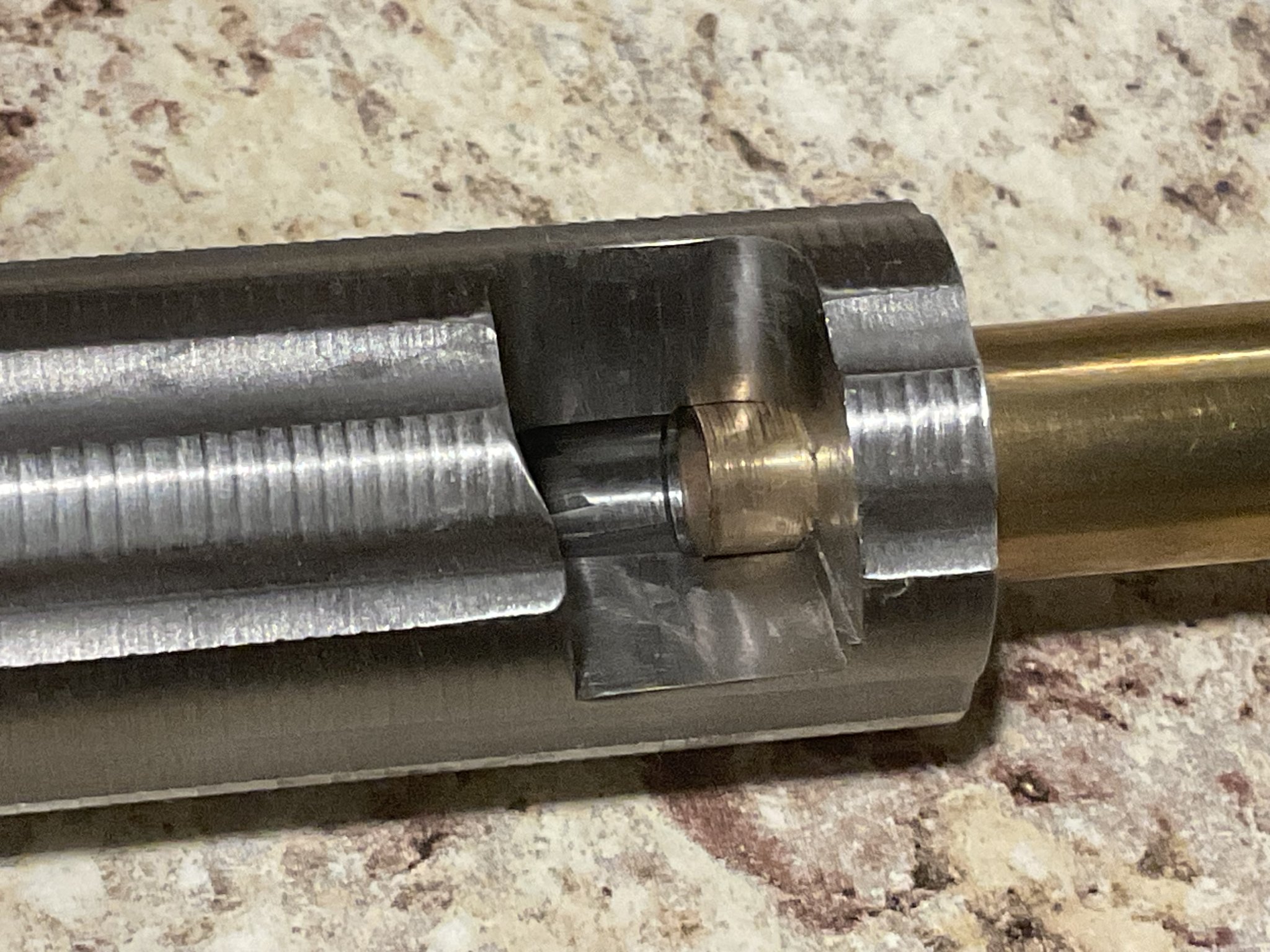

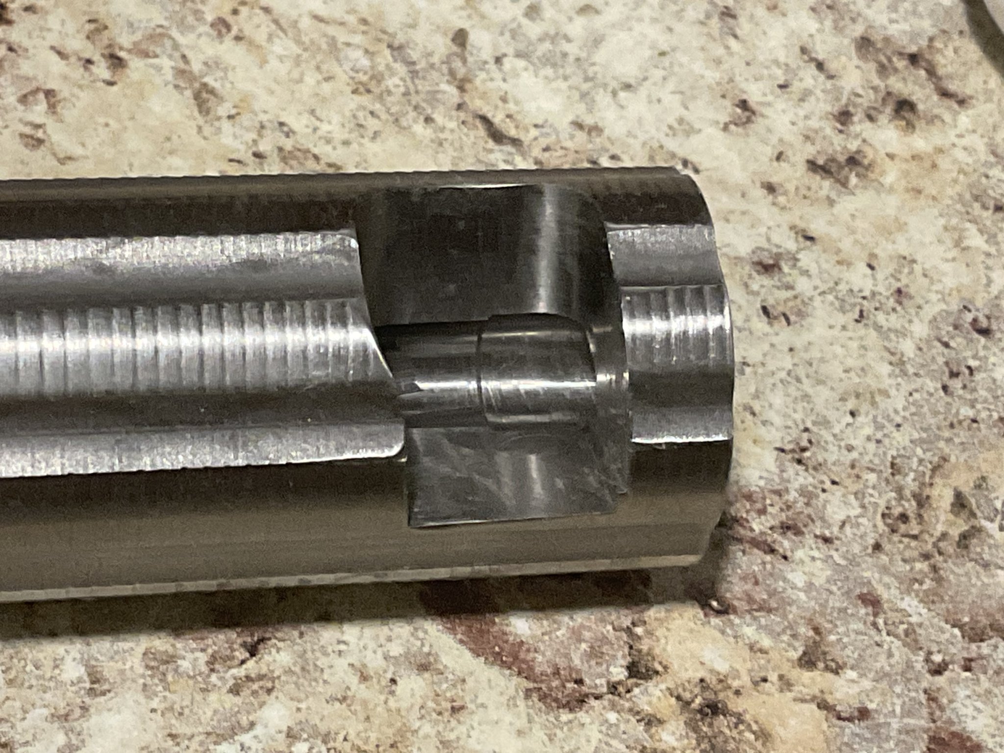

    Eventually, your brass will grow until it impinges on the front of the chamber. After a time, the case mouth will get squeezed, by chambering pressure, around the seated bullet and your groups will go weird. It might take some time depending on how you are sizing and your chamber dimensions but absolutely not trimming is not an option if you are shooting your brass many times. The good news is that 6.5 cm won’t grow that fast. If you have a borescope you can put a piece in the chamber and look at the case mouth in relation to the end of the chamber.
    Here’s a pic of the offending area from a cutout chamber. Once that gap closes up, you need to trim.
