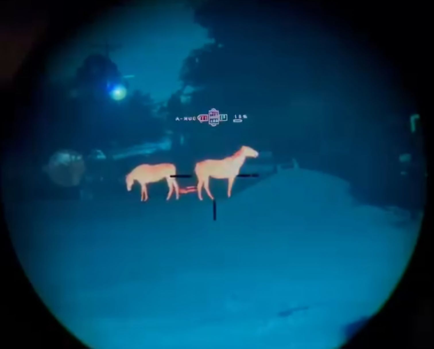

I'm probably most excited about this one personally. The size/performance ratio on this guy is outstanding. Fits in my hand but with an 8 degree fov it can easily take 10+ mag. It doubles at a stand alone optic (1280 amoled display in Stand alone mode). It has mil based reticle that scales with magnification. Full color display with outline modes(colored). 50 cal rated. Small enough lens that it has and inline (non folded optical bench) which helps reduce image shift. Stand alone mode has an optional PIP mode which is not common on mil sights. Utilizes the new BOSON PLUS core from FLIR. Has IBEAM protocol so will be able to link with LRFs. Can be ordered with the standard Larue mount or an optional locking Flip Mount....both of which are 1.54 Height mounts. Weighs 19.2 ounces with batteries. We ordered our units in FDE Cerakote. (the lighter one in the pics was rattle canned). These will come in at a $13,499 price point with the standard fixed Larue mount. This is the ultimate balance of small size/weight and performance. It is taylor made for a LPVO setup and small framed LR guns like a 6ARC gas gun.

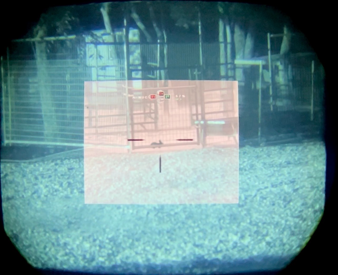

below is a cell phone pic of stand alone mode with pip enabled with mil reticle 2x main display 5x PIP (2.5x2)

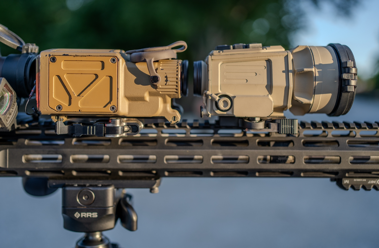

SIze comparison next to Gen 1 X-ELR eotech

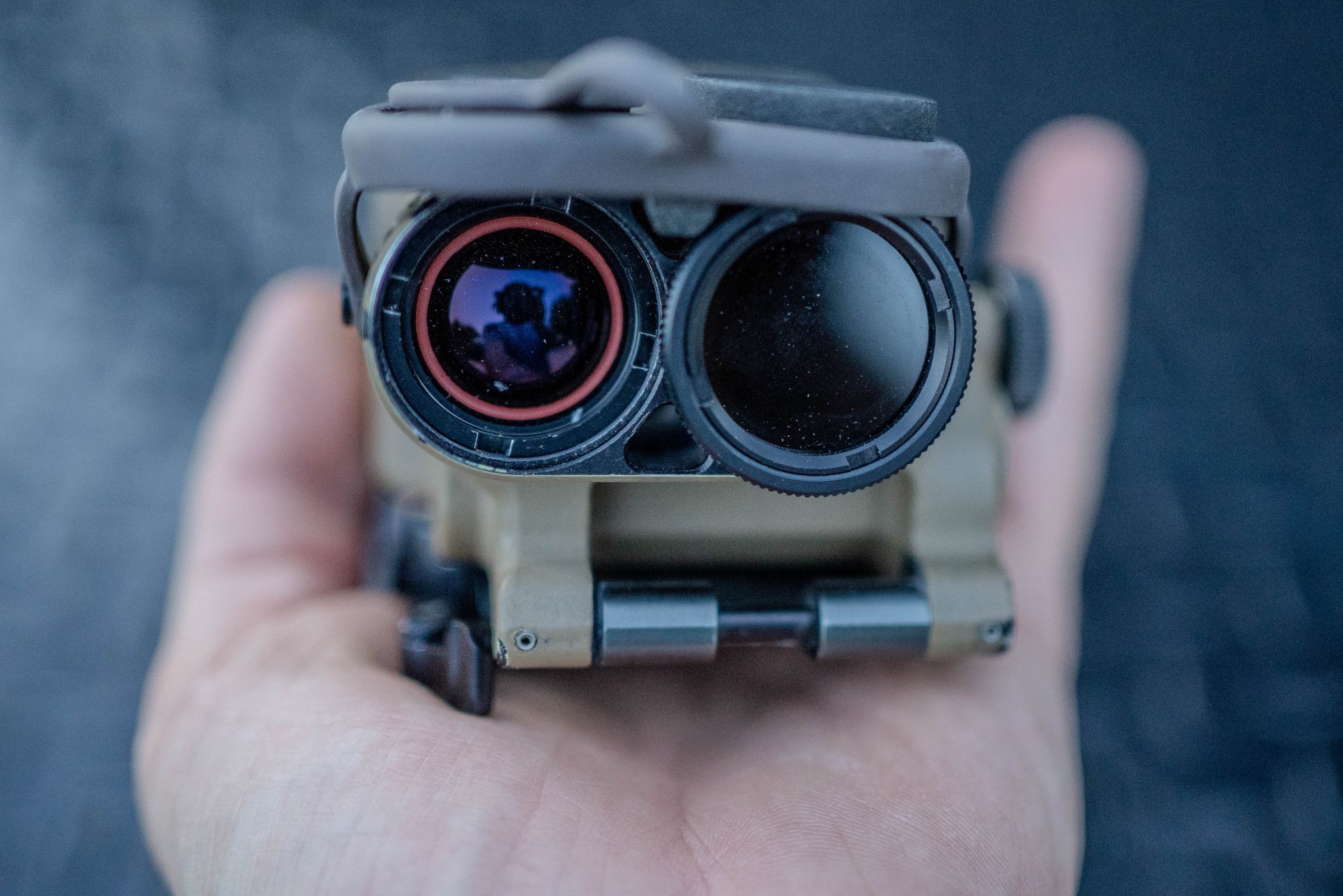

2. TALON II Fused weapon sight
This sight packs a bunch of tech into a small footprint. Its only 5.5 inches long and 20 ounces. It is fixed focus on both channels and it was designed around 1-6x optics. The thermal is considered an aid to the Image intensifier. It is a 320 FLIR BOSON plus sensor so that the FOV is matched to the 16mm high fom 4G photonis I2 and so the lenses remain small. It will operate in NV or thermal only modes but it is best used as a fusion sight. I'd say considering the small optics it is a 400 meter or less device. It is like an ADUNS for a carbine. At $22,750 its not inexpensive but its closest competition is the $60k FLIR ADUNS. We have a few of these arriving in Sept. These are a program of record with several EU Mil customers. Taking Deposits.

Getting an accurate representation of image quality through a clip on is always a challenge. I'll work on it though.
Of course ..if anyone who is in the Austin /San Antonio area you're welcome to stop by our showroom and look through our demo units
How do these compare in image quality, value, and weight compared to the 2nd gen Eotechs? These look very interesting...
Well the closest comparison would be with the 2nd gen LR version of the EOTech. My main issue with the gen 2s is that, other than the xELR, they all have a rotating lens assembly. I'm not a fan of that generally. It can create issues of image shift when you refocus. It isn't an issue with lower mag(wide fov) units like the SR as much as it is with tighter fov units that will be used at extended ranges. The XR above is a fixed lens with a focus collar. All of the Excelitas units feature fixed lens assemblies. Beyond that, the XR utilizes the recently released BOSON + core....all of these are specd at sub 30netd so very sensitive and have latest chip tech.

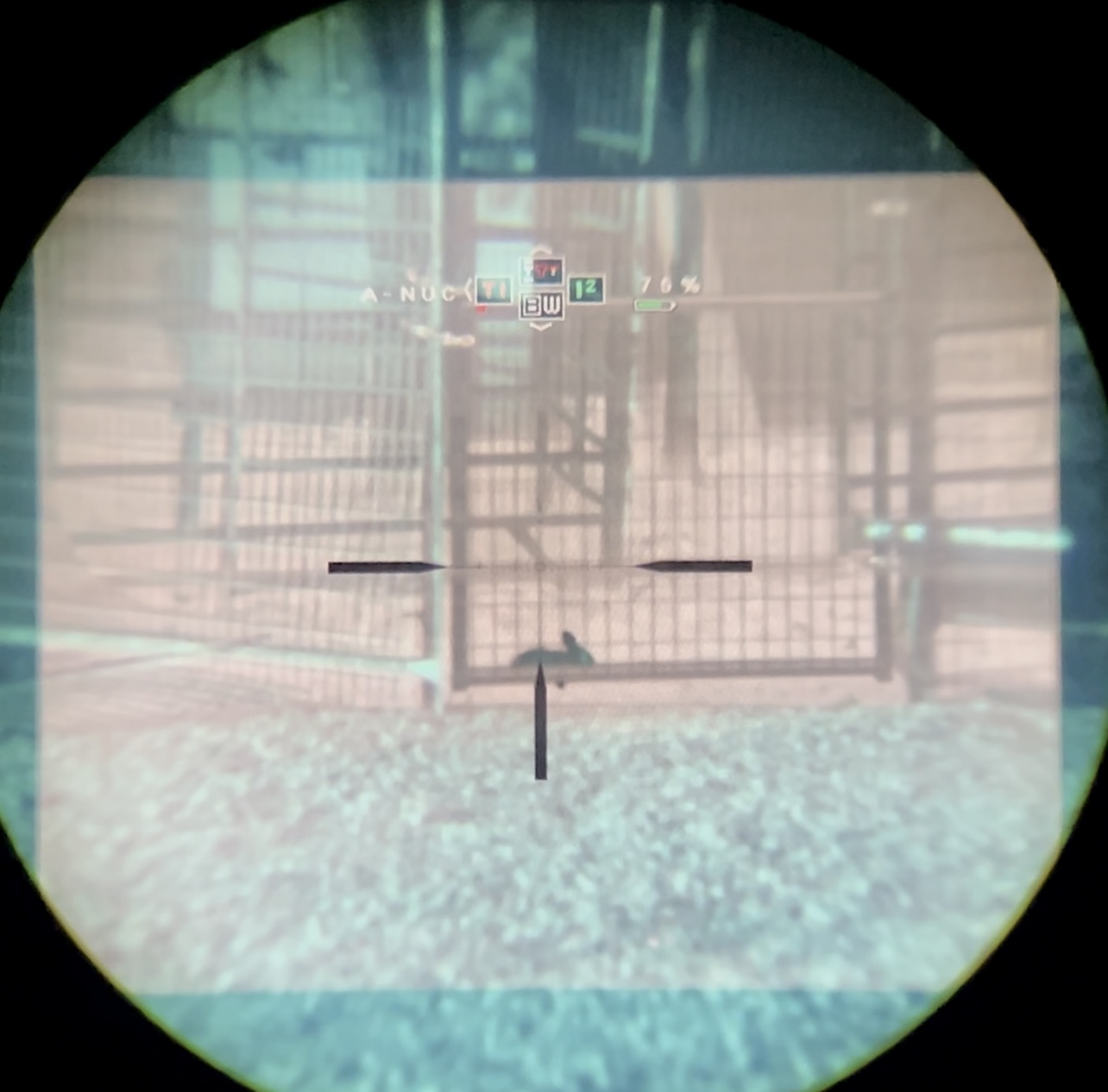

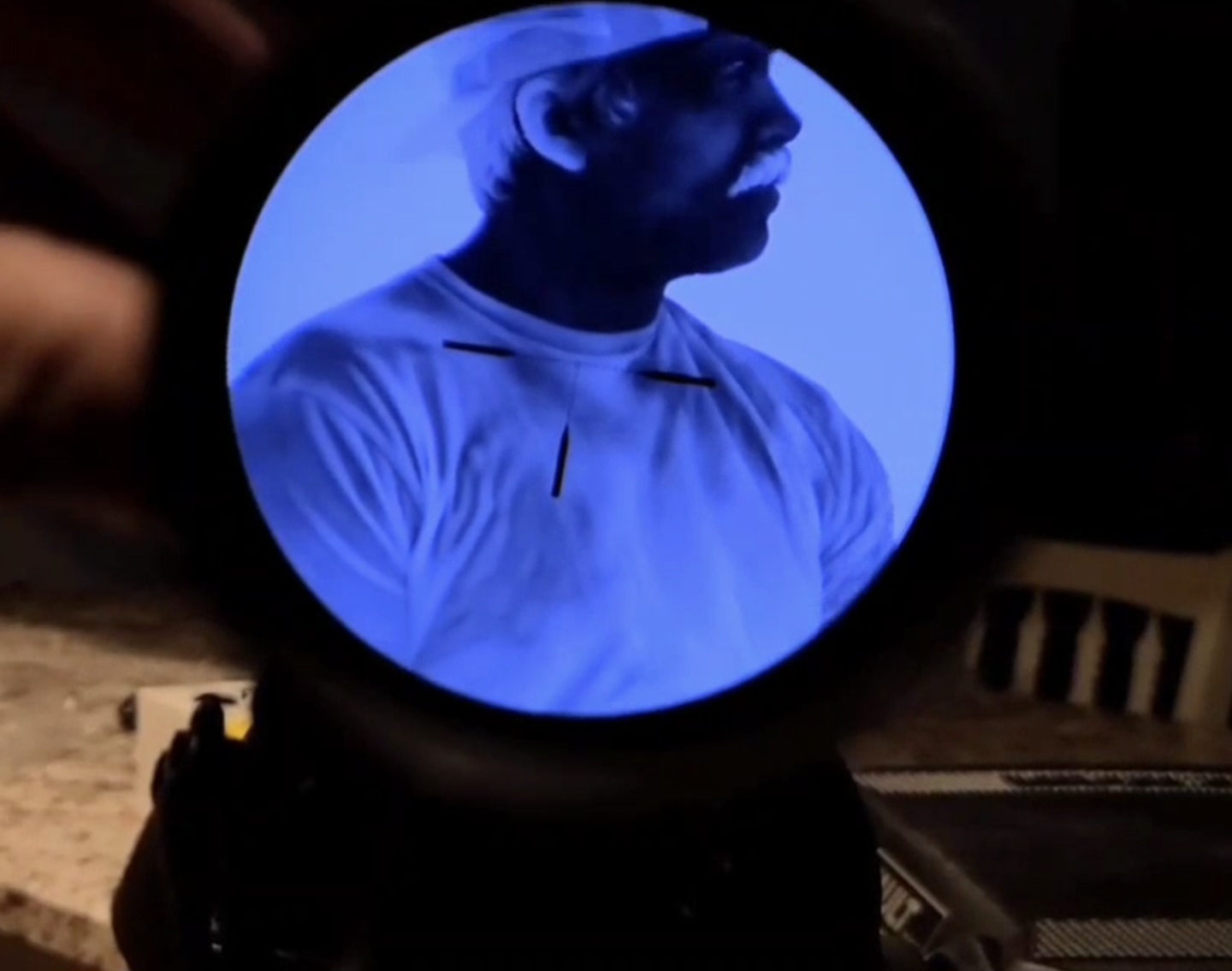

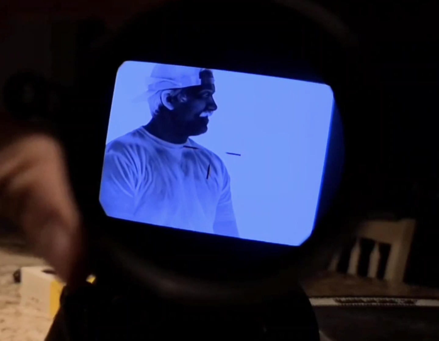

The overlay offset looks about as perfectly aligned as anything I’ve seen.
Heart say 320 = BOO! But brain says “that actually looks pretty good!”
Per usual, iPhone through LVPO through Talon II doesn't do it justice. I was struggling to get it to stay in focus while button pressing.
While maintaining this small a form factor, you pretty much have to go with a 320. A 640 lens would be double the size which adds weight and mass.

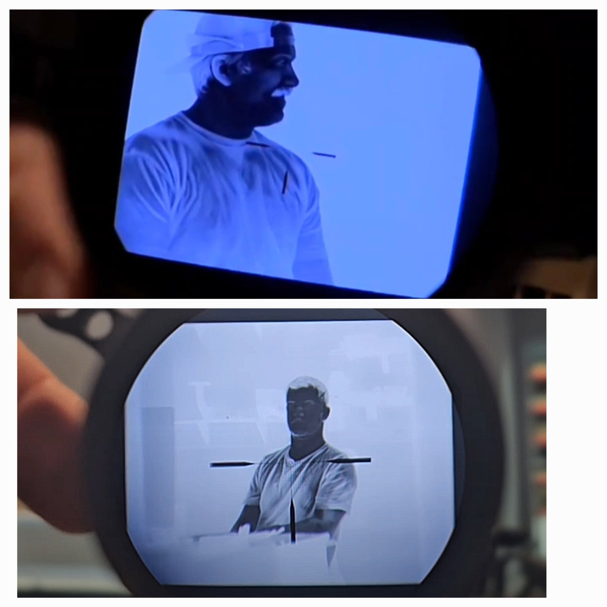

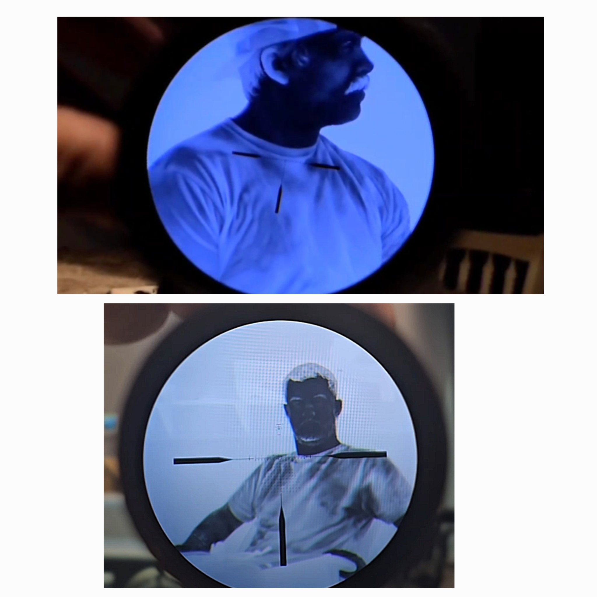

Judging from the video, it looks very Voodoo S like on human targets. I took a video of my buddy with my Voodoo s and it looks identical to Dan's video of the Dragon.

Also, here's some still shots from a video of the voodoo s looking at my buddy in the same conditions as Dan's video.
