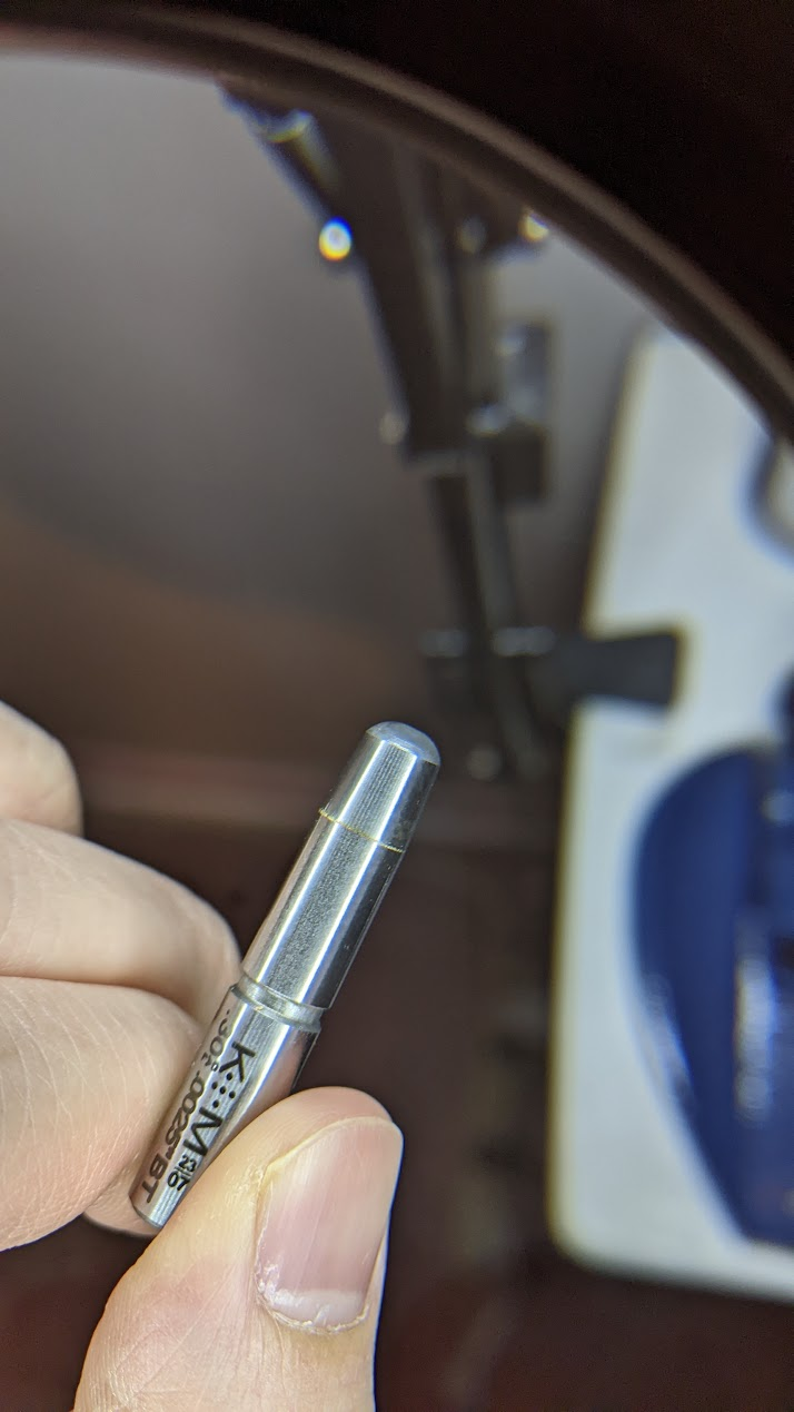

Hello, thanks for the reply, fon now I don't wanto to turning the neck, maybe I make a wrong thing, but for now only neck tensione.
Just a heads up, as it'll get confusing if you're not aware. When people say "turning" and "expander"......historically, mandrels were almost solely used to expand a case before neck turning, and then as a pilot for neck turning.
Expander mandrels are .001 under bullet diameter and Turning mandrels are .002 under bullet diameter. So that's what people mean when they use the term expander or turning mandrel. Once shooters started using these two types of mandrels to set their final interference fit and not just for turning, companies started making mandrels in sizes other than .001 and .002 under. These other sizes are just referred to as mandrels and their size given.
But, you will still see retailers selling expander and turning mandrels as well as reloaders referencing them as such when talking about .001 and .002 under.
I have had good luck in 6.5CM with a 21st Century black nitride turning arbor. It's 0.002" under bullet diameter. For some reason the 22-cal turning arbor (0.222" diameter) didn't work the same, so I went down to 0.221" in stainless. I will likely have a custom carbide mandrel ground in 0.221" at some point, the stainless galls up and I have to clean it off every 50-100 cases.

This is awesome if it’ll work, I could find carbide pin gauges far easier than mandrels
If you end up with something like a Porter or other collet die and want to get your own pins, keep in mind you'll probably need to either angle or round off the end going into the case mouth. Just using flat end gauge pins, you'll have to go slow or physically line up the case with your hand, otherwise the pin will hit/damage the face of the case mouth.
How would the OP do that ? Just in case he does not know, an easy explanation would help.
I have PMA and 21st century. Some are stainless and some are the black nitride. The black nitride is the way to go, or carbide. The stainless is just not as smooth and slick as the black nitride and If I don’t do a good job lubing the necks I can feel it.
I also use the turning mandrels (.002 under bullet diameter).
Reactions: RTTY
I use a small belt sander and a cordless drill. Put the gage pin in the cordless drill, spin it in the opposite direction of the belt sander and sand/grind the end of the pin to a gradual taper about 1/" long. The using a polishing wheel on a bench grinder I polish the gage pin to a fine finish. If you don't have the needed equipment to do this then buying the tapered pin gages from PPP ($10.00 ea.) is the way to go.
A lathe is another option.
Reactions: Haney
Don't mind him. He's not actually asking a question. Just being an asshole.

I have the K&M V2 both two row and three row. The mandrel holder/vertical fine adjuster works for both. The hash marks/indicators on the mandrel holder is a nice detail, but it is kind of a gimmick. The straight portion of the mandrel itself is long enough that you really don't need hash marks on the fine vertical adjuster to dial in the specific vertical height of the mandrel. The mandrel die body itself has holes so you can visually set the vertical height of the mandrel so that the case mouth doesn't contact the top of the mandrel, rendering the harsh marks pointless (my opinion).
There's a groove right before the top of the mandrel that collects debris (whether it's left over carbon or brass flakes) which is nice but the area that transitions from the tapered lead in to the straight portion of the mandrel can also collect a tiny bit of debris and brass particles. Doesn't affect anything as far as I can tell.
Not really much else to say about it other than it works, diameter of mandrels are as advertised (for the ones I purchased; measured with vernier micrometer) and order a set of mandrels so you can account for brass spring back.
Pic below of a K&M 30 cal .0025 mandrel at 10x magnification, you can see the brass particle collecting at the transition area.
