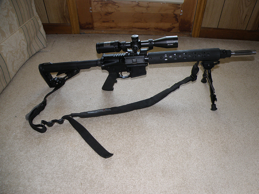

I am hoping for less than 1/2" 5 shot groups with ny new WOA 18" varmint upper with 1 in 7" twist which it fluted under hand guard and on end of barrel. It also has a Geissele SSA-E trigger installed.
White Oak Armament
GEE!!! I got my reloads completed for the ladder test and now it is raining. I'll have to do it during the week or next weekend.
I'll post my results if the test works out OK.
