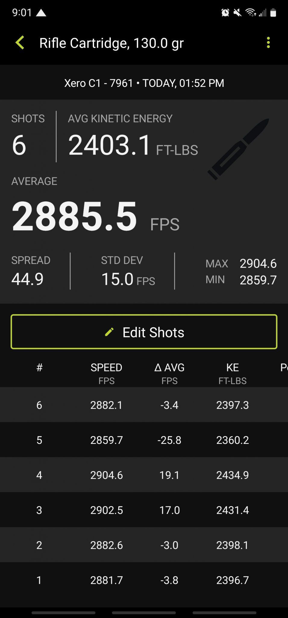

130 gr bullets will be from 2800 up to 2900. This is factory hornady 130 eldm from a 260. Unless your barrel is not up to the task.
