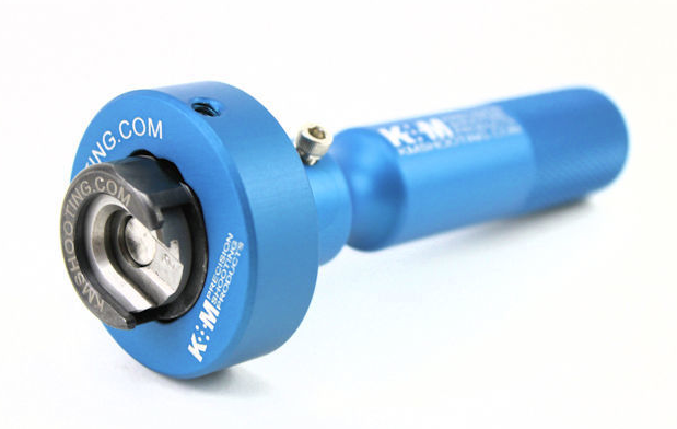

I have a Giraurd and have used gloves to reduce the impact on my fingers/hands....the vibration kind of sucks (for me at least) after a bit.
But I ran across this and it works wonderfully...was looking for something like the collet/shell holder that Henderson trimmer uses and found this from K&M.
This just a Lee auto-prime shell holder that they sell to go with their kit
Put it together and it looks like this...between a 1/16th and an 18th of a turn of the "power grip" is all that's needed to secure or release a shell. Its fast, simple, and really saves my hands
