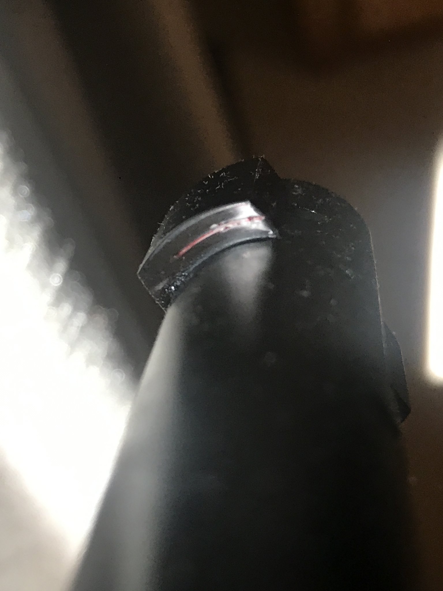

You know what’s funny. I just got a new HOWA Oryx in 6.5 CM as a replacement for my HOWA HS precision in 308 which wouldn’t shoot. Well it shoots quite well but I’m also getting basically no contact with the top bolt lug and recess and, despite lubing it like I lube all my other guns, I have a big gouge on that bolt lug and it is tough to open/close the bolt. I think there is probably a burr on the lug recess causing it not to make contact and creating that gouge. I Googled this issue and I found someone with the same gouge on their bolt lug. It was a HOWA 1500 as well. I am sending it back. Let's hope the 2nd time is a charm.

Update: I sent my rifle into Legacy Sports due to the bolt lug galling issue and lack of contact with one of the lugs. They sent me an e-mail yesterday telling me they are replacing the rifle and asking me for my FFL information.
It's pretty surprising to me that they would replace the whole rifle over this issue but it could be because this rifle is a replacement for a rifle that didn't meet their sub-MOA guarantee, when they sent the original replacement they sent me the wrong rifle, now I have an issue with the rifle they just replaced. They may be just trying to get it sorted out quickly given this is a replacement rifle already. Last time I waited ~5 months.
Could be the action was so poorly made they had to shit can it.
Given the fact there was such minimal contact with between the lug that had a gouge in it and lug recess, it is definitely possible. Basically the only contact seemed to be along gouge in the lug. Definitely sub-optimal.
