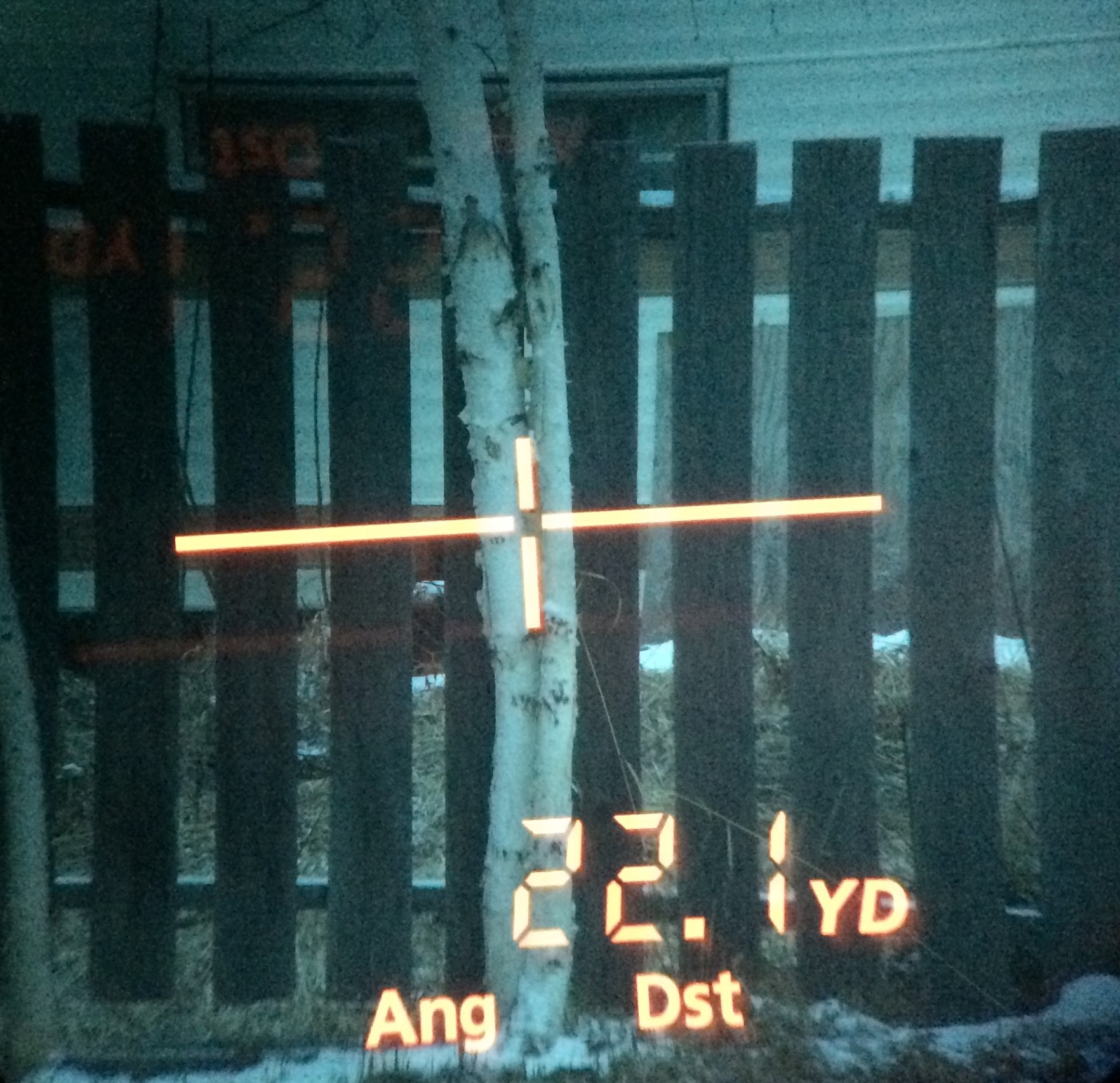

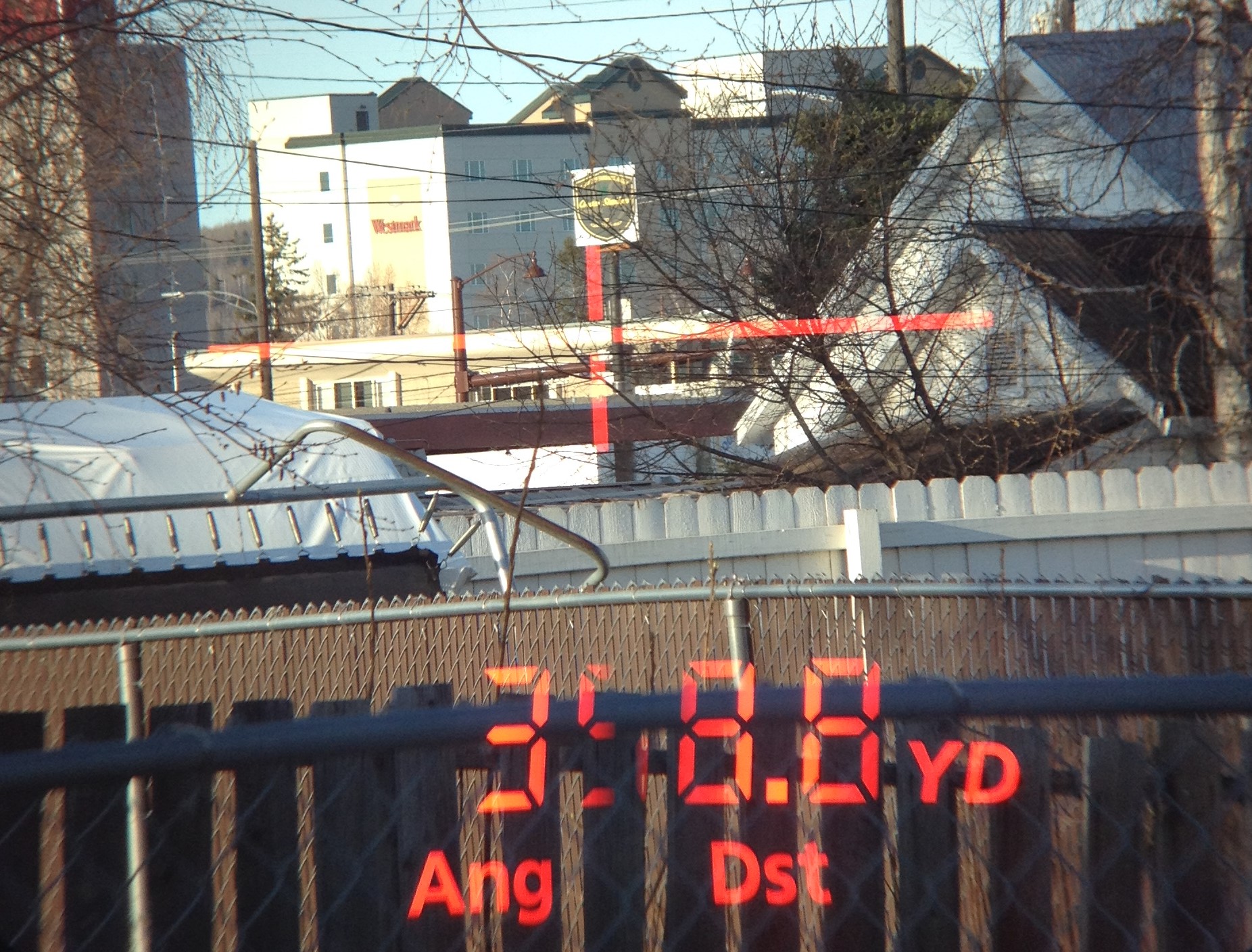

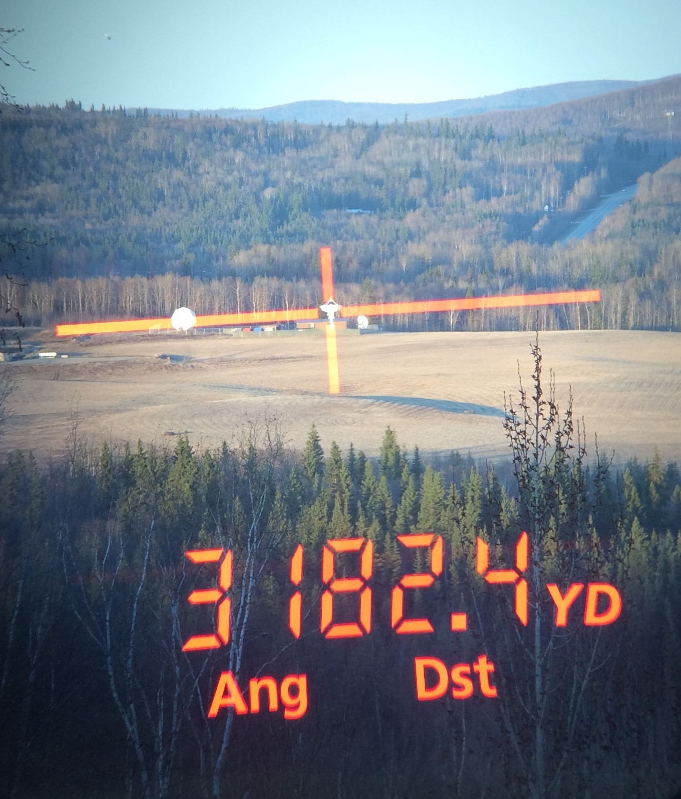

If you do a search on this site and Long Range Hunting Magazine (site) you'll find numerous entries, reviews, pros, and cons, etc. about the Nikon 4000K. I've contributed to this topic on both. Here follows some photos that are actual views through my Nikon 4000K: NIK4000l.JPGNIK4000 ranging through foilage1.JPGNIK4000p.JPGThis RF is the fastest I've ever used; the display is, well, see for yourself; if I remember correctly when comparing (same targets, same time) the Terrapin X, Sig 2400ABS, and the Nikon 4000K none "beat" the Nikon and there were times when several attempts had to be made to obtain a return in the display for all three, but the Nikon required less effort and time to get the result in almost all cases. For the money I don't see how anyone can fault this rangefinder. And one can spend several times as much and get several times less too.
