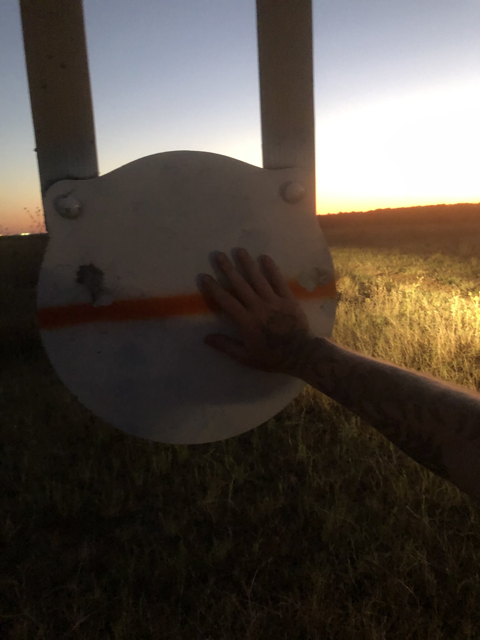

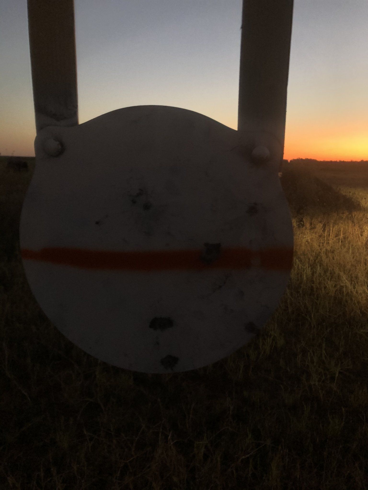

I posted the two pics below in another thread once before so I apologize for the redundancy. I was shooting a 308 w/ FGMM out of a 24” barrel & RC2 can. There was a pair of 16” gongs at 1K. In the first pic my wind call was .9 MIL & I impacted on the right edge; I then moved to the next gong & my wind call was 1.1, but for the sake of using a whole number I called it at 1 MIL. I impacted the water line for a second time & the can did everything asked of it.
I really dig the QD feature as well. I’ve shot guns w/ DT cans & it’s a PITA to me. Once the can is on, its ON. I use a muzzle brake on the couple rifles for which I use this suppressor & the one piece of advice I have for you is to lube the the shit out of your muzzle device & to scrub it once in a while. That should alleviate any & all headaches while using this can.
ETA: I apologize for the poor lighting in the pic. We’re painting steel before heading out.
