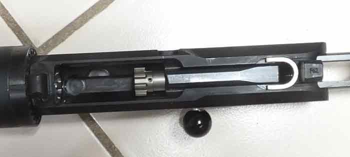

Ok so you have a sloppy upper. That can have vertical movement from the lower. People always say that it dosent effect accuracy. How is that different from limp arming a stock. Or just shoulder and get some poi movement?
Also the takedown pin has some movement when closed. Which isn't normal from what I've seen. I think that is the actual cause.
tried to use a little rubber gasket kept loosing those , tried another fastener it would not hold in place very well finally switched to a bolt and a nut and have not seen or had a problem in the ar we did that with a few others it was or has not been an issue only one and whether it does or does not make it better there is no slop between the lower and upper anymore not even a little wiggle it's not going anywhere till I want it to and the gun shoots great . Best of luck with yours .

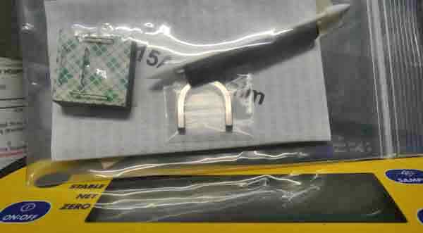

The front take down pin area check with a feeler gauge between the lower and upper lug. Then purchase brass washers to fill the gap less .001". This takes out the movement between the lower and upper.
I do the same with stainless shims from McMaster. Most receiver sets have 0.003-0.008" of clearance, even my tightest fitting ones. Typically the factory tight ones are that way because of the relationship between the pin and mating surface. Regardless, shimming the pivot pin can really tighten up a receiver set.

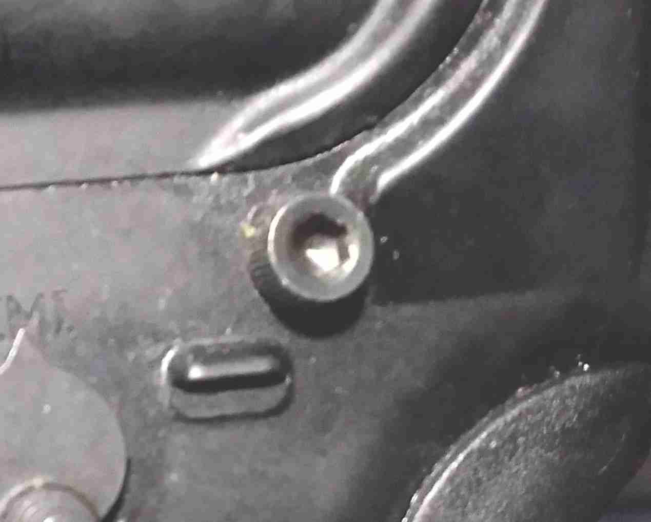

The tension screws should only apply load to the upper tang/lug between the screw and the takedown pin, and the lower between the pin and the screw. This should be harmless.

I used one .002” thick stainless 1/4” ID washer from McMaster on each side of the upper receiver pivot lug to keep the upper from moving laterally at the front pivot. May not matter much but feels great for the little it costs.
Add JP .001 oversized pins and the fit firms up nicely.
