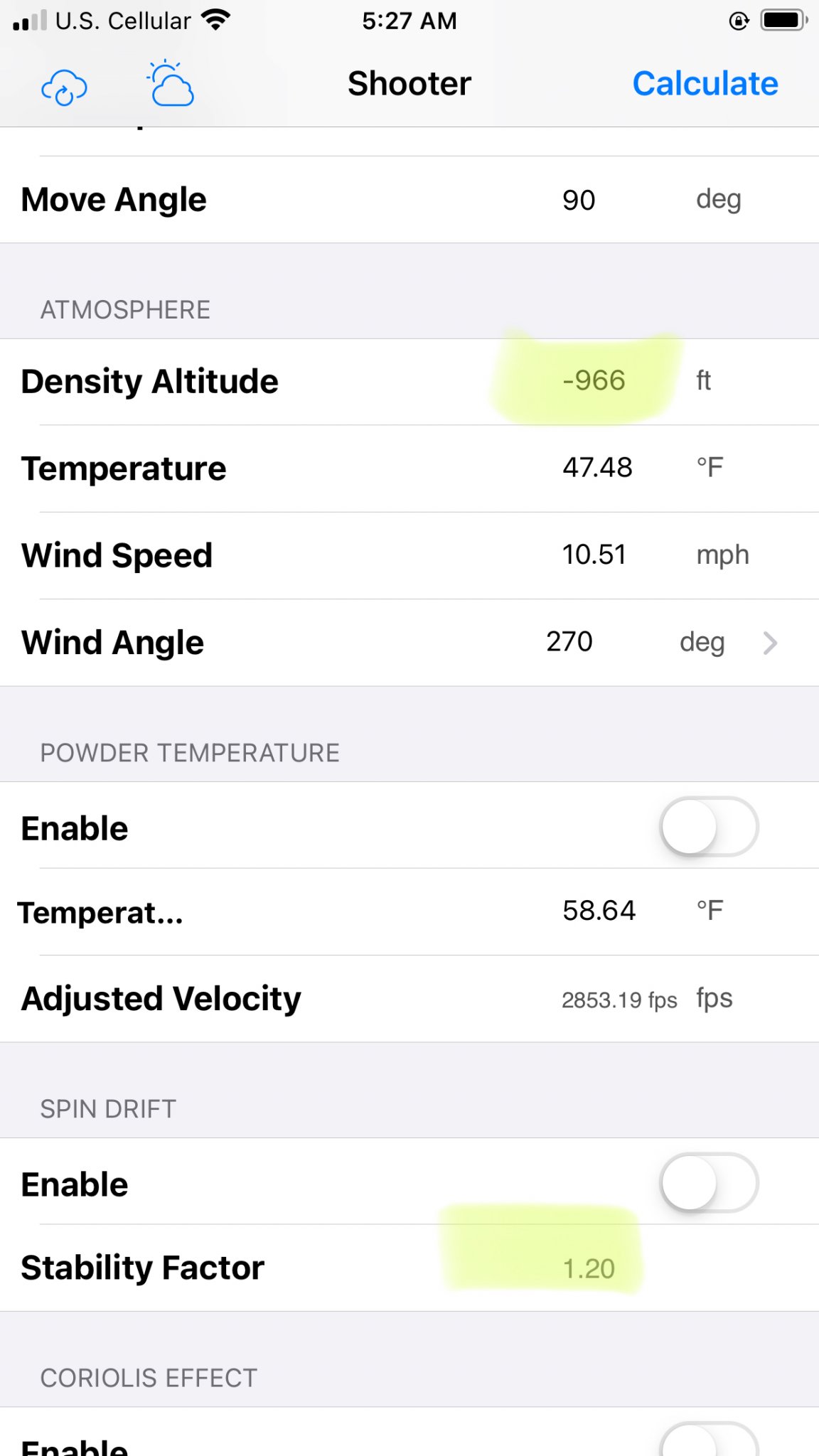

Good point about SG. I’m at sea level and my load’s SG is in the high 1.20s most of the time. Haven’t had any stability issues to 1k that I’m aware of. No keyholes or anything. But could cause a group to open up…?. BC variation is also a factor in whether a load will shoot at distance, regardless of how it shoots at 3-500

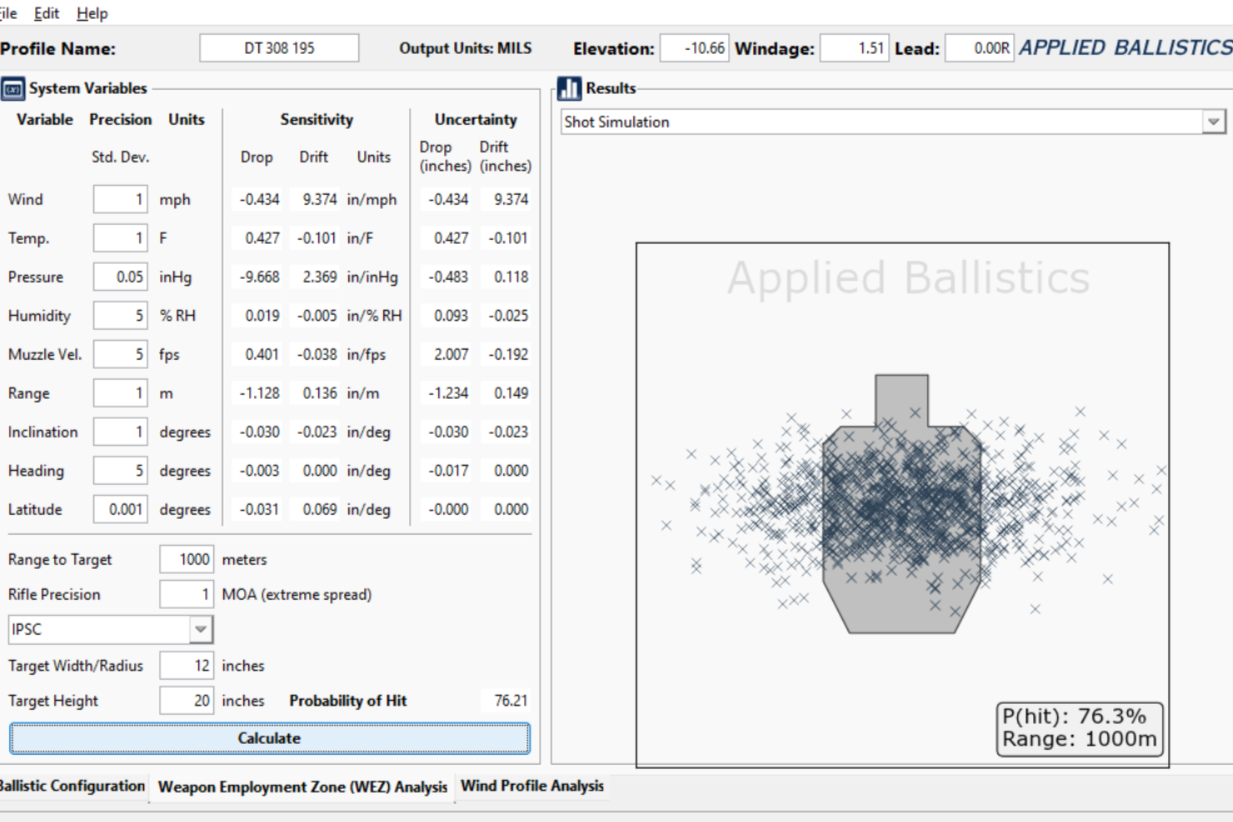

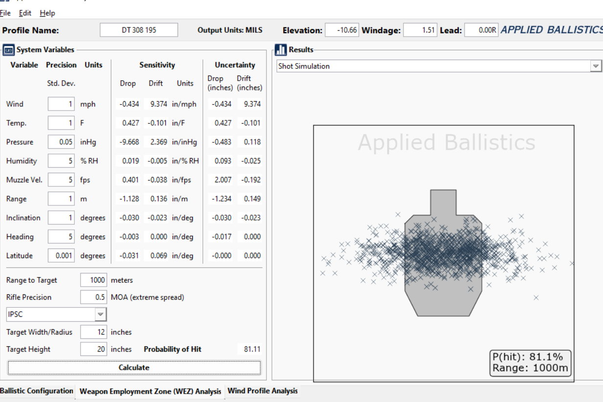

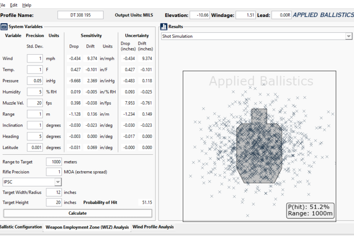

This is a screen grab of my inputs on my solver. Yes, we regularly have a negative DA, often close to -2000 during a deep freeze. DA and Stability are highlighted.
“But for the sake of curiosity, what can be done with an avg velocity of 2850 and SD of 5, with .5 moa precision capabilities”?
