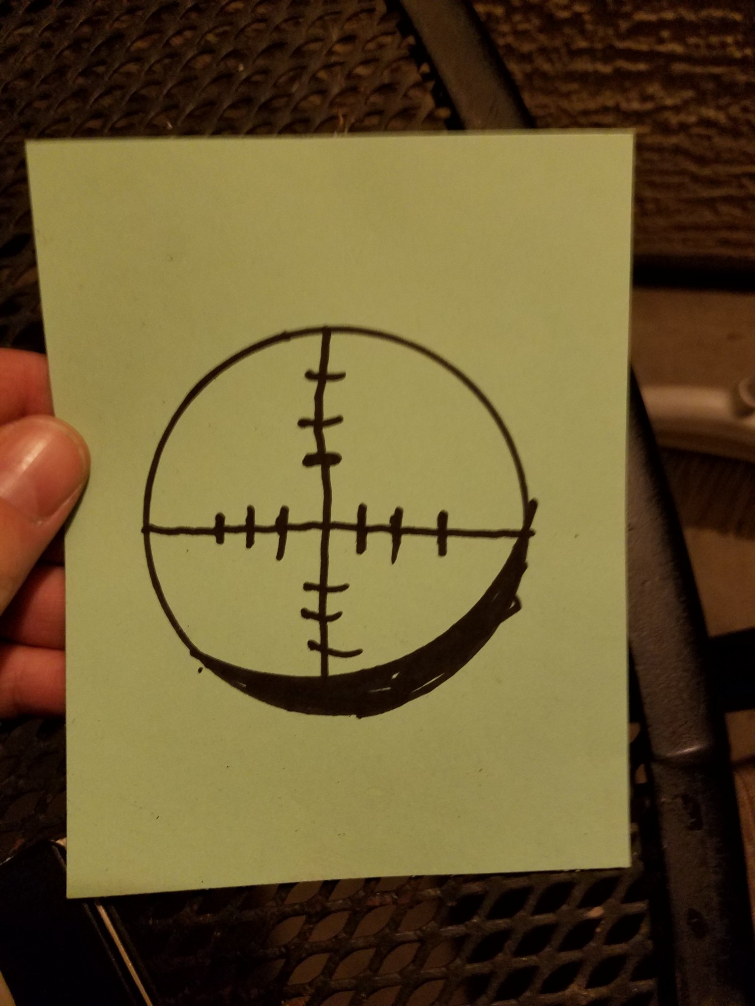

Hello everyone I have a question about proper eye relief and cheek weld. I have a McMillan a5 stock with adjustable cheek riser and am using a Burris xtr ii 3-15x50 with seekins rings and base and I feel like my cheek weld or eye relief is off. Maybe it's a simple fix but here is a drawing of what I see when prone. Now do I need to adjust my rest or move my optic back

Looks to me like your eye is a smidgen high and left of center line. Does the occluded area change in size, shape, location as you move your eye around? It has always been important to me to find a position that puts my eye right on center-line of the scope then move the scope fore and aft to get the best eye-box.
Reactions: Snuby642
I had a problem on my stock with it being 1/4 inch high due to low mount .
The sight picture was nearly exactly twice what you have drawn.
I got the 1/4 riser replaced with no rise and all is well, also no more neck strain, and eye strain.
For what it's worth 1/8 lower may be worth a try.
