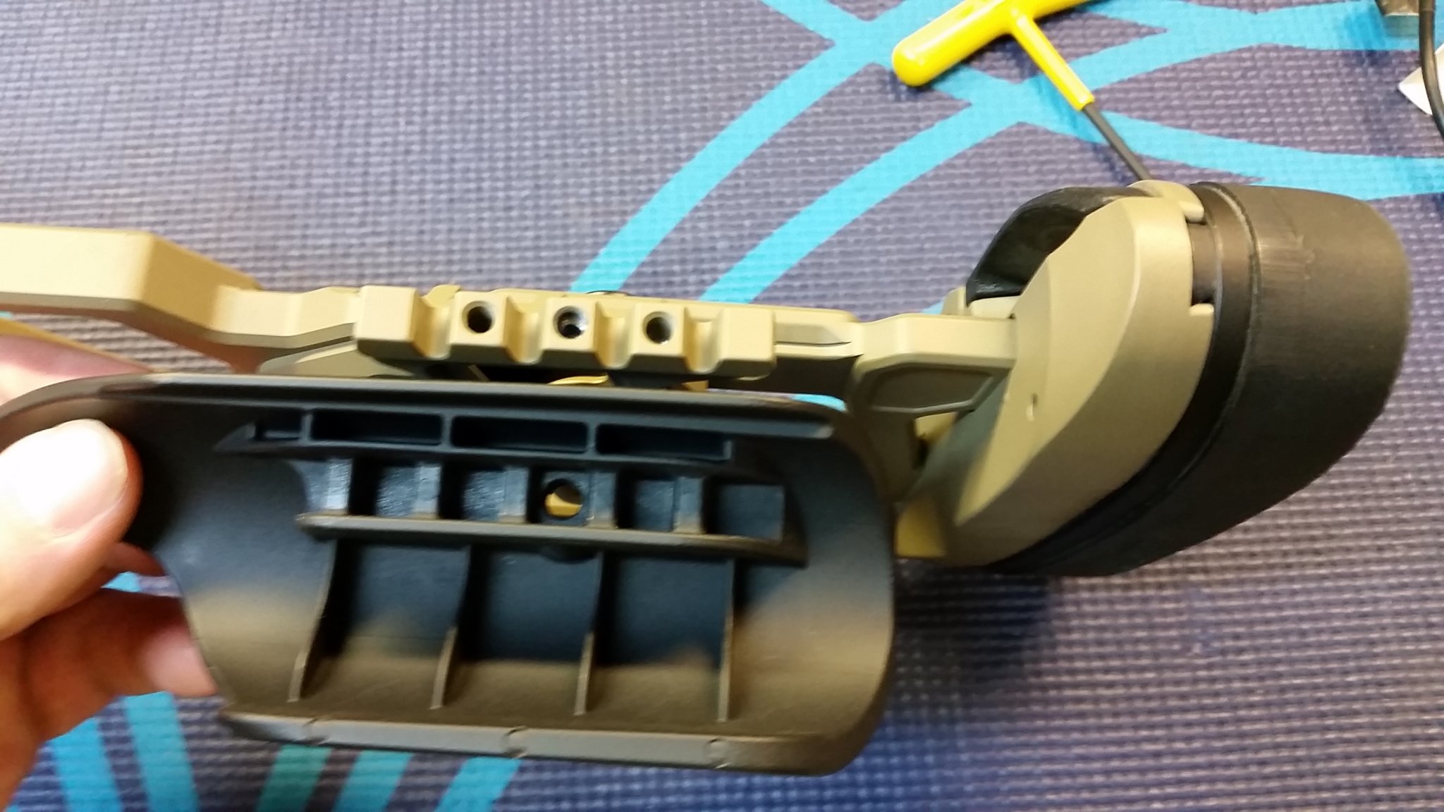

Sure sounds like you need to move the cheekpiece to the right. I'm not familiar with the Cadex, but it's very easy to do on an AI chassis. Are you sure they don't have a way to do it?
From the look of that, there is no adjustment possible. You would have to see a stock maker to have them construct you a new cheek piece. Although, a good machine shop might be able to mill out the reinforcing area and provide a new, offset mountain hole in one of the available spaces. Material removal could probably be done with a Dremel tool. If the fore and aft is OK, just use an additional peg to prevent twisting.

Just got a Cadex and have the same problem as Chadrp. I had an AI chassis to shoot F-class many years ago. I remember having the cheek piece always drifted a bit to the right. Squirrel face here too.
I'm thinking a wooden piece could be used to offset the cheek piece to the right.

No, I never have come up with anything. I finally got to a couple matches this summer and they both had weak side shooting and figured if I moved the riser to the right I would have a really hard time shooting weak side. I've just worked on getting behind it better, but now I've gotten a manners stock and feel much more comfortable behind it so the cadex has been moved to a backup. I really like the cadex but I just seem to feel a little more comfortable behind a stock so idk, I'm probably just a mess lol.
Ok thanks Chadrp! I'll try to come up with something because, other than that, the Cadex is awesome. I'll report back about my solution, if something works.
