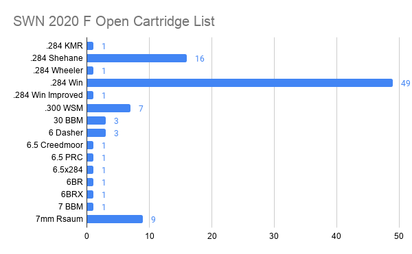

I will echo what Steve has to say. As a NRA F-class regional match director, I have seen the 284 and their variants do very well. Great 7mm bullets and reasonable barrel life. Depending on the wind conditions of where you might typically compete, the 6 Dasher and its family might be worthy of considering too.
@milanuk might have more current input. He is on the US national F-TR team.
Used to be 6 BR / 6 Dasher for MR, and 6.5-284 for LR, with a very few people running 284 Shehanes, 7 WSM/SAUMs, etc.
More recently it seems like most people run a .284 Win or some variant - KMR, Shehane, etc. (but mostly straight-up .284 Win) across the board. No more one gun for MR and one for LR. Or if they do have two guns, it's a primary / backup situation, but both in .284 Win. The 7 WSM, 7 SAUM and .300 WSM tend to be more common in dedicated 1k-only guns, due to the relatively short competitive barrel life. From what I've heard, the .30 cal short mags pushing heavier bullets are just enough harder to drive accurately - not that the gun/caliber lack, but that over tournaments that run a weekend to 3-5 days the torque and recoil add up. Some people keep one around as a 'windy day/range' gun, for those days when nobody is shooting clean ;)

This is posted in the F-TR forum here but I'll drop it here too. This is the Open equipment list from the Southwest Nationals in Feb. It includes all the info from those who completed the request for information that the MD put out.
For those unfamiliar with them all of those 284 wildcats are based on the 284 Win.
The 284 Win is way out there compared to any other cartridge. I guess if it ain’t broke don’t fix it.
