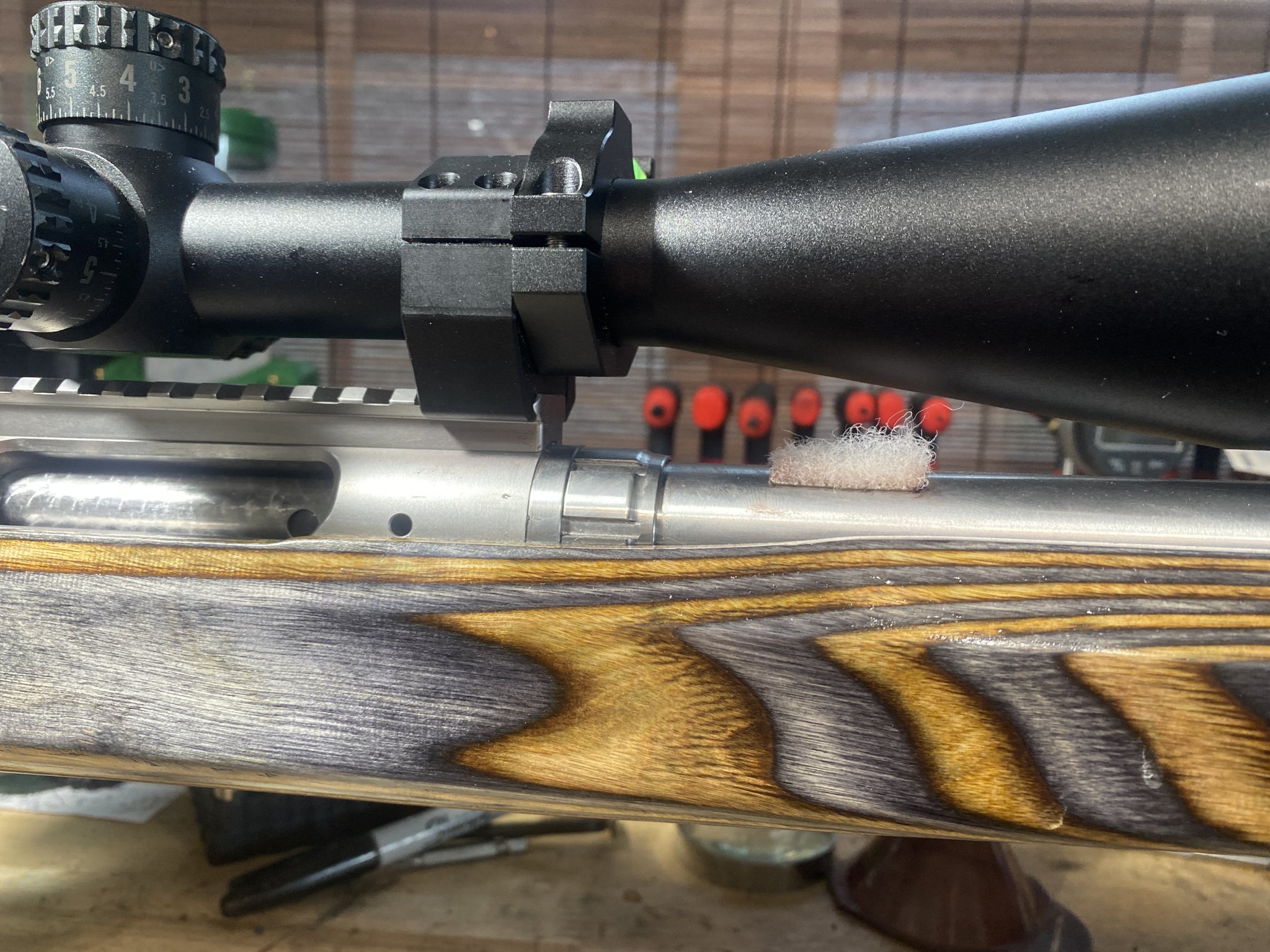

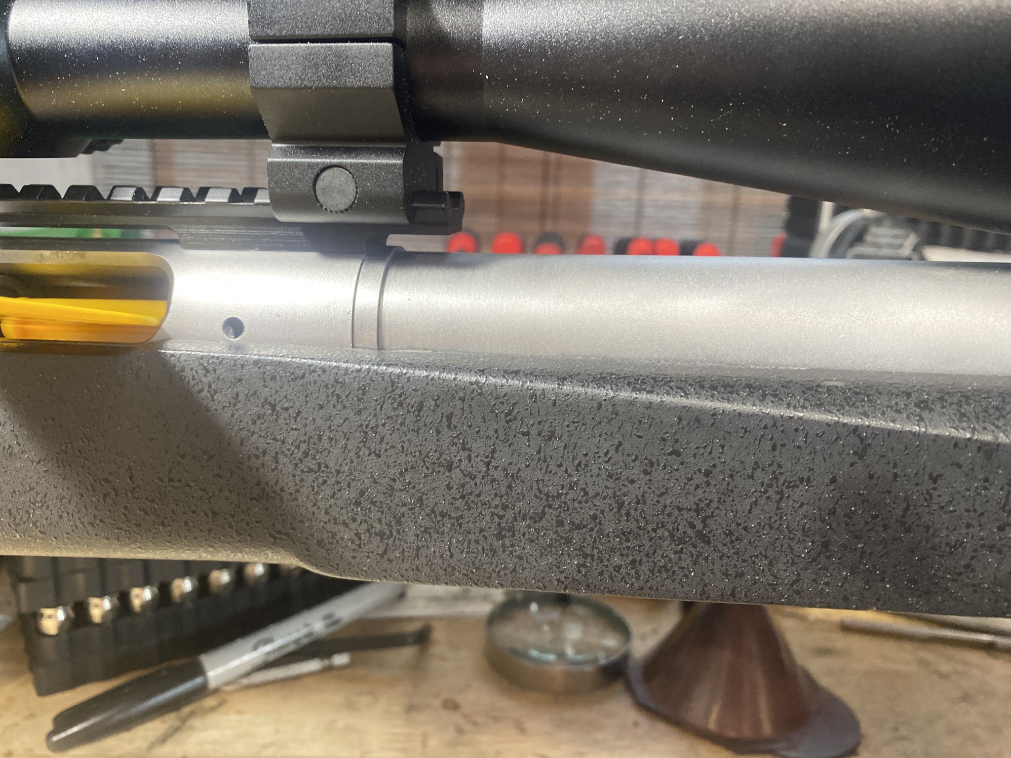

It’s really just semantics. A prefit is typically a barrel you purchased already chambered, crowned and threaded. It’s not specific to any one action, just the tenon thread pitch and diameter. You see them a lot with Savages. You buy it, screw it on, headspace it and tighten the barrel nut. A blank you have to have it crowned and chambered by a smith and it’s threaded to headspace correctly on your particular action.
That is likely why the barrel mfg said he could only do a heavy Palma in a prefit. A heavy Palma will still fit inside a barrel but. I don’t think a straight will.
Here’s two examples. The laminate stock rifle has a Shilen pre-fit in whatever the biggest diameter I could get. The black stock rifle is a 1.25 straight that was chambered and threaded to fit that action.

At the end of the day I think you should make a decision based on your shooting style, budget and commitment to competing. You can get a prefit for about $400. A 1.25 straight blank will run $400-500 and a chamber job will be about $275-300. Add in another $300 or so if you want your own reamer. If you’re just testing the waters, a pre-fit is a cheaper option. Either way if you want to get out of it you’re going to lose money. The bigger barrel will obviously be heavier. Probably not a big deal for a 6mm as it shouldn’t have much recoil. My smaller prefit is a 284 8 twist. Shooting the 180s at 2800 it has a lot of torque and a fair amount of recoil. Even with a high $ front rest, I have to handle the rifle. I want the front end heavier to tame the rifle a little more.
It might now be a big deal for your rifle or maybe you’re good at managing the rifle the same way every time. I am not.
