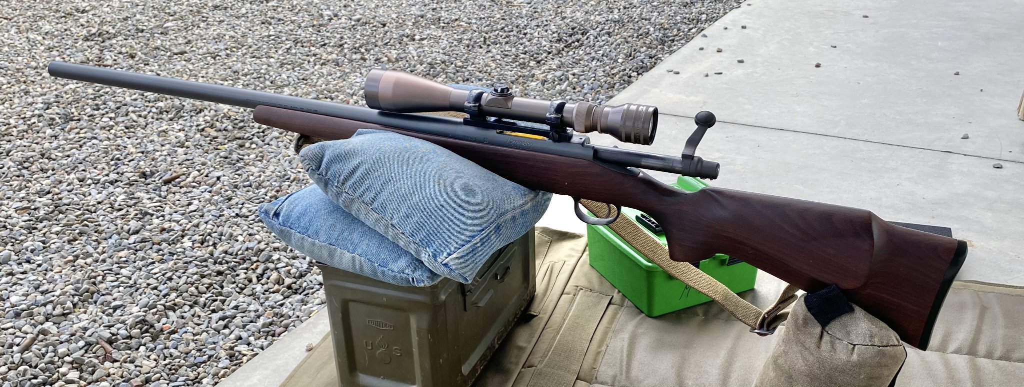

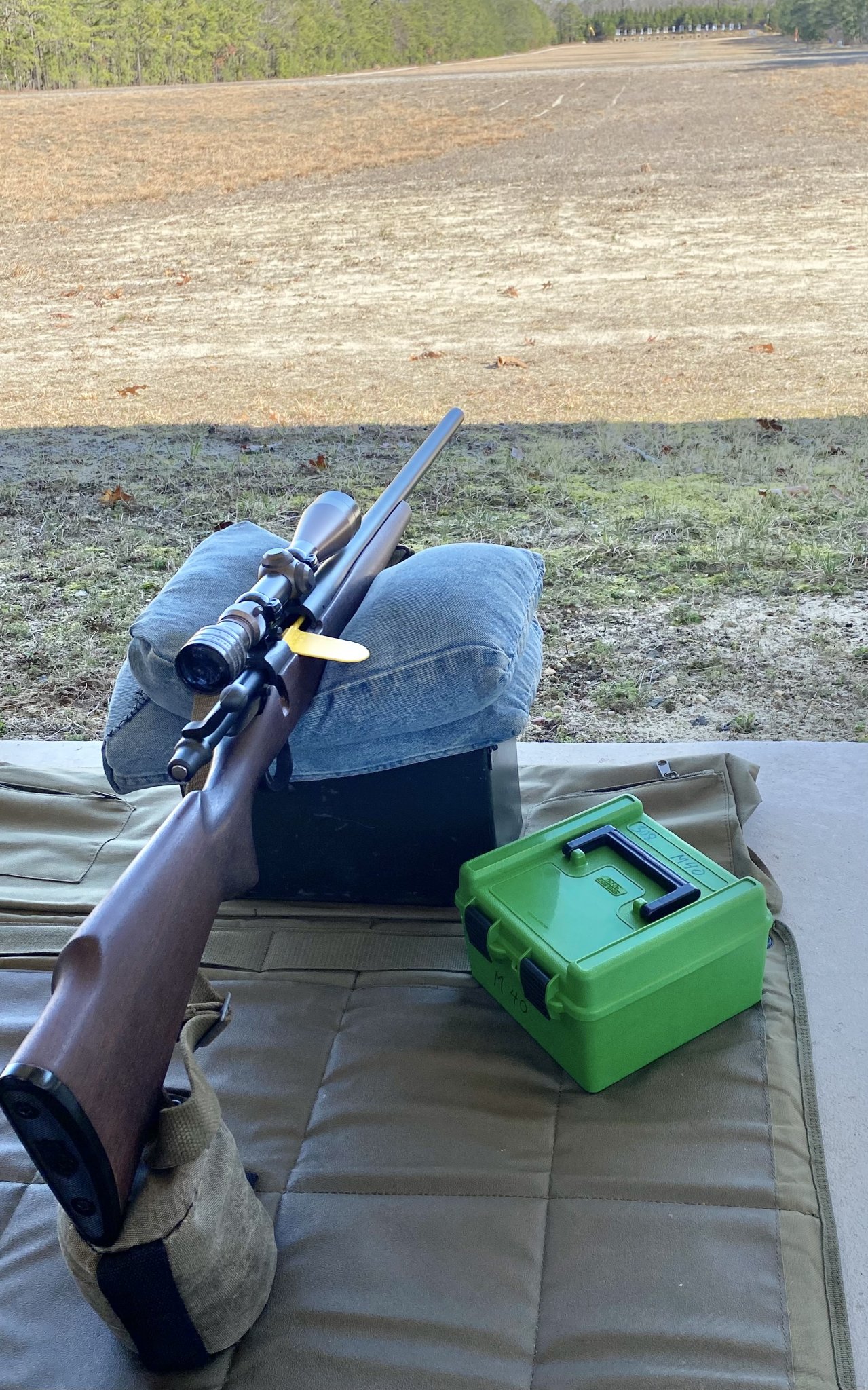

My buddy and I took our rifles to an f class shoot in south Jersey yesterday. I shot my M40 copy, he had his M70 clone. We wre on different relay so I didnt get any photos of his rifle. We were most definitely outclassed by the competition, but the target went in the pits every time I pulled the trigger, and that was happiness in itself.
That Redfield scope made me work for every point, but it was pure fun.

I used my M40 replica with an M40 commemorative Leupold/Redfield 3-9x scope at a Quantico Vintage precision rifle match years ago, and I recall that the elevation adjustment bottomed out after 800 yards. So I had to use the Mil-Dot holdovers at the 1,000 yard firing position. I subsequently put an aluminum shim under the rear mount just in case I want to try that again. (It looked a little too Bubba-like left in-the-white, so I had that shim Creakoted flat black).

A couple shooters expressed interest in the rifles. There was a definite appreciation of the rifles and the fact that we were there shoot them. They shook their heads a little, but they got the idea. It 's a good bunch of folks. But haha odd man out is a polite way to put it with that crowd--equipment wise that is.
We were able to get some practice in on Saturday, and there I found I didn't have enough elevation for 600. So I took the scope off and shimmed the rear ring, that got me there. The biggest hinderance? The poor optical quality of that old Redfield. I was able to read the mirage, but the target itself even in good conditions was never clear. The lenses in the scope are look like theres some delamination going on. That and the fact that the elevation and windage knobs are friction not clicks. It meant getting out of position to make adjustments, so for , minor changes I just held off.
The last was head position, I am shooting the rifle the way it was used originally, that is no cheekpiece, so extra attention has to be paid to head position shot to shot.
Joe and I went there with the attitude that as long as the target goes in the pits every time we pulled the trigger we would be ok.
I bet you had to work for those points, but like you said, the goal was getting on target. I learned a lot from those guys when I started shooting Highpower and F-class. You got your feet wet, so keep at it.

I shot my M24 Rebuild rifle in a local F-class match a few years ago. I held my own, the full minute adjustments in the issue scope meant the only X's were harder to come by. I ran issued M118LR as well and the gun and ammo combo was spot on. I did not kill it as hard as Rudy but it was a very good time. I used the Harris bipod and bagged the buttstock. Other than being on the heavy side, the rifle worked as advertised.
My buddy and I are big fans of shooting these rifles in comps. This weekend I'm shooting my M70 sniper copy. I have a ton of Lake City match, for the M40 but it's old 1968-1971. I've tried the old trick of seating the heads .005' deeper and have also sorted by oal and ogive length. Bottom line is it's ok for ringing steel, but it's no longer match quality.
The benefit of any formal competition is that it forces you to pay attention each time you fire. You get an accurate assessment and feedback of your performance and the rifle/ammunition. Doing well or holding consistent groups is a reward in itself.
It's a personal challenge, my attitude is I want to shoot better than I did last time.
