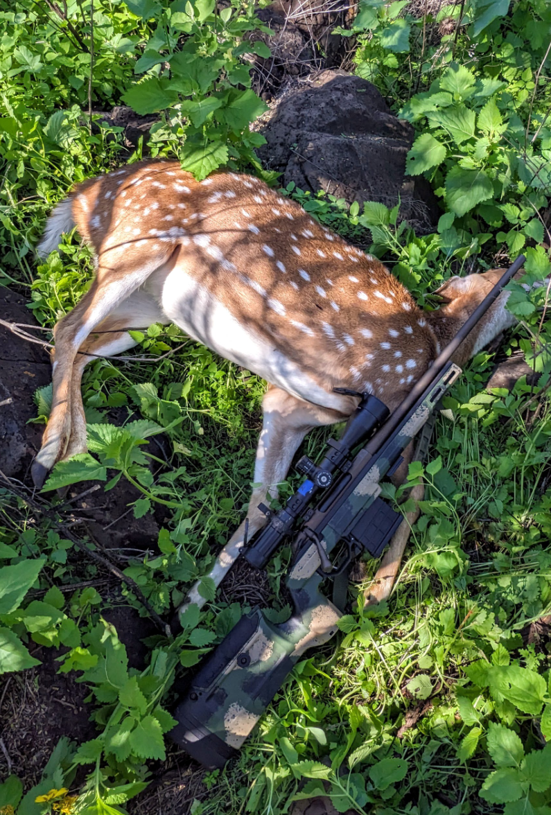

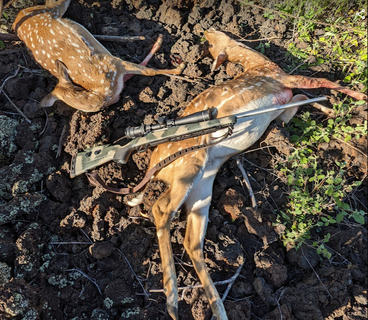

8 twist tikka in a bravo is my trainer. Dont think you need a super varmint. stainless would be fine.
Exactly what I did, well almost. I did the Tikka T3 Stainless Superlite 223 and replaced the factory stock with a Manner's EH1-TK, have since replaced the Warne rings with a Murphy Precision Titanium rail and Vortex PMR low rings
The larger capacity OEM tikka 223 magazine seems to be the only tikka mag that can have some reported functioning difficulties. 3 Rd/OEM stock no problems though. I use the 10 round polymer aics in a bravo and have had no issues
I dig the camo cerakote! Makes the Bravo look even better! Did you do that yourself?
Reactions: tacoman69
Yea thx sponge painted myself. Action barrel is midnight bronze cerakote to try and give some protection and different look.I know I recd the stainless but I got the 20in compact as this will be what I will get my toddler started shooting hunting on and wanted the compact stock.

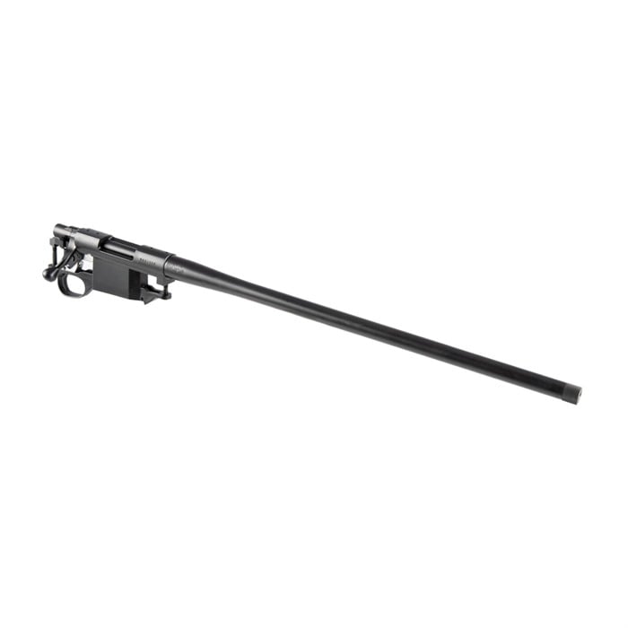

I built up two Howa Mini barreled actions for my father as very light hunting rifles (post back surgery) for <300yds and with handloads/premium ammo they are sub moa at 100 yards for 3 shots. I still need to work up a load for the 22-250 SA.
I have a howa Mini action 20 inch heavy barrel 223 . I swapped out the plastic trigger and magazine housing for a DIP aluminum trigger and magazine housing . I also ordered 3 extra magazines at the same time they were back ordered but I got them in 2 months . I also installed an outer limit's 20 moa scope mount rail . It shoot's 77 grain matchkings and 55 grain hornady BTHP match sub moa 5 shot groups 64 grain power points fly around 1 moa and thats good enough for deer , coyotes and occasionally a ferrel hog . I'm still using the factory stock since the rifle shoot's just fine the way it is . It's a shame they can't get off their ass and put out more product .

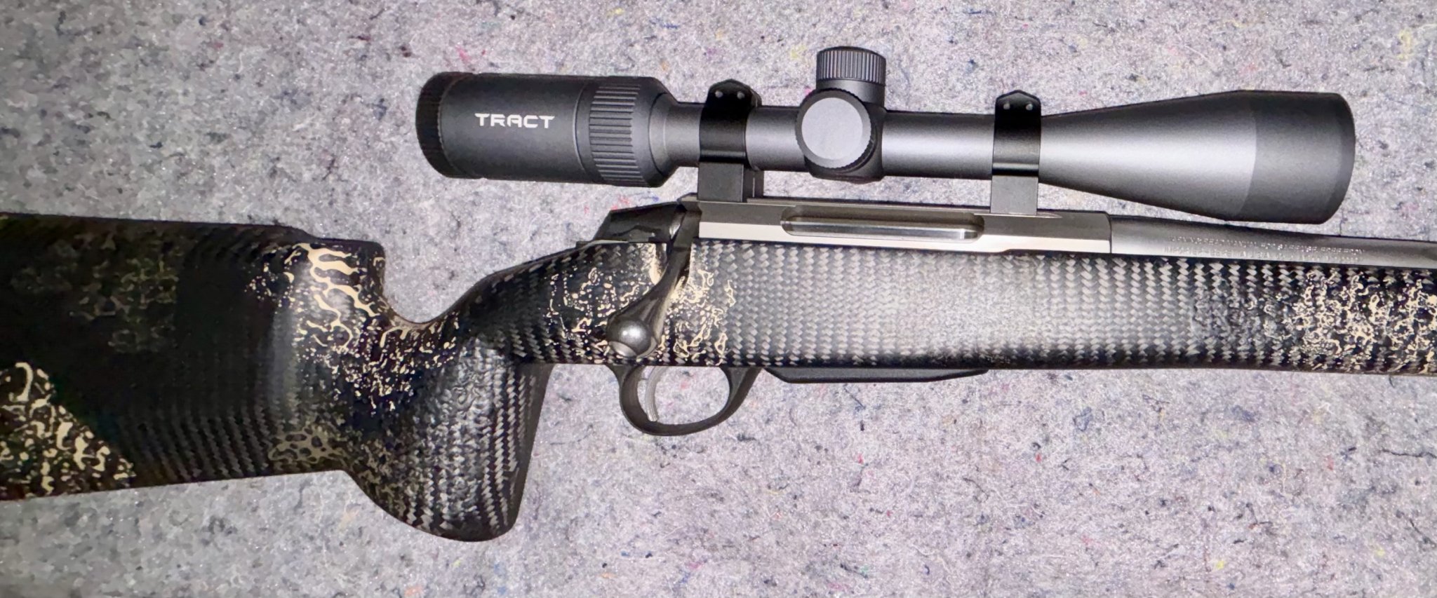

It`s interesting. I know that there are those who buy rifles and shoot them in factory, out of the box stocks, but if posts here and other sites are any indication, they are in the minority. I`m beginning to wonder if ANYBODY shoots a Tikka in a factory stock!
get a comb raiser vertical grip and you still have a pretty good stock. it's only 30 oz (34 with comb raiser) and the SRS hunter rail gives it arca/pic capabilities too.
