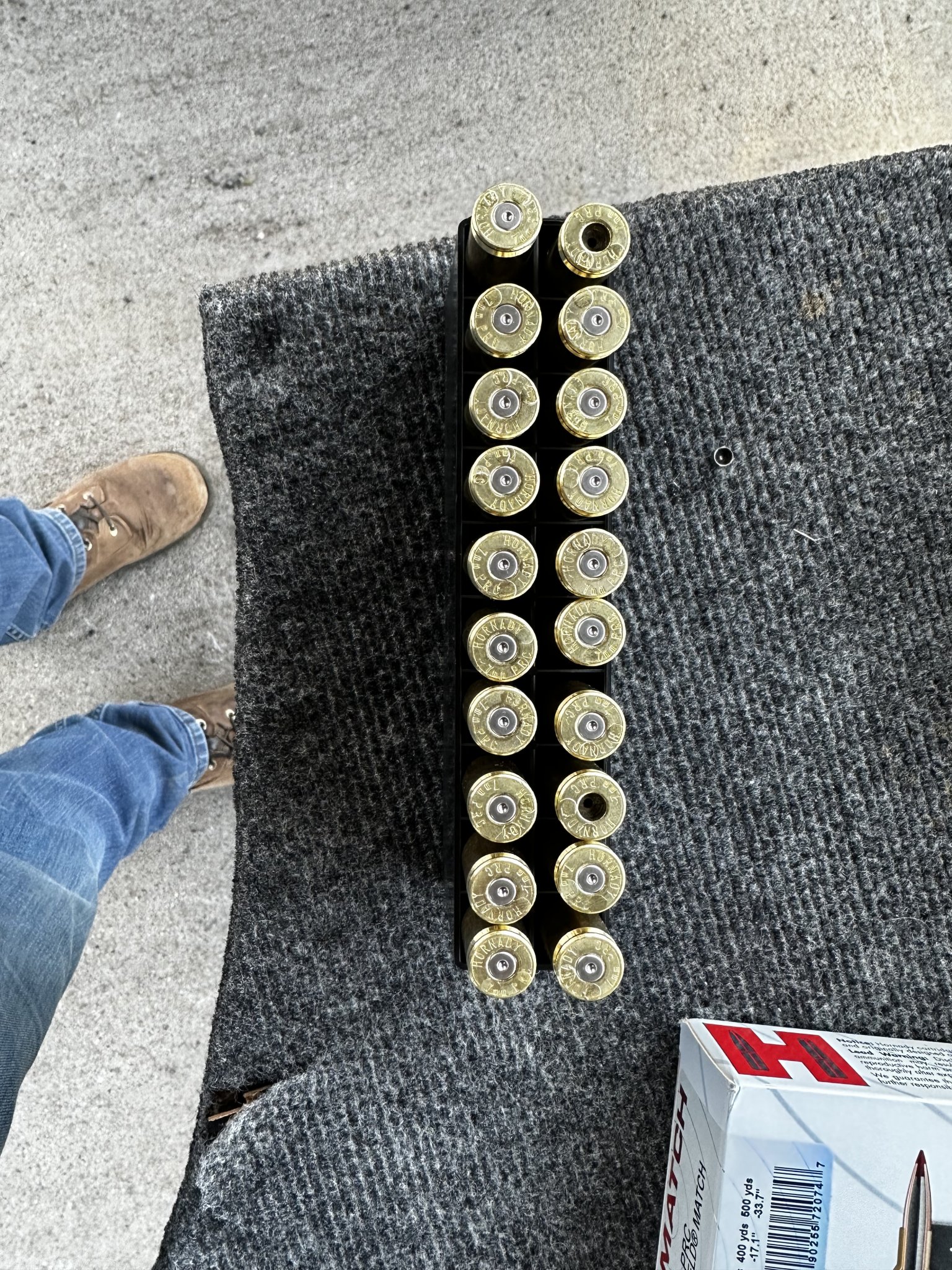

Hi all, I’m trying to figure out how concerned I should be about this.

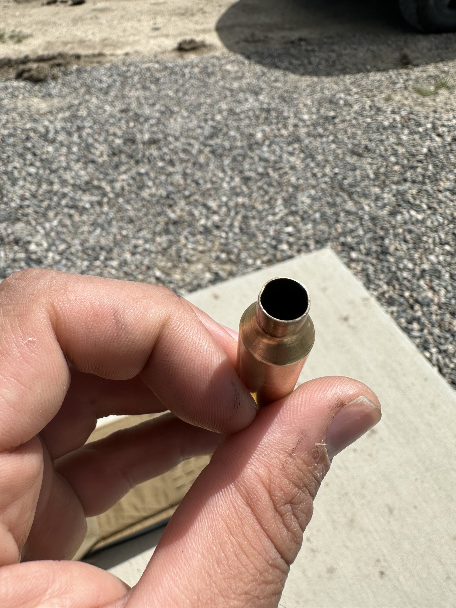

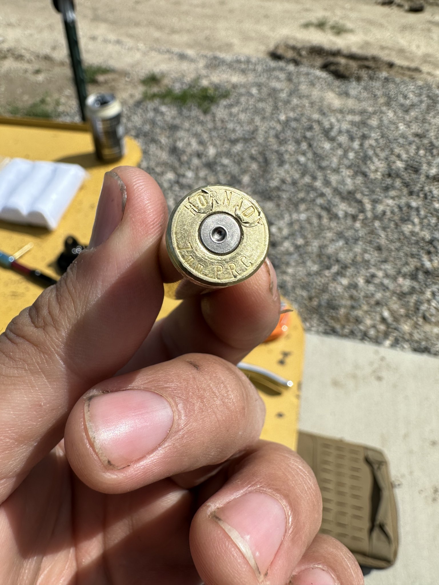

I took a brand new 7prc Christensen FFT to the range for the break in process. First shot with Hornady factory ammo, I got the following pressure signs: completely blown out primer, ejector marks with sharp edges where brass flowed into ejectors, really heavy bolt lift (could still work bolt with one hand, just really had to reef on it).
Another weird thing was that the case neck was dented on both sides at about 10 and 2 o’clock.
I know enough to be wary of what — in my mind — are significant pressure signs, but not enough to know if it’s the barrel just being brand new or something, or if it’s just a little left over factory grease causing excess pressure I can clean out, etc.
Anyhow, I erred on the side of caution and decided to stop right there and then. I’ll call Christensen and Hornady and see what they say.
Pics attached (note: I reinserted the primer just so it would stay with the case in the box). I would love to hear what you guys had to say. Thanks in advance.
Did you clean it before you went to the range or just right out of the box and firing? Not saying this is the case, but if there was to be grease in there, it could definitely cause these signs.
When you chambered the round, was it tough to close the bolt or not? Not sure if it's worth chambering - but not firing - another round to see what's up.
Regardless of the barrel being brand new, you should absolutely not be getting these issues.
Frankly, I took it out of the box, mounted the scope, cleaned the bore using a bore guide and shot it.
Being that all of these rifles are shot in factory, I perhaps wrongfully assumed that it was in shooting order.

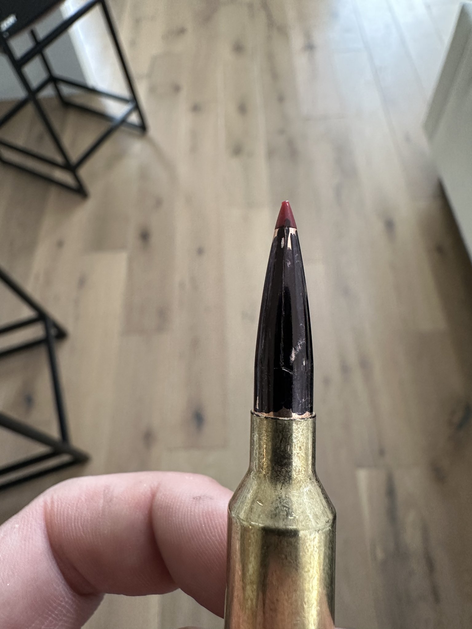

Rounds chamber very smoothly. I blacked out a bullet with a marker to see if there was anything really obvious when chambering. This is what I saw.

It looks like it has two ejectors. A lot of people have been removing one of those because of excessive pressure even with factory ammo.
I am NOT saying that’s your issue, I’ve never saw it that bad from dual ejectors.
It could be as simple as an excessive head space vs hot factory ammo. If you have the tools you could pull the bullet from a live round and see how much fire form you are getting with a comparator; punch out the spent primer it can skew the measurement.
What Fisher said, Excess headspace and hot ammo causes problems, I'd also make sure the bullets are not jamming into the lands, This will increase pressure significantly in already hot rounds!

Good afternoon, we have recently made some changes here at Christensen Arms and I am the new Director of Customer Experience and I am focused on clearing up any past issues of QC and Customer Service. Our marketing team will be addressing this shortly as we leave this stuff behind us.
For the amount of money you guys are paying for a rifle from us we do want you to have complete faith in your rifle as well as ammunition you are running. You also want the level of customer service that is fitting of a rifle purchase like this.
Ejector marks like you are seeing are pretty common across all manufacturers making rifles for the PRC line of cartridges, but if at any point you have a question with it we are always more than happy to bring your rifle back and do a complete inspection of the rifle.
Now the primers popping out at that rate does make me a little concerned. We know the Hornady PRC ammunition are pretty hot rounds, that mixed with some excess headspace can cause this issue. We would be more than happy to get this back to check out for you to make sure we have no issues.
If at anytime you guys feel your question is not getting answered by someone at Christensen Arms, please feel free to reach out to me here and I will get you guys taken care of ASAP.
