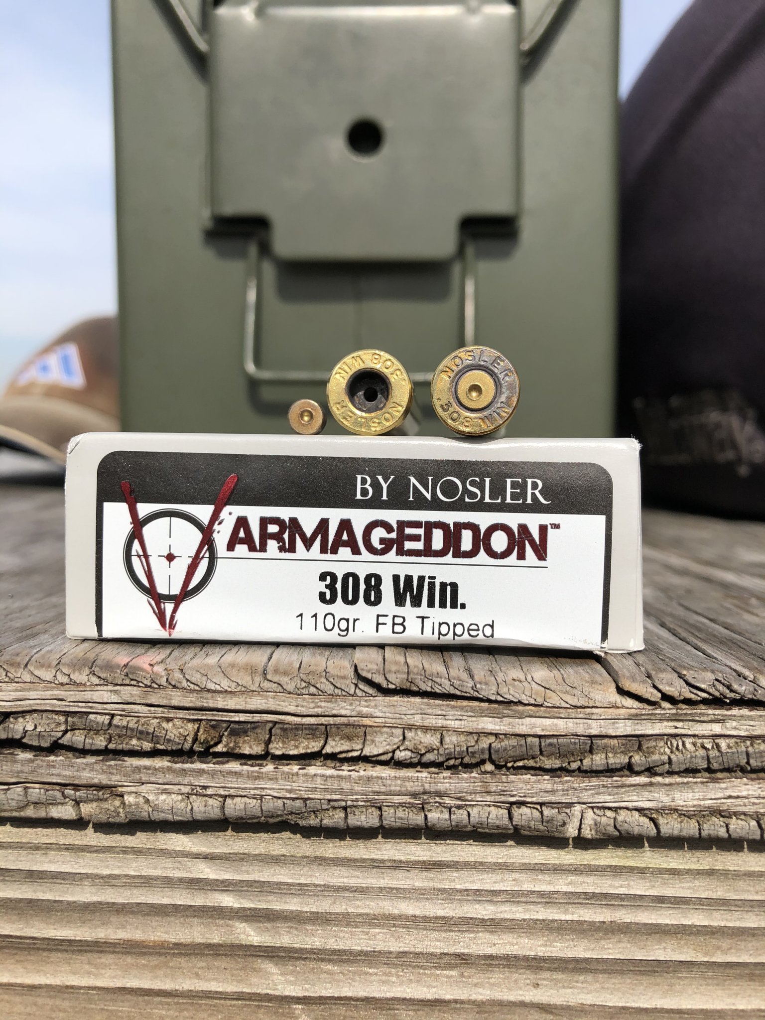

I have a friend Who shoots an FN SPR in 308, he shoots factory ammunition.
With this ammo and only this one he gets 2 or 3 blown primers out of a box. I was shooting his rifle today and got this, the primer freely goes in and out of the pocket. Firing the shot I couldn't tell the primer blew out. I've had my fair share of blown primers and firing the round I always new the primer was out, but not this time. Because the primer pocket is so big, I'm guessing pressure?
Any thoughts?
Thank you!
Looks like gas is leaking around the primers also. Might be a problem with the ammo
I don't see any ejector marks either. Primers may be very loose from the factory
Nosler ammo is horrid...I’ve also seen pressure signs across multiple .308 S/A rifles I own and have owned with their “Match” 168g stuff. Groups would typically 2-3 MOA at 100 (fed GMM would shoot 1 MOA by comparison with zero pressure signs). Ejection patterns at 1-2 o’clock, all unsuppressed (never bothered shooting that crap with a can on)
Advise your buddy to run diff ammo.
