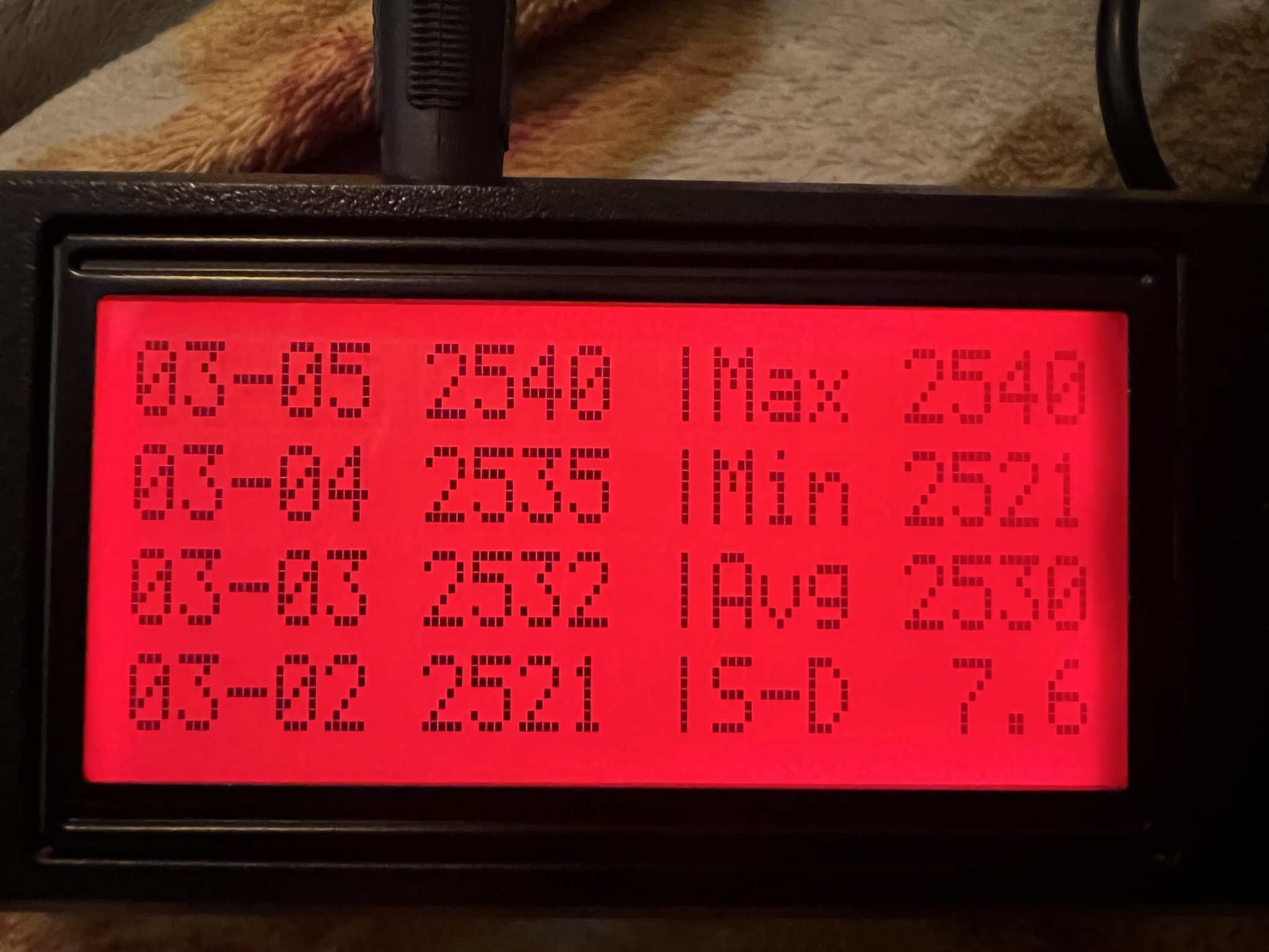

Just for fun:
If I read the box right, Frank was shooting some flavor of Corbon ammunition. I've shot the Black Hills 178 gr with the same/similar performance. But I use the Badlands 175 and the Lehigh Defense 150 for long range steel.
