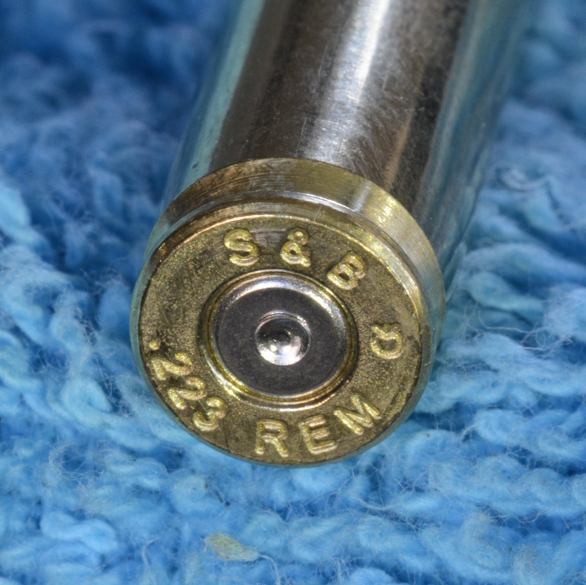

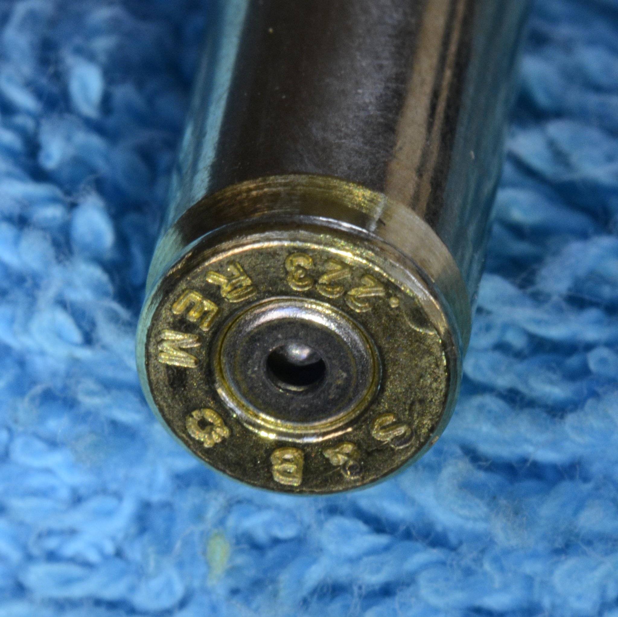

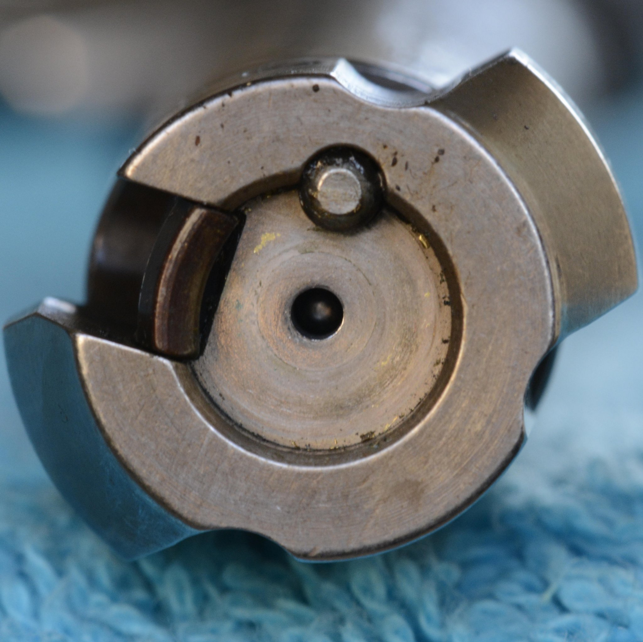

After 25 rounds, 5 groups of 5 shots without incident, I started on the 6th group. When I pulled the trigger on round #26, I felt a blast of air/gas/something hit my face. It startled me. I could see that the round hit the target in the expected location. I thought I noticed a different smell from the shot. When I tried to eject the round, the bolt was very difficult to lift. With some effort, I was finally able to eject the casing, which I examined. To my untrained eye, there didn’t appear to be anything wrong with the casing, but I saved it anyways. I reinserted the magazine and fired round #27. The same thing happened, but maybe with less severity. Not as much “blowback”, and not as difficult to lift the bolt. More difficult than normal, but not as bad as round #26. I again examined the casing and also removed the bolt from the rifle to examine that. To my eye, everything looked fine. I was able to run the bolt normally without a magazine inserted into the rifle. So, I reloaded and fired round #28. This round went off much the same as #26 with a noticeable slap in the face from some sort of high-speed pressure wave. At that point, I discontinued shooting and packed up. I saved casings from rounds #26, #27 and #28, and also grabbed 5 more casings from earlier rounds that I didn’t have a problem with.
At this point, on the drive home, I suspected there might have been an overpressure issue, but I hadn’t expected this from factory-produced ammo. Once home, I did some research on the signs of overpressure and that is exactly what I think happened. The five casings I collected and #27 had cratered primers with raised edges around the firing pin dent. Rounds #26 and #28 had very deep pockets in the primers from the firing pin; almost like caves. The faces of all primers seem very flat to the edge. Also, upon inspecting the bolt face of my rifle, I can see a primer-sized ring around the firing pin hole. In my opinion, this ammo is not safe to use.

Photos: Boltface1 and Boltface2 - not cleaned after the range to preserve coloration.

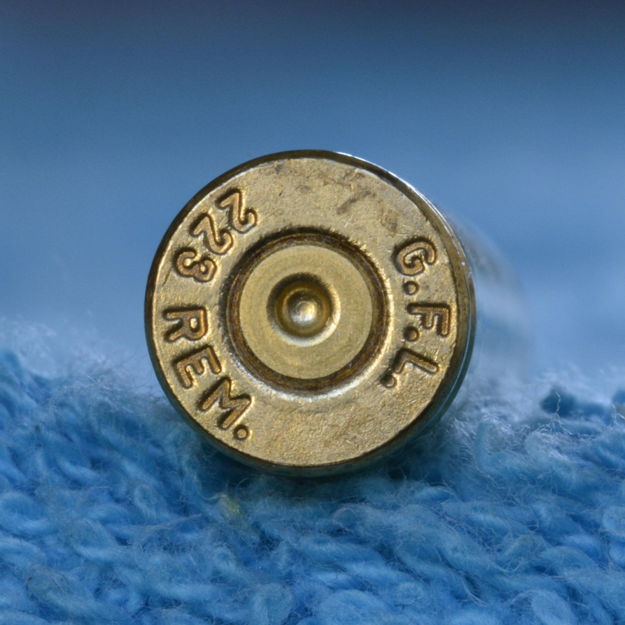

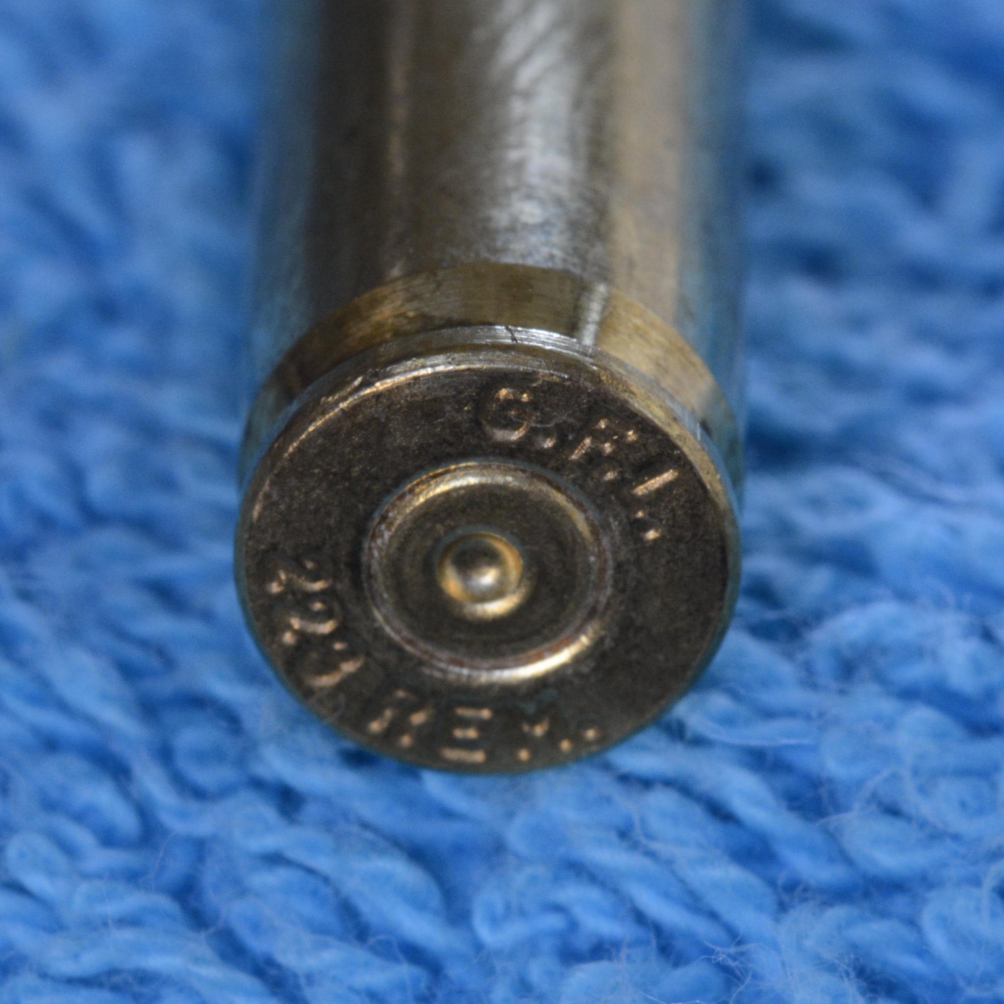

Photos: Normal1 and Normal2 - a casing I have fired in the past. Just for reference.

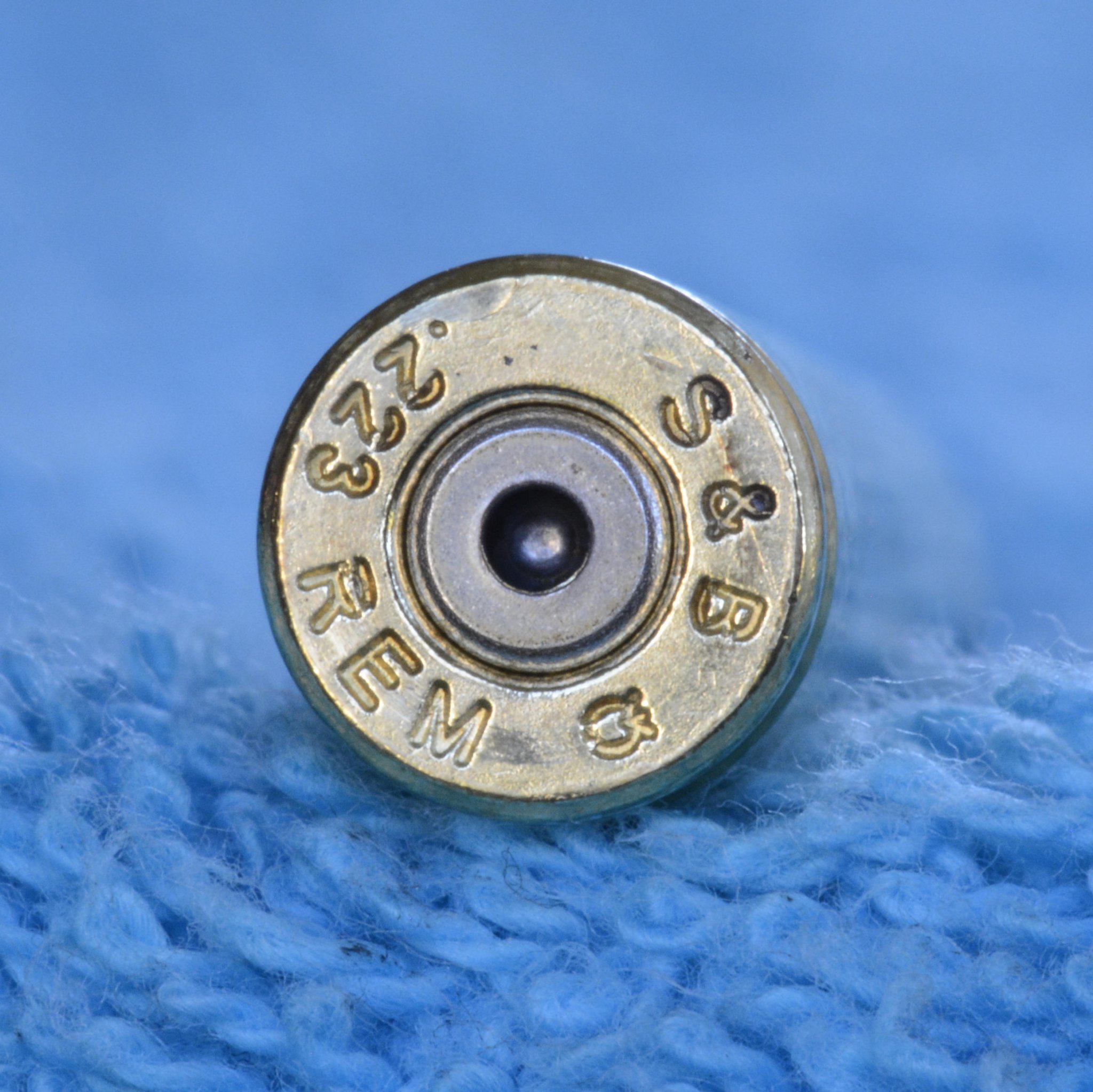

Photos: SandB01 and SandB02 - a casing from shots 1 thru 25. Note cratering on the primer.

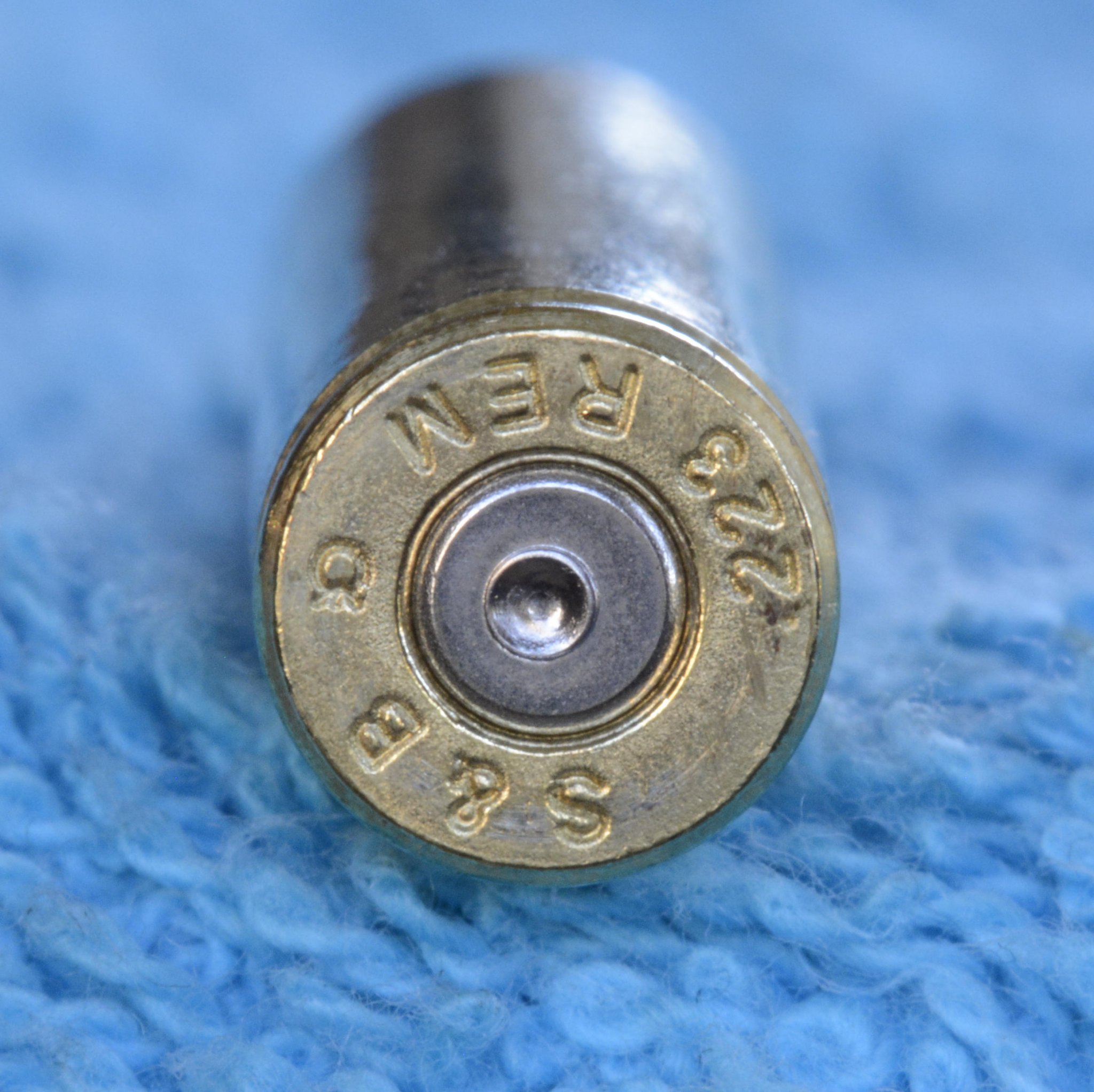

Photos: SandB26a and SandB26b - casing from shot #26. Deep hole in primer. #28 looks very similar.

  • It sounds to me like you definitely have some overpressure signs. You have a borescope... so there is no carbon ring in front of the chamber/before the leade?
  • While I don't use factory ammo anymore, I personally - this is just me so save the flaming - would never use Sellier & Bellot before I started handloading .223. I won't even use their brass. Why? Because the majority of even once-fired S&B 9mm brass I tried to load was inconsistent and swollen at the web to the point it wouldn't pass gauge testing. I learned to just pitch it in the recycle bin.
  • I don't think you need to have a smith check your rifle, but if you have one close by & convenient, it surely wouldn't hurt. It's never been clear to me why my Tikka Varmint exhibited pressure signs with even the mildest loads when using thin, soft CCI 400 primers while other .223-chambered rifles seemed to run them just fine.

So, questions #1 and #2 have been answered. I called my gunsmith and explained the situation. Their work backlog extends to about 2 months, but because I'm something of a "regular" there, the guy said to bring in the rifle and he'd take a look at it while I waited. The rifle checks out good, so I'm still in business. No more Sellier and Bellot for me, tho...
