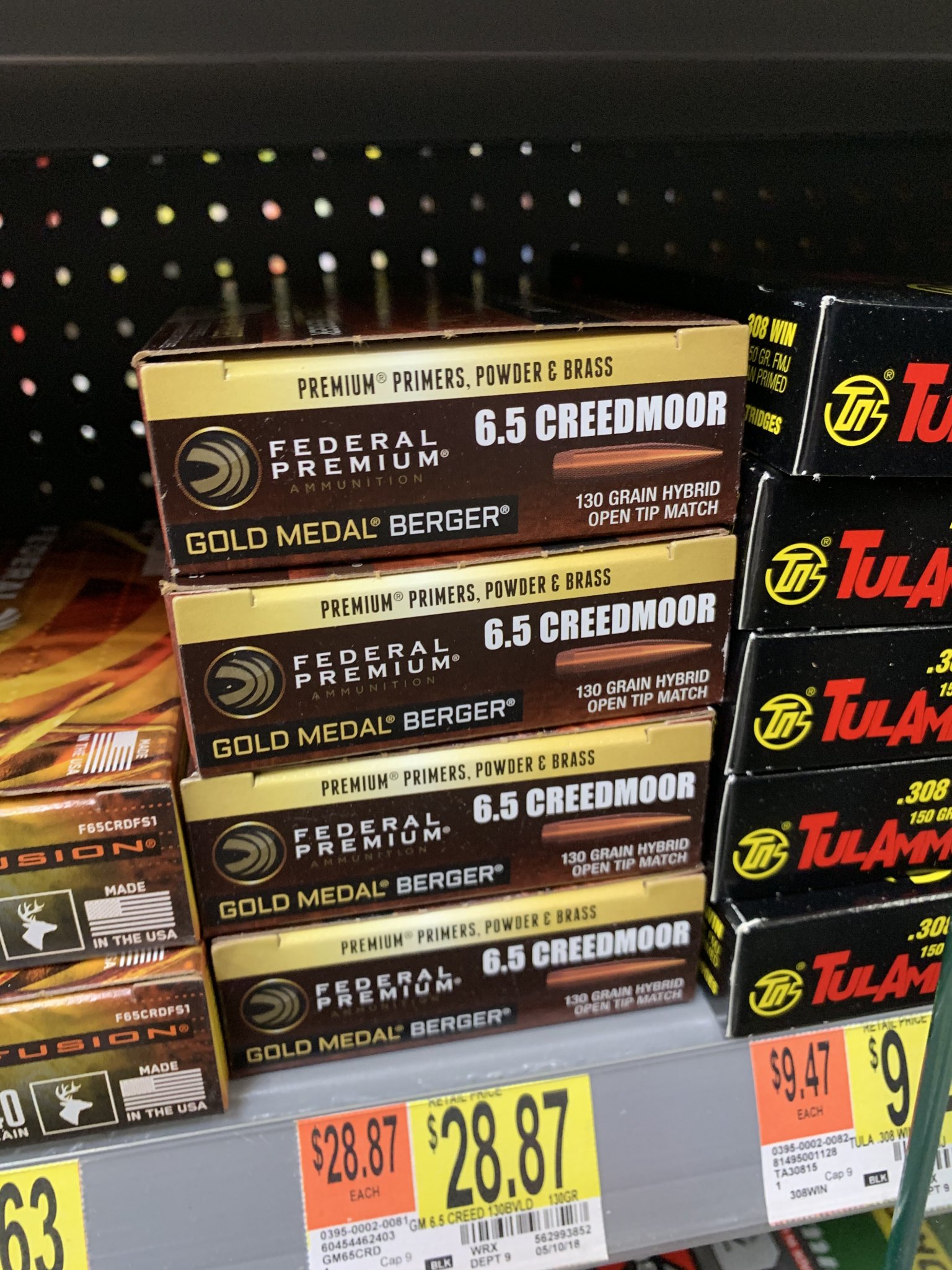

Saw this at Walmart yesterday. May but be a new thing but looks like a good thing.
