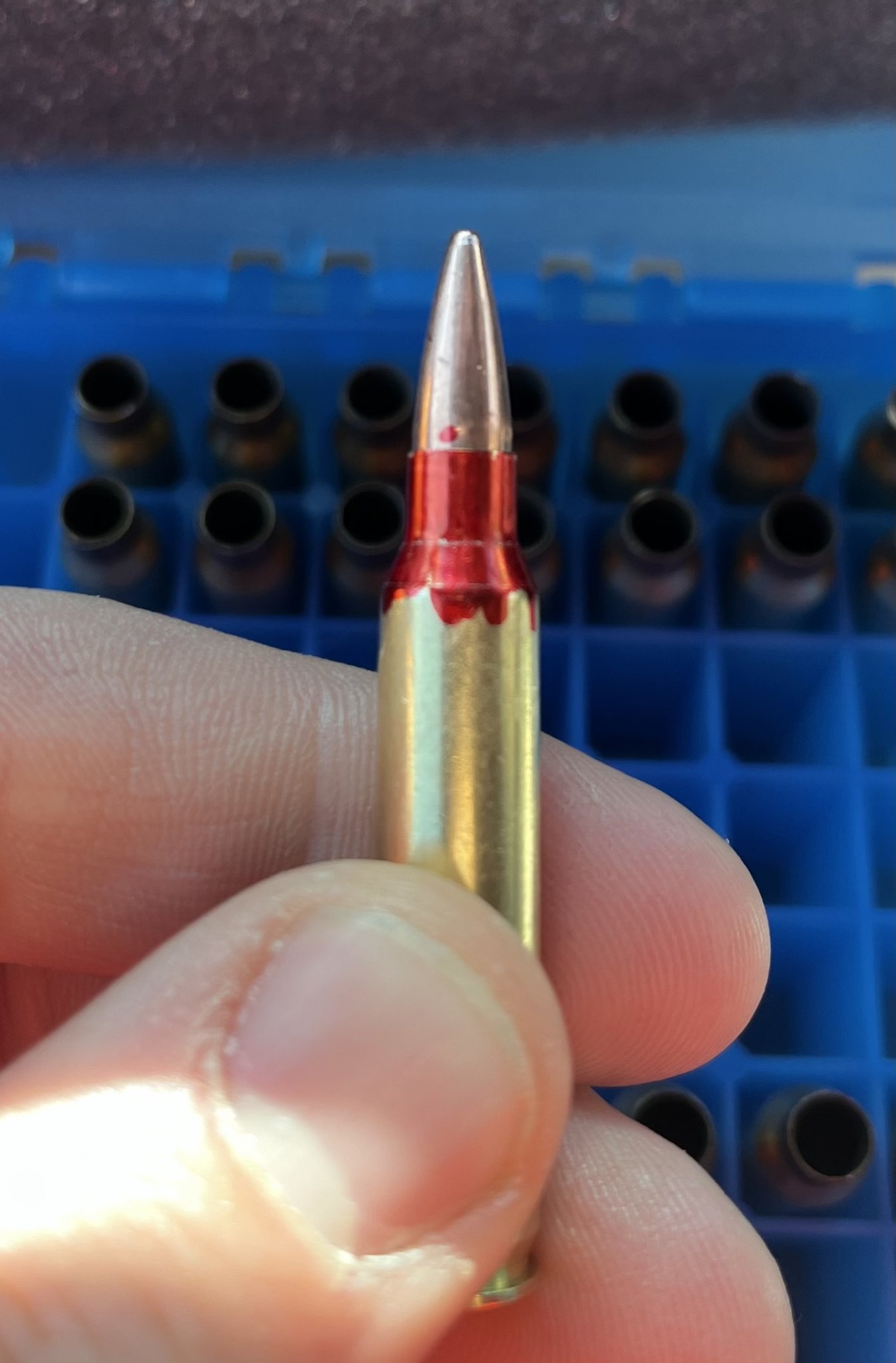

Cover a piece of factory ammo with magic marker, try to chamber it. The marker will run off on the place where it is tight.
Magic-marker the bullet try to chamber. If the COL is too long, the marker on the bullet will be rubbed off.

Magic marker the entire cartridge. Try to chamber. It will show you the tight spot or spots.

Im getting a ring around the neck/shoulder junction and a ring around the shoulder/body junction.

Zermatt inspected the barrel and said it was chambered to absolute minimum headspace. Ray said the bolt would barely close on a go gauge. He also said the extractor is ever so slightly rubbing on the breech face when the bolt is closed.
So my question now is….. I tend to enjoy shooting factory ammo (I have a newborn and time/space is extremely limited). Does anyone know any good 223 factory ammo that’s going to be ok with a minimum spec chamber? The hornady 223 match 75gr bthp is too borderline (only about half the rounds will chamber).
Thanks in advance
Did the gunsmith or whoever inspected your rig mention any remedies?
With the right reamer, getting your chamber corrected to allow factory ammo is not difficult for a qualified gunsmith.
In a way, the smith who cut that chamber in the first place should be the one to help you out.
If this is marginal, he may be able to clean it up without a fuss.
Reactions: Marine52 and Tperry
Your GS needs to fix this on his dime. Or do what I would do and rent a reamer and give it a turn or two and set the HS to what I want. I used to do this with short chambered barrels all the time years ago. Just get a reamer with no throat so that is not changed.
