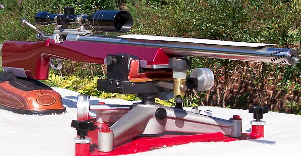

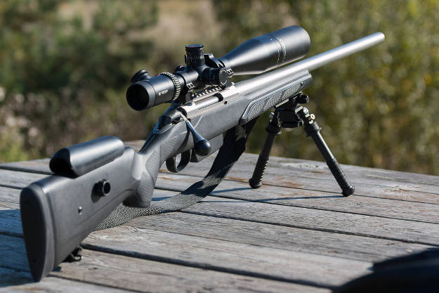

Hey trx680, are you asking about a benchrest rifle or a rifle to shoot from a bench?
Sounds like folks are steering you towards this:
I'm thinking you're wanting this:
Which is it?

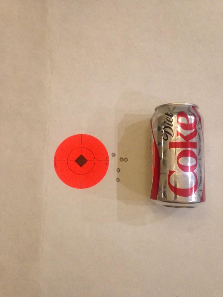

Everyone has a savage who shoots .2 and is dead nuts reliable on the internet. In the real world, they fail when run even moderately or in less than ideal conditions. It's nothing new and nothing has changed in decades. Run a course or two and see first hand.
Never said it was dead nuts reliable. And why on gods green earth would a guy run a course or two with a bench rifle?!
Witnessed by 52 guys. Beat 49 of them. 1.39" at 420yrds in a match. Not at home in cherry picked conditions. At least 3 members here were there also. I can get some more if you'd like.

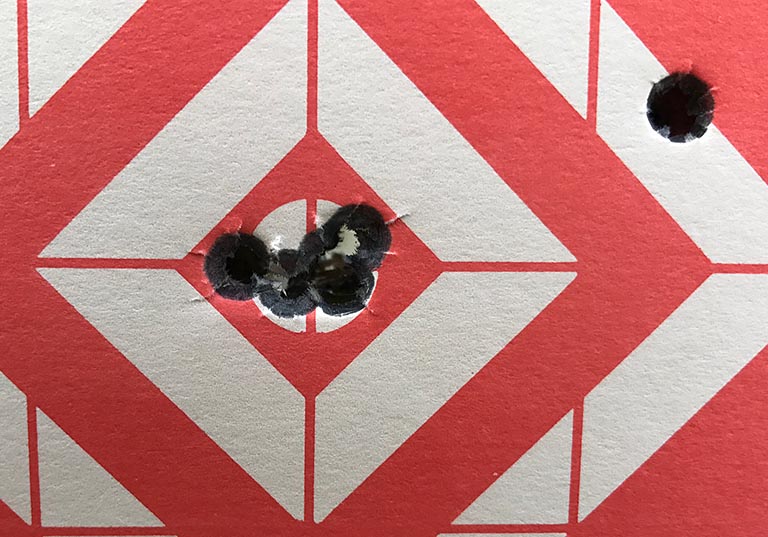

Well it shoots like this with with over 2k rounds through the barrel. That was after I threw a PST on it and zero'd it at 100 yards for a buddy to shoot with me. Upper right shot is the first one, the other five are after the correction. Not as smooth as my custom, but I shot matches for over a year with it without any problem. Shoots just fine, I'll be shooting my "garbage" rifle instead of my custom at the f class match tomorrow. :p
